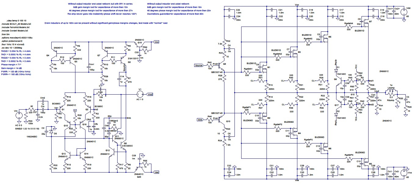

Hi everyone,
I've made a few changes in my design to improve stability, but I'm concerned about two things, the phase shift cause by the input decoupling capacitors (inverting and noniverting inputs) are causing a phase shift of almost 180º at low frequencies (< 20 Hz) this can cause motorboating or similar humming oscillations?
The other thing that concerns me is a thermal stability problem that I have, because VAS current changes between 10.8 and 7.8 mA (0 to 100ºC), what can I do to have less variation, this variation could lead to problems?
It was told me that I should thermally compensate the drivers but I don't know how to do that because it's package is TO-92, any suggestions?

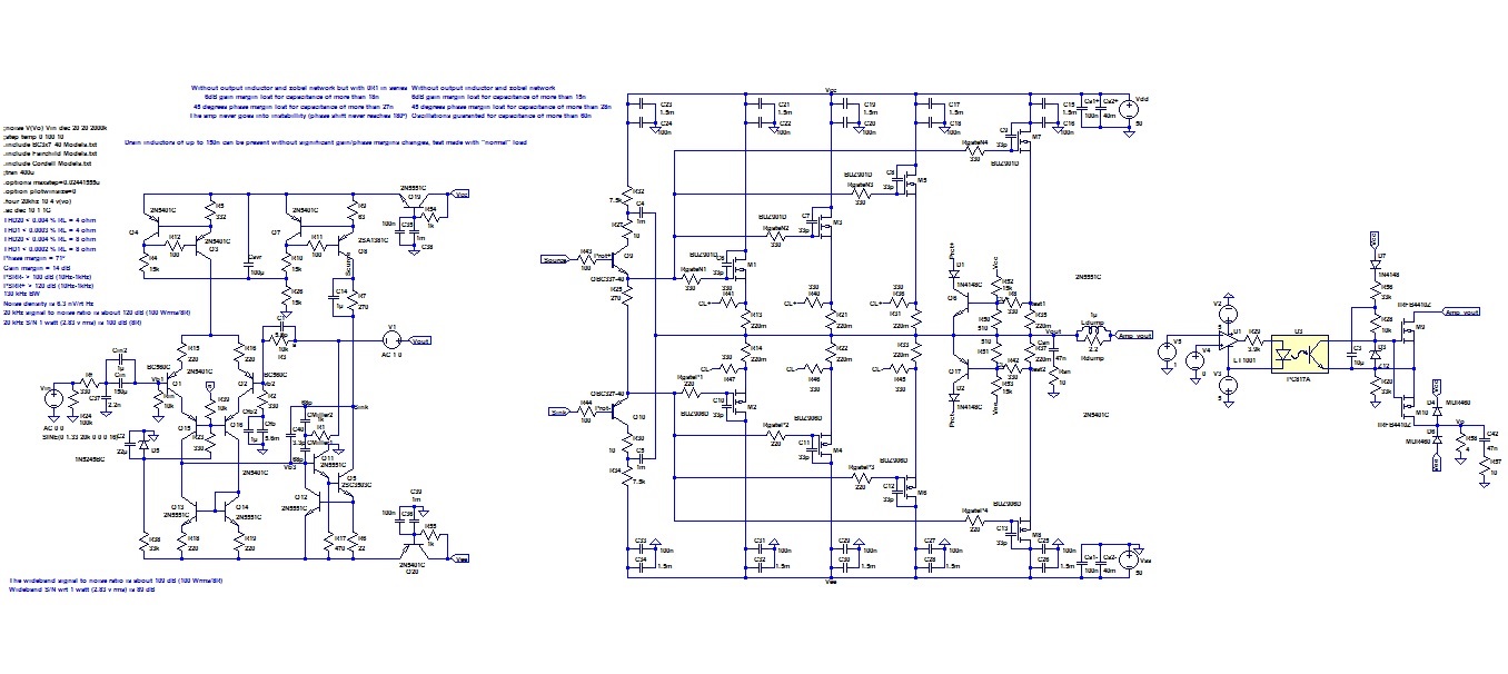

Hi Daniel ,
Apologies for the delay in responding; I’ve been on holiday.
The C1R5 network is indeed an attempt to utilise the increased power dissipation afforded by a pulsed signal. Quite what this offers is difficult to determine for this device since no pulse response curves are shown. The time constant of 33ms was just a ball park figure, but is not too unrepresentative, given that Bob Cordell suggests a TC of 50ms as a figure for “illustrative purposes”. It can, of course, be removed entirely without any impact on the VI limiter values given. Note that it is not intended to alleviate any oscillation problems that might arise due to the switching of the protection transistor.
With a value of 10k for R5, it’s possible for a reasonably sized non-electrolytic to be used for C1.
Perhaps a higher gain device than 2N5551 if “base starvation” is an issue?
You have the spreadsheet. Try modifying it to suit your device parameters, then see how reactive loads fit.
Brian.
Brian.

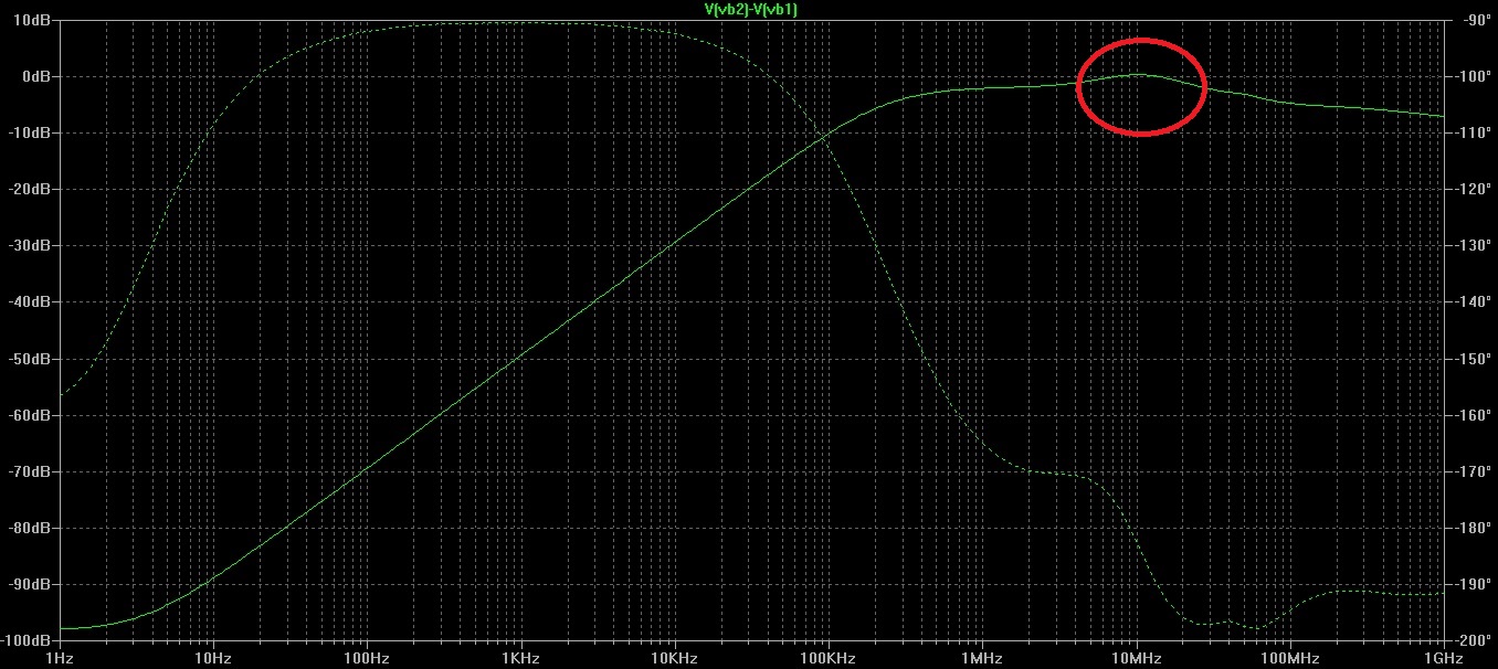

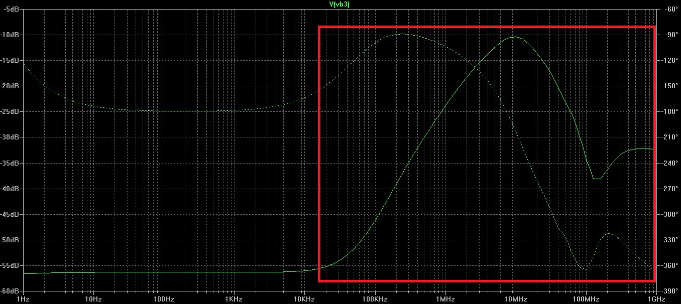

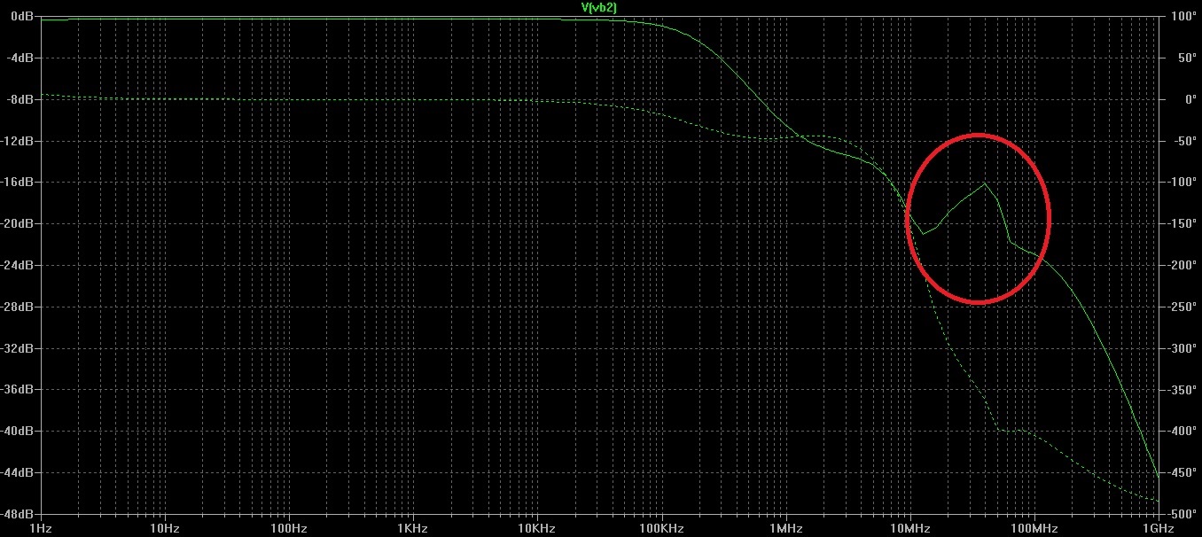

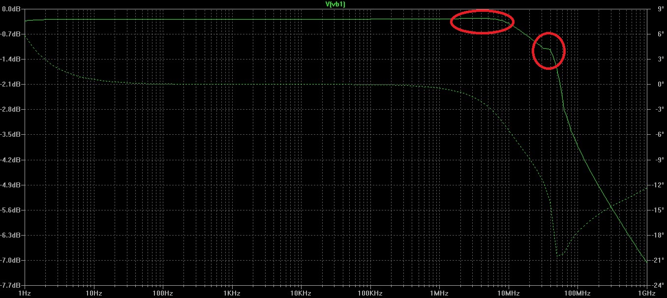

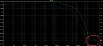

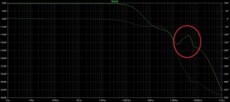

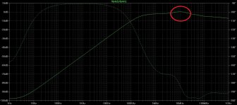

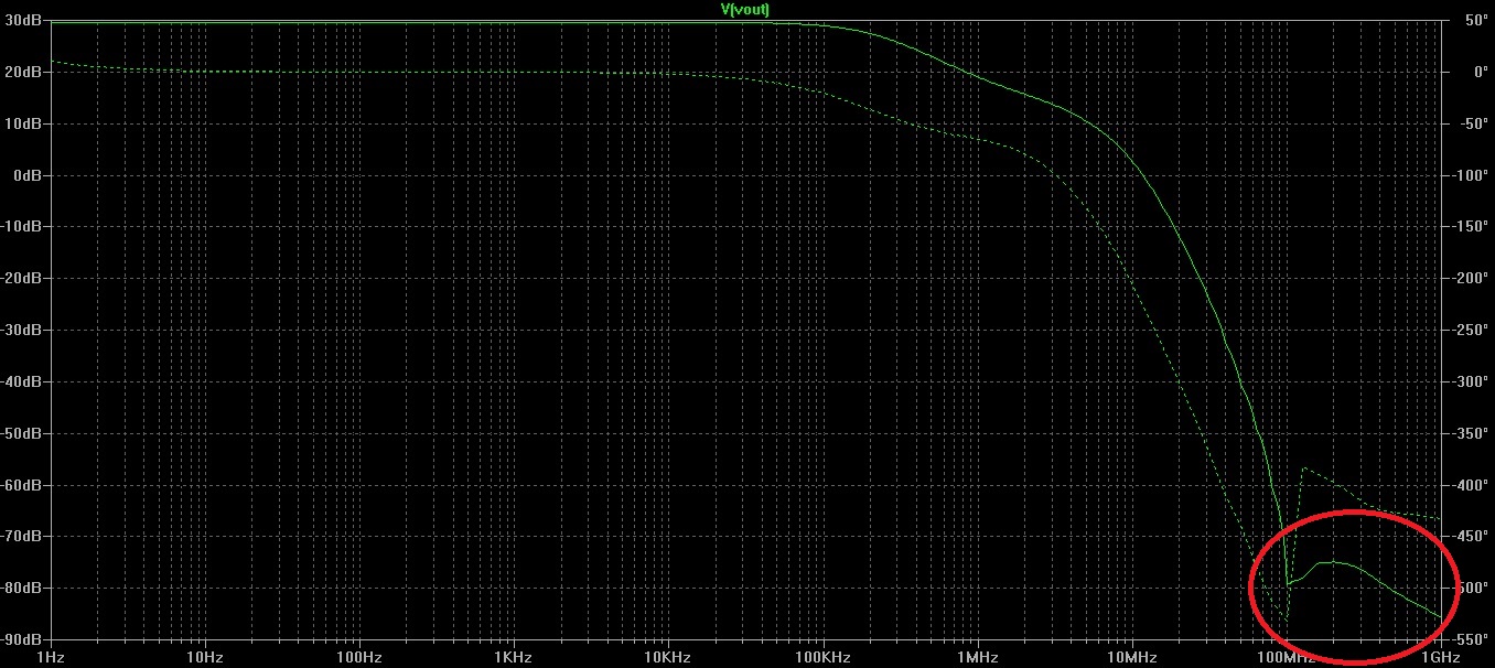

Hi everyone,
I can't begin the PCB design right now because I still have some problems and doubts,
The main problem is that it seems that I've instabilities in internal nodes, I've added a few pictures about the strange responses of those nodes, even at the output there's a peaking starting at about 200 MHz.
The other problems are related to the current sources that are varying too much with temperature and the fact that I don't have thermal compensation for the drivers.
I don't know how to simulate an NTC thermistor in LTSpice and I want to simulate the thermal shutdown circuit, now that I've the output solid state relay, I also want to add a poping prevention delay network to connect also to the output relay, how I can connect all those things to the output relay with an OR logic gate?
The solid state relay I'm using is based on Rod Elliot's designs ESP - MOSFET Solid State Relays
Do you have some ideas about the startup delay circuit?
I really need your help, I can't move on with this project and make the PCB without achieving stability in the simulations.
I also need help with the stability problems, it's very important it's making me mad, because the amp has good gain/ phase margins but seems to have strange behaviours in the internal nodes. Why?
Please someone help me here!!
Thank you very much for your attention,
Best regards,
Daniel
Hi everyone,
