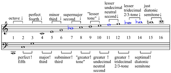

I want to put this out there: The fundamental pitch (the low C) through to the 4th partial contain only octaves, perfect 4ths and 5ths. In musical composition, movement(s) of octaves, fourth and fifths are *always* avoided because they stick out like a sore thumb. I am going to separate this sentence from the paragraph to highlight it:
When writing for 4 parts (SATB, or, soprano, alto, tenor and bass) movements of an octave or fifth (in parallel) are *always* avoided because one of the voices drops out. It "appears to disappear".
Listen to the first audio example on this page, then listen carefully to the second. The first example is an octave. Can you hear how "thin" that interval sounds? The second example is a major seventh. Can we hear how much more warm, interesting and complex the seventh is (ex 2). Now move on to example three. Listen carefully to how complex each interval is as we descend through each of them (sorry about the awful synthesizer vibrato).
Perfect Intervals
Now, let me get to my point: the reason I have gone to these lengths to describe musical pitches and their overtones is to ask a question about the limitations of our science. If we separate the midrange and bass driver via a crossover in (I would say) the most important register, are we making things more difficult for ourselves? Look at the overtone series again! We have put the crossover point (from the bass driver to the midrange)-beginning somewhere around- the 4th through 16th partials where all of the "warm stuff" is! *BUT* it's also where all of the nasty complex stuff is too. Middle C is 262 hz (the 4th partial of the overtone series), right at the spot where we would begin to roll off a bass driver and roll on a midrange. This becomes very complicated, right at the spot where we really need to simplify things.

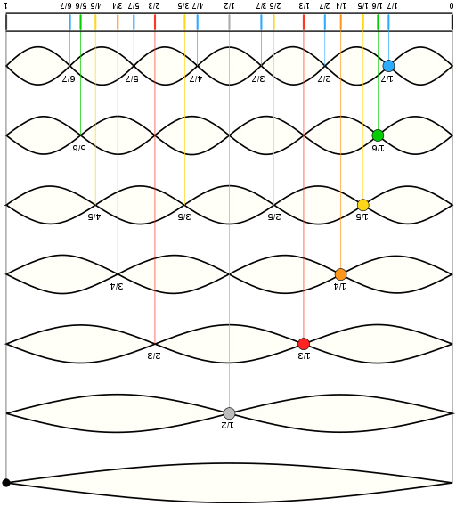

By the way, I didn't want to confuse things but the image of the overtone series is numbered incorrectly. The fundamental (the number 1) is not a partial. in other words, the number 1 is actually on the second pitch from the left That is the first partial or "overtone".
I am going to repost the overtone series in pitches and the series as waves upside down (so we can connect them visually).
All of the "good stuff" is in the shorter wave lengths... fourth from the bottom and up. (C E G B flat)
This is what the chord sounds like -numbers 4 to 7 on the overtone series example I have here... and yes, that is right in the octave we're talking about. https://www.youtube.com/watch?v=FxaEwoEhs_Y
