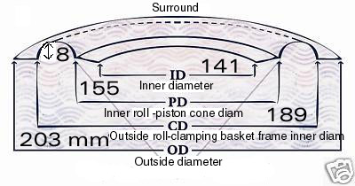

Chellspecker,
First make sure to measure your old surrounds and then
you will look for a replacement of similar values. Just for
illustration.
