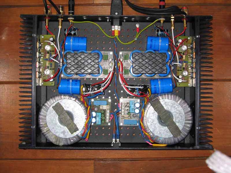

In my new amp I have connected the safety earth directly to signal ground at the RCA inputs. Although there is no hum whatsoever, I can still here a difference in sound.
With the connection in place single instruments seem to have a 'aura' around them. At first it sounds like ambient detail, but when the connection is removed, everything sounds more pure and more quiet.
I don't worry much over safety ground, but it's always nice to have it. Further, I can't really decide what sounds best. My speaker do not have enough resolution to know if the aura is part of the signal or some sort of distortion. However, I feel that no connection between safety and signal ground must be better for sound. I can't see any benefits from this other than meeting safety regulations.
Does anyone have similar experiences?

Keep chassis earth (mains safety earth) and power supply + signal earth seperated via a loop breaker, as Rod Elliot shows on his websites - basically this means connecting the two togethr via 2 inverse parallel diodes, a 10R 5W, and a 100nF capacitor (all in parallel)
OK, I've listened some more and now its clear. The sound is better when there is no connection between earth and signal ground.

OK,
I just tried a loop breaker (after RODE's recipe) with on one side both signal ground (L/R) and on the other side chassis and safety ground.
It made quite some improvement. I still prefer the sound without the safety ground attached. Although the breaker takes away 90% of the problem.
I guess that's the solution then: no loop and hence no loop-breaker. If you don't hear from me again, assume I electrocuted myself for the good of superior audio;)

You're best off without earth ground but with the chassis firmly attached to the circuit ground. Usually bolting the rca connectors straight onto the chassis works best for this purpose. The only disadvantage is that the floating circuit ground is now externalised as the chassis ground.
The ideal concept for combining a floating circuit ground and an earth ground is by putting all the circuitry inside a sub-chassis (ie to provide something similar to the above situation) and mounting that -fully insulated- inside the actual equipment box. The latter can then be connected to earth ground.
