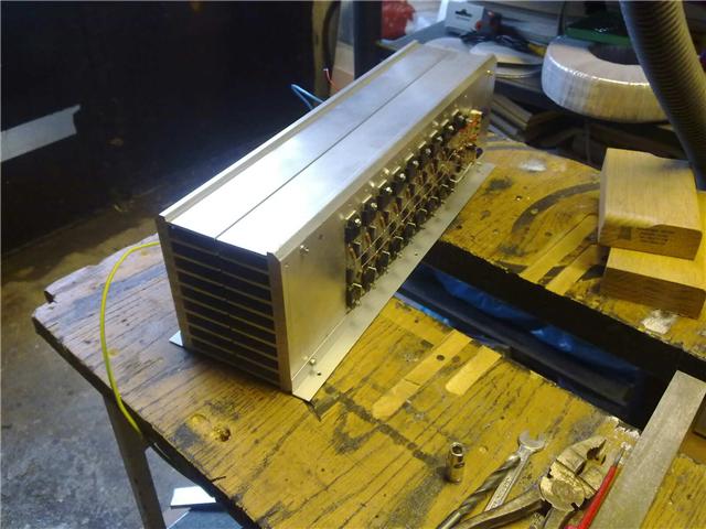

I want to use it for 2 different application:
- home system to drive my 8ohms Focal loudspeaker, mainly in class A, up to 100W.
- to drive the front, and subwoofer in a party (my subwoofer contains 2x18" Beyma loudspeakers, and can handle 1800W rms)
I know that this heatsink is not enough. This is for test only. I'm not sure the final solution. I have two possibilities:
1, 40cm long heatsink for each module
2, keep this heatsink, and use forced cooling with variable speed fan
Sajti

I want to build 900W/2ohms bridged amplifier, which will use 8 pairs of MJL21193/94, in each amplifier module, with +/-37V PSU.
My only problem, how to drive this amount of output devices? There are 3 options:
1, Drive with same type of transistor. One more pair MJLs with 150-200mA bias, or
2, Parallel connected MJE15032/33, with 70-80mA bias in each pair. Two or three parallel, with base stopper, and small series emitter resistors, or
3, Separate the output devices to 4-4pairs, and drive them with separated driver (MJEs) I don't know which would be better. sajti
