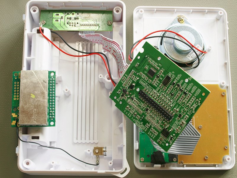

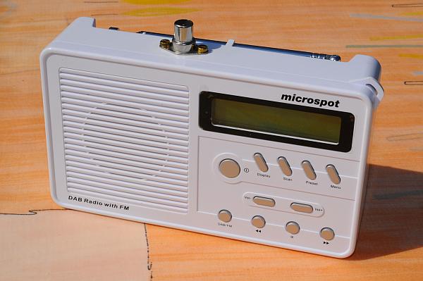

another possibility it could be, to buy a cheap radio for tweaking like the DAB+ radio Microspot RA318 (RA-318) resp. King Champion "DB-32F" (DB32F) like by the showed pictures.

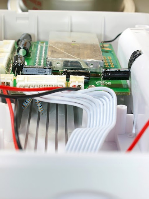

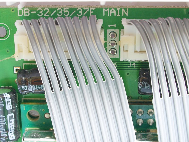

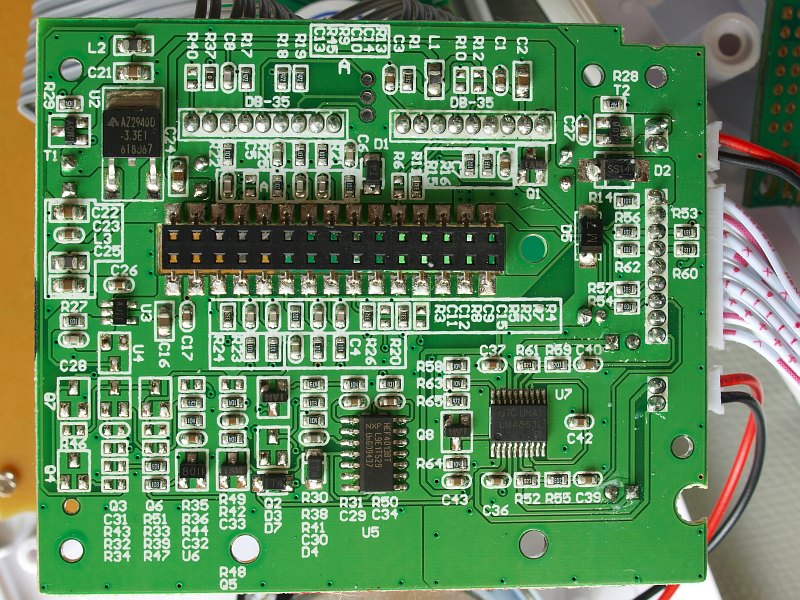

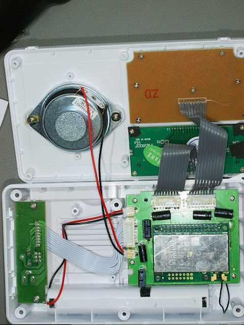

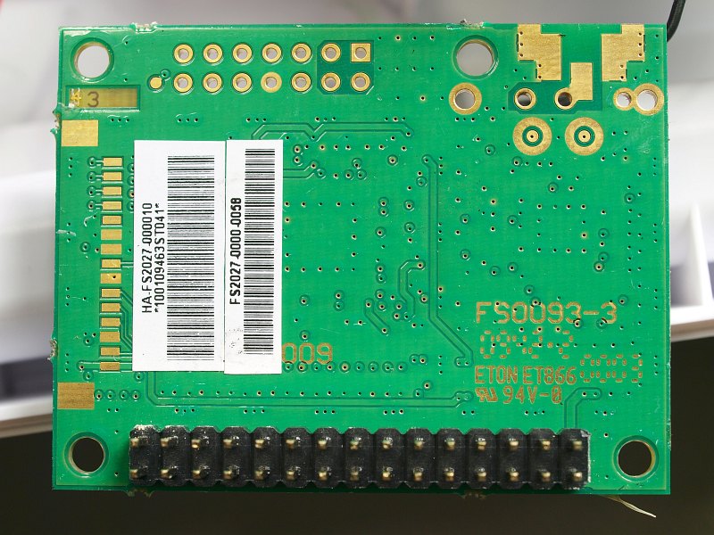

I bought a Philips AE5252 which is built around the Verona module from Frontier Silicon.
The next step is to understand how the module is interfaced to the LCD and buttons. Also I need to figure out the pins of the module.
The Verona has an Atmel processor so recoding is a known procedure. The Verona has at least spdif out and R/L audio.
So far I have connected the radio thru the headphone connector to the stereo and atleast in Sweden SQ is quite good. I managed to find 7 stations sending digital.
Anyone interested to help dissecting the Verona modules secrets? I have emailed Frontier Silicon but haven't recieved anything yet and ain't sure I ever will

The Verona didn't have an Atmel processor, the atmel part is a serial memory module . The processor is a proprietary Kino3 IC from Frontier Silicon. No info available for that part...
So far I have figured out the buttonworks on Verona pin 25/26, the audio out on 3/5 and the LCD SPI part on pins 7/10/13/16. There are also a number of NC pins namely 8/9/12/15/17/21/23/24, GND on 4/6/14/22. Powerpins are 1=1.2V and 2=3.3V. Maybe pin 18 should be considered a power pin since it is taken down to 2.6V by an R-net and the buttonpins shows 2.4V - coinsidence? Maybe. I still have to follow traces on the Verona module to see if there are any clues. Left are a few pins I have to think about - I have no clue yet of their workings.
There is another thread in parts about the LCD - I believe I have found if not the specific part but almost certain the pin functions of the LCD.
The DAC part of the Verona is built on a CS4344 24/192 capable chip. The datasheet is available on the net so interfacing to a better chip is easy.
And there we go - soon we can DIY our own DAB+/FM/RDS capable radio tuners

Buttonworks...
The functions of the buttons are activated thru grounding pin 25 or 26 thru the following resistors:
Pin 25:
Menu/Scan 33R
Down 1k2
Up 5k6
Sel/Info 18k
5+ 33k
Vol+ 68k
Pin 26:
DAB/FM 33R
5/10 1k2
4/9 5k6
3/8 10k
2/7 18k
1/6 33k
Vol- 68k
I don't know what happens if we use other values. The Verona might enter some mode we get trapped in and it can (probably) be put in the bin.
So 4 pins left to examinate and Frontier Silicon is still silent.

Just pins 18, 19 and 20 to be explained in the scope of AE5252. 18 might be an power in pin of 2,6v - nothing shows of another function so I'll go with that. The scope showed 0v on pin 19/20 but they are connected to circuit on the PCB. Maybe they have other values at startup as mute functions until a channel has been found and decoded. I will check but not for a while...
