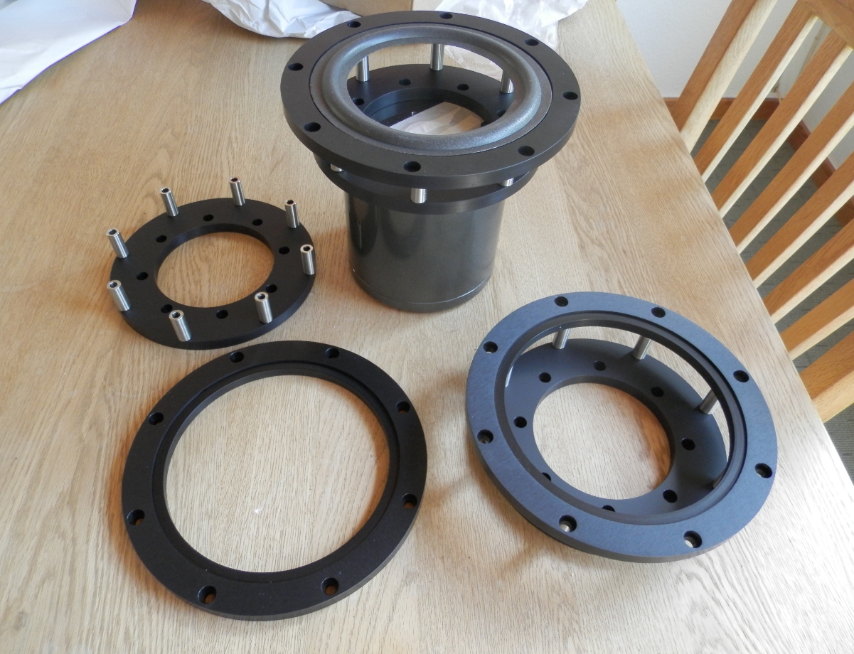

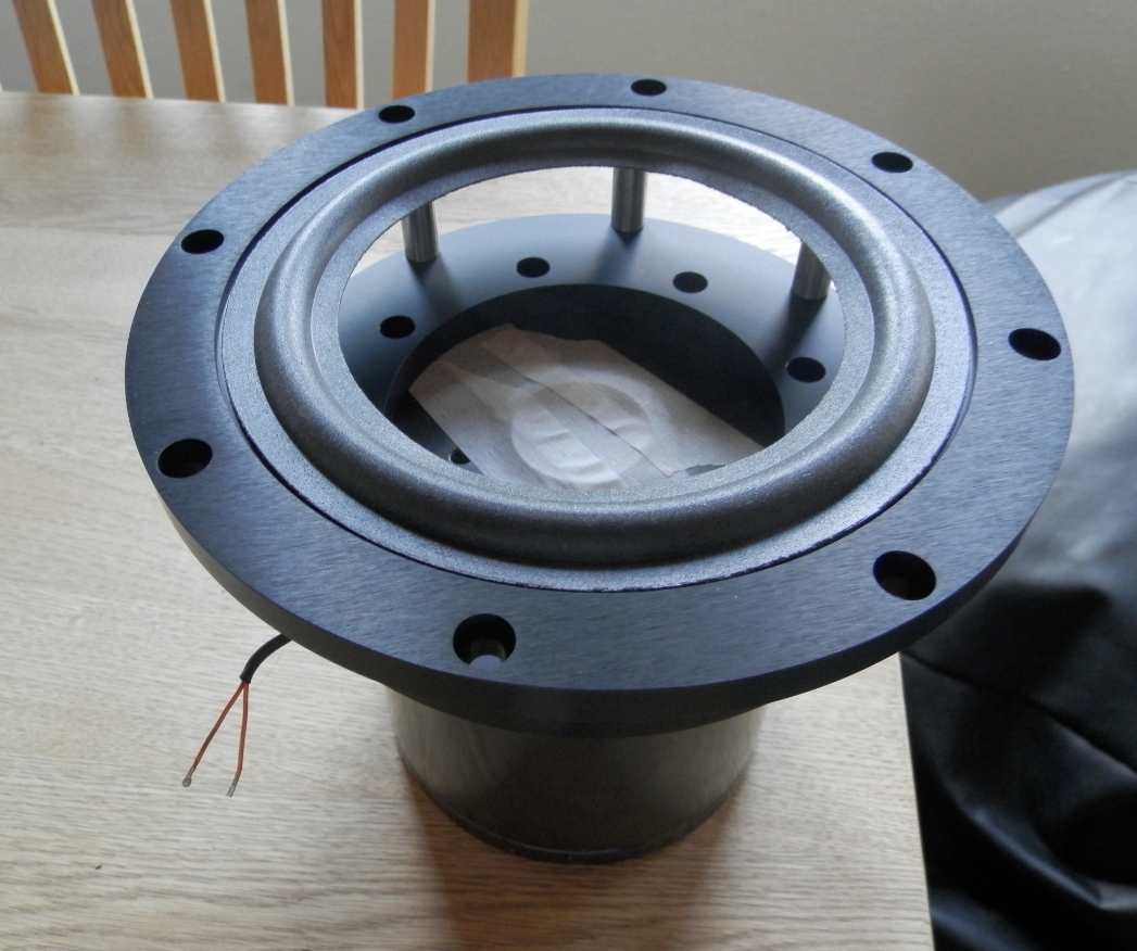

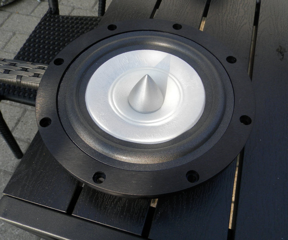

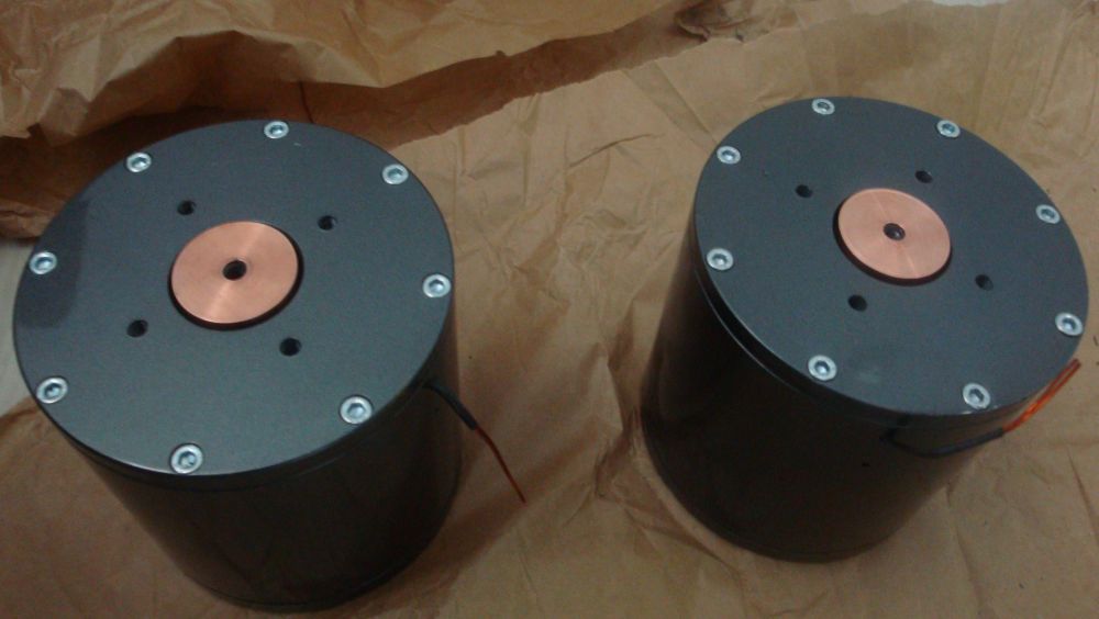

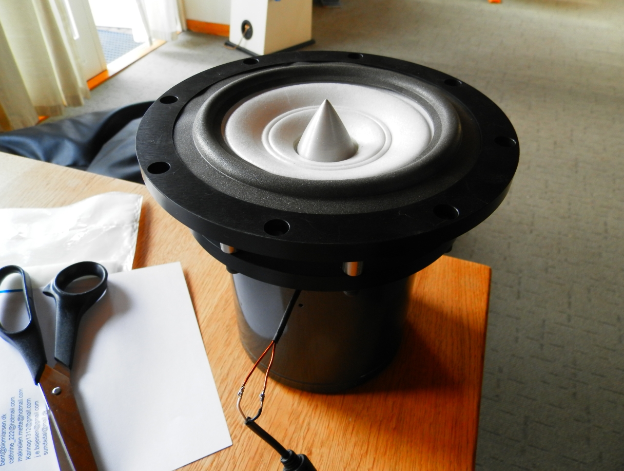

Hello
I started for almost a year ago on a full range project and I got hooked.... you relay can make a super full range unit, but it has a high cost when you want to make the best of the best. I am using some clouded cellular foam as cone it is very light weight, a 6” cone weighed 1.5 gram. Also I am using a field coil as a magnet and a custom made speaker basket. I think I will have them finished primo 2014.
Here is some pictures.
Take care.
Take care.

Might sound silly but do you have a recording? I know the ryu had some. Also finished is a funny word when your trying to make the best.
Hi, No I do not have any recordings of the unit, it wouldn’t bee fair to make a video with sound course it wouldn't show how they sound. (not with my camera anyway).
You nailed it quit well “finished “ is a funny word. I have been throw so many changes, but at some point you have to decide... and I think it it now. So I have order some CNC aluminium’s formers to hot press the Depron sheets, this will insure a uniform production (2psc for now). But If I come across new knowledges the units might bee modified.
Take care
