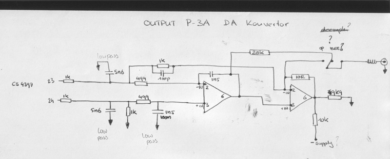

yesterday I tried to draw the output schematics of my P-3A cause I wanted to know a bit better what I was modifying and would like to have a balanced output.
Attached is the drawing of one channel of the output stage.
The first part is clear to me being a two pole low pass filter turning the balanced output of the DAC into a single ended signal.
I´ve got a few problems with the second opamp. This seems to be inside the feedback loop of the first and is biased into class-a via a 10k resistor to the negative power supply.
Also the 20k resistor to the output relais (when muted) is not clear to me.
Can someone shed a bit more light on this circuit?
