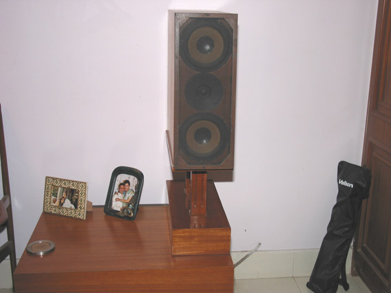

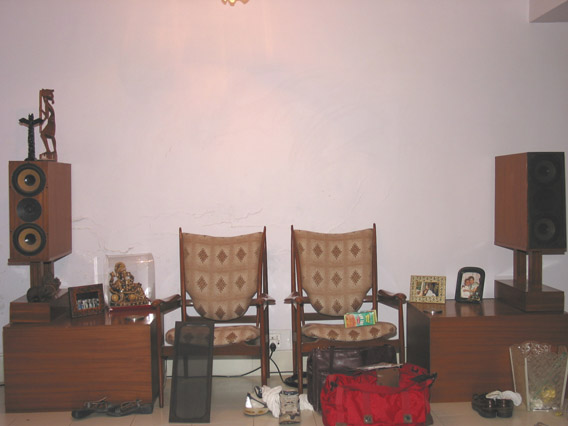

do you get moulding strips in your part of the world. here in India we get ready made moulding strips (half round, quarter round, all sorts of shapes). by the foot.
U cna use these strips to make a grill frame and then wrap some nice acoustically transparent cloth around it. I use a staple gun to do this.
hope the photo helps
regards
navin
