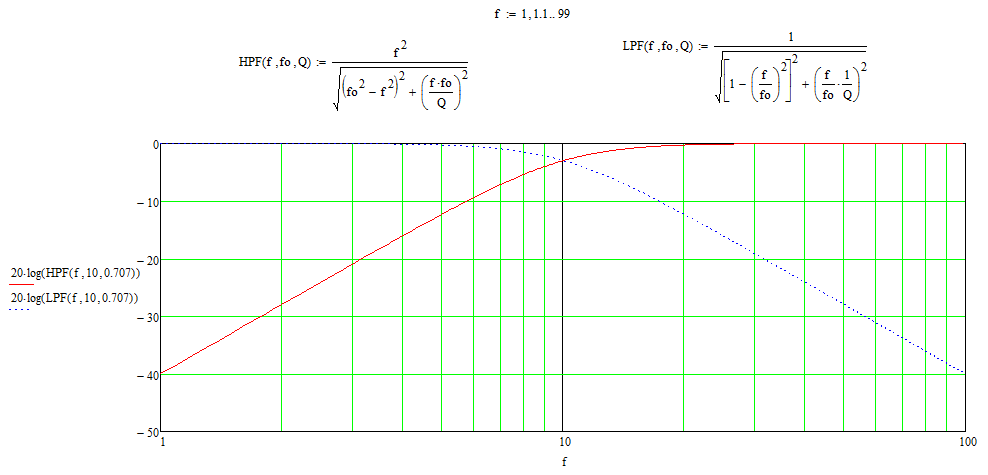

Hi there,
Maybe this is stupid question but I have never been good in math.
I made xls spreadsheet where I can calculate SPL, excursion, impedance and power of driver in sealed boxes in function of frequency. I am struggled becouse I also would like to calculate transfer function of various filters in Excel and to plot its influence on SPL curves. Unfortunately I cannot find clear and easy to implement set of formulae to calculate it in function of frequency giving Q, f and n of the filters. Do you know good source of such formulae? Thanks!

This guy talks about doing complex number calculations in Excel:
Complex Numbers in Excel | EngineerExcel
If you don't want to go through all that, you could use these formulas (see enclosed picture).
Hi, this works nice, thanks! However it is still only 2nd order. Are there a formulae which involves filter order into calculations? For example when designing odd order Butterworth slopes?

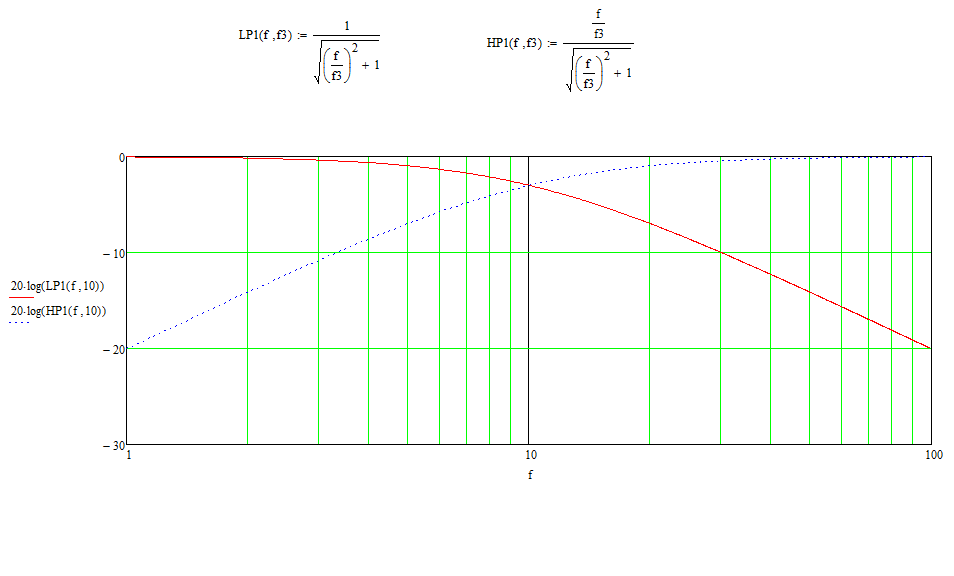

If you have the filters in factored form, that is, a cascade of 2nd order and first order sections, then you can just add the dB's provided by each section.
For a single order lowpass filter and highpass filter, we have as you see in the attached picture, where f3 is the 3 dB corner frequency. Of course, if you're looking for a general approach, Charlie's way may be the one for you.
