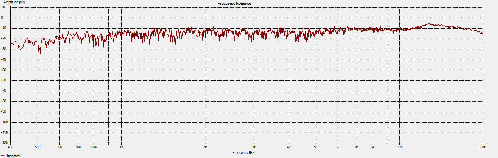

I used correctly the minimum impedance & frecuency of each driver datasheet?
Attached both datasheets & the tweeter measured in box without xo
  • ScanSpeak 18W-8545-00.pdf
  • Seas Millenium TCF002.pdf
If you only need to flatten the impedance on a tweeter after the resonance then you need a Zobel.
IMHO, if you learn to use a proper crossover software (Speaker Workshop or Passive Crossover Designer), you'll realize that Zobels aren't necessary.
A notch needed to eliminate a bump is quite impossible to do right without measurements.
Troels Gravesen uses LCR notches on woofers mainly to eliminate the bump in the midrange (500Hz-1Kz) due to the baffle step effect. I think it is explained on one of the recent designs (Seas Curv perhaps).
Ralf
If the tweeter has a strong impedance peak (no ferrofluid for example), and the slope of the crossover is not steep enough, then you have to. Not doing so the tweeter will exhibit a bump at resonance, and that bump will show up in the FR of the speaker, but this could be a sign of a bad design decision.
Ralf
