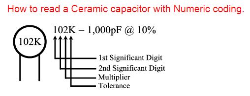

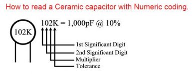

Ok now i see...This is the way most manufacturers list their capacitor sizes in their part numbers. It's the same as standard resistor bands work.
The first two digits are the size in pF. The third digit is the decade or multiplier band.
10 = 10pF. Add 8 zeros = 1000000000pF or 1000uF.
as 104=100nf/0.1uf
this 108uf confused me.
Thanks.

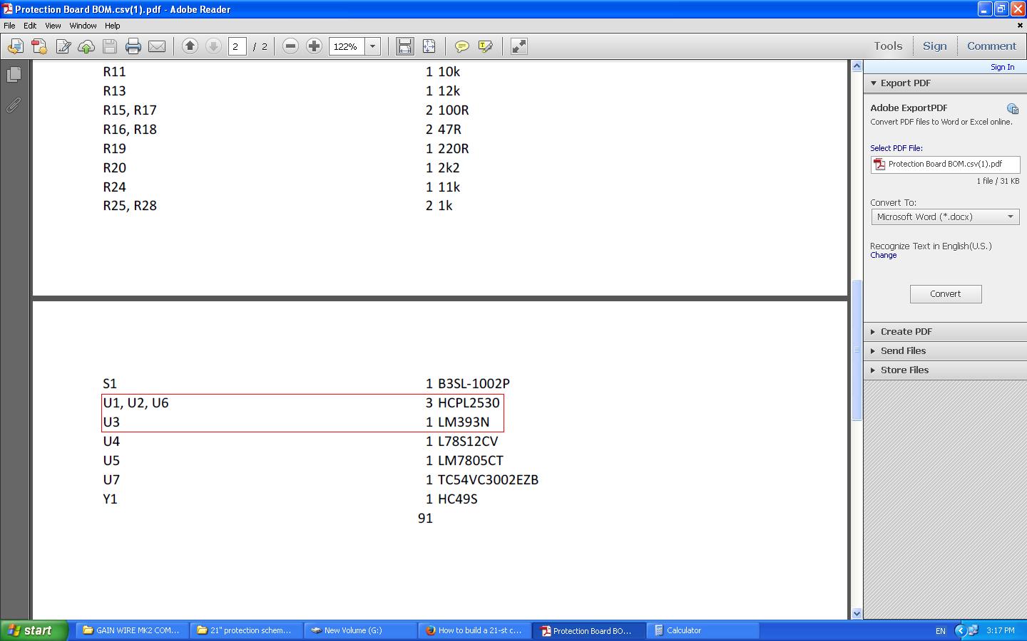

U1 is supposed to read ULN2003. I've got a couple bugs going on with Diptrace right now. Not saving random corrections is one of them.
When I mark caps like that I should be marking that as 108pF. Normally I would just mark that 108. I added the uF quickly before uploading the file.
Please confirm,U1=ULN2003,U2&U6=HCPL2530,U3=LM393U1 is supposed to read ULN2003. I've got a couple bugs going on with Diptrace right now. Not saving random corrections is one of them.
Valery, have you ever had problems with Diptrace merging nets together? I've had it happen a few times now and it's a huge pain to correct. In my latest DAC design it merged all my Digital and Analogue grounds together. Diptrace support told me to deselect "Connect Nets By Name" in the nets properties to correct it. I'm trying to figure out why they merged in the first place?
Ok ,mistake is mine.C1 is a decoupling cap for the Atmega328. It should be 100nF.
C3 and C4 are for the crystal. They should match whatever you selected for a crystal.
Sorry Jeff The resistor network 4k7 is bussed or isolated type?
Bused.

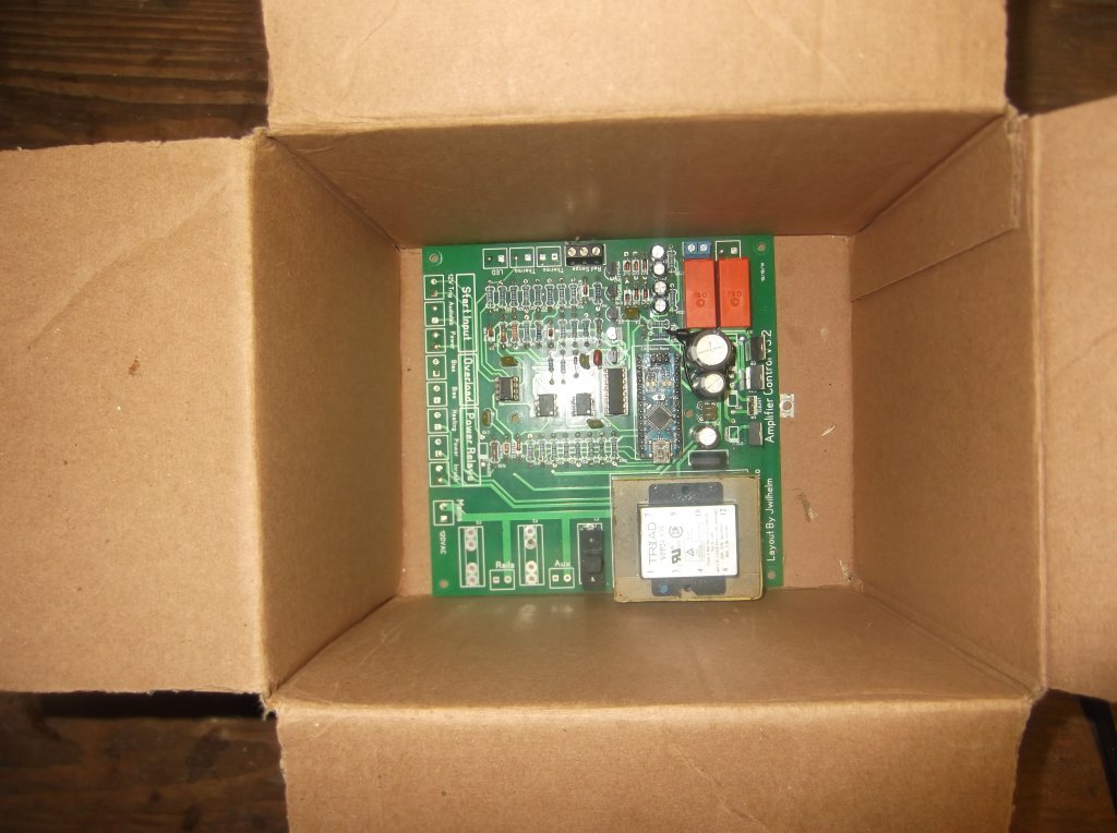

Pcb arrived today!
10 pieces+1 bonus.
Thanks Jeff.
Is there a bom somewhere?
Is it possible to buy a PCB from you?
I haven't any PayPal αccount.Is it possible to buy a PCB from you?
Please PM me with your email address.Maybe we can find a solution.
