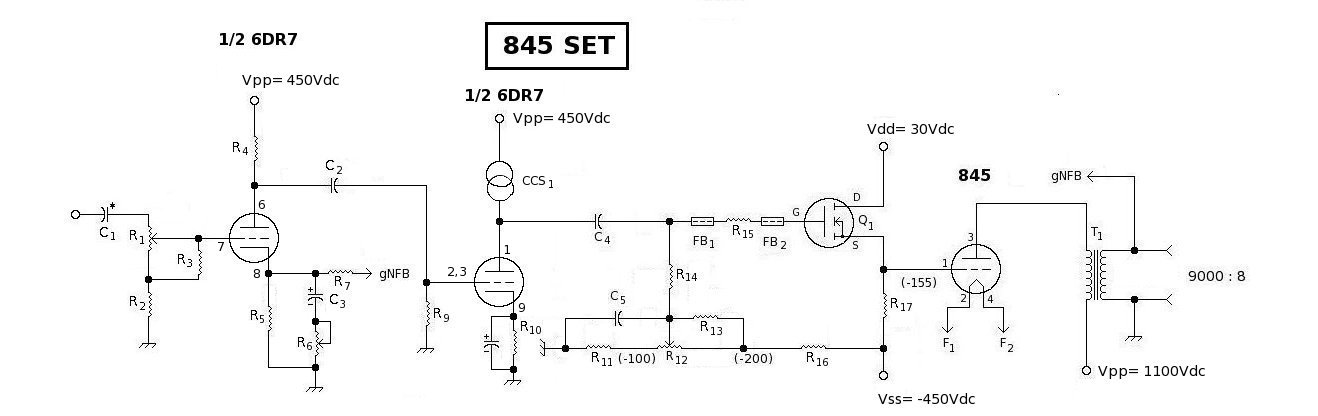

This is a common problem with power triodes of all sorts. The disappointing sonics of 300Bs seems to trace back to inadequate grid drive. I have a 845 SET project in the works (attached). The headroom/output swing problem is solved with active plate loading on a vertical deflection type that can stand up to higher voltages.
The small signal section is quite linear with a 100K plate load, and there is ample DC available to make this possible.
For grid drive, you just can not beat the power MOSFET source follower. The MOSFET has a higher Gm, and much lower rds(on) than any hollow state solution. It also doesn't mess up the open loop phase characteristic, making the application of gNFB possible.

Going with higher Vpp and lower Ipq here. Already have the 9000R : 8R OPT.

This is a common problem with power triodes of all sorts. The disappointing sonics of 300Bs seems to trace back to inadequate grid drive. I have a 845 SET project in the works.
Would you like to start a thread on this?
