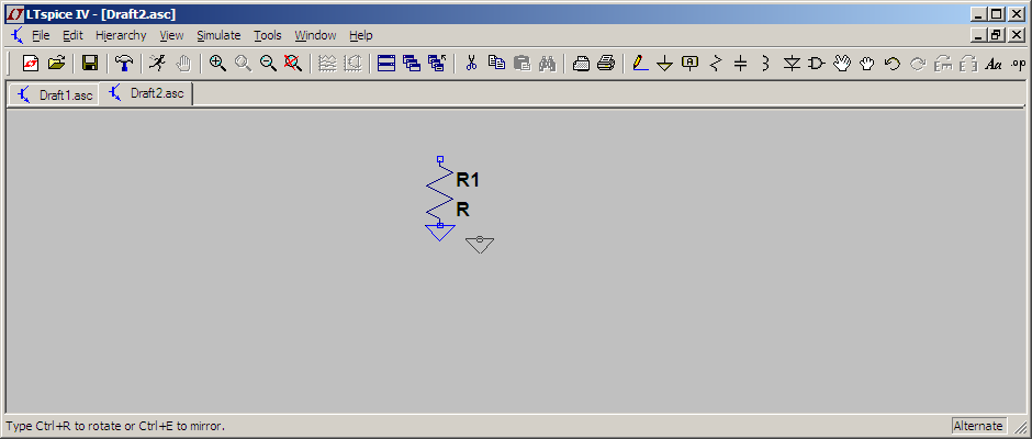

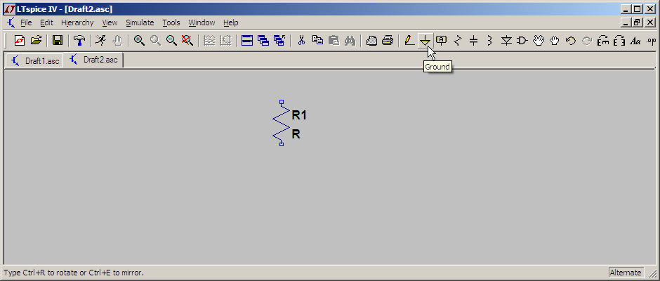

Hi robydream, Then you need the ground symbol! You said in the first post that you knew that the ground symbol was 0V and that you wanted an earth symbol instead.
Attached are pictures of the ground symbol. If that doesn't help either then iether you are missing something, or I am!
Tony.
Tony.
