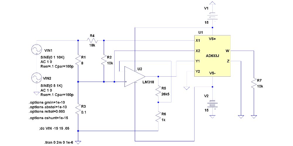

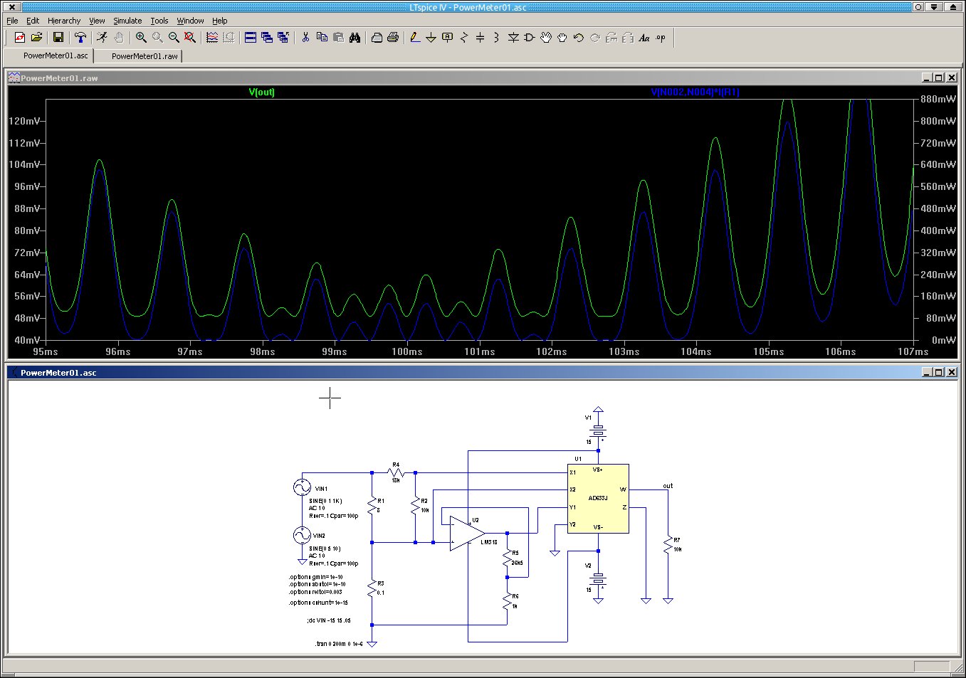

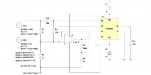

I have found this little circuit that works well, but the effect of the current sensing resistor on sound is an unknown. A Hall sensor sounds like a good idea. Thanks for putting me onto that idea.
The circuit tracks the output power in real time. For a meter some sort of damping effect on the output might be beneficial.

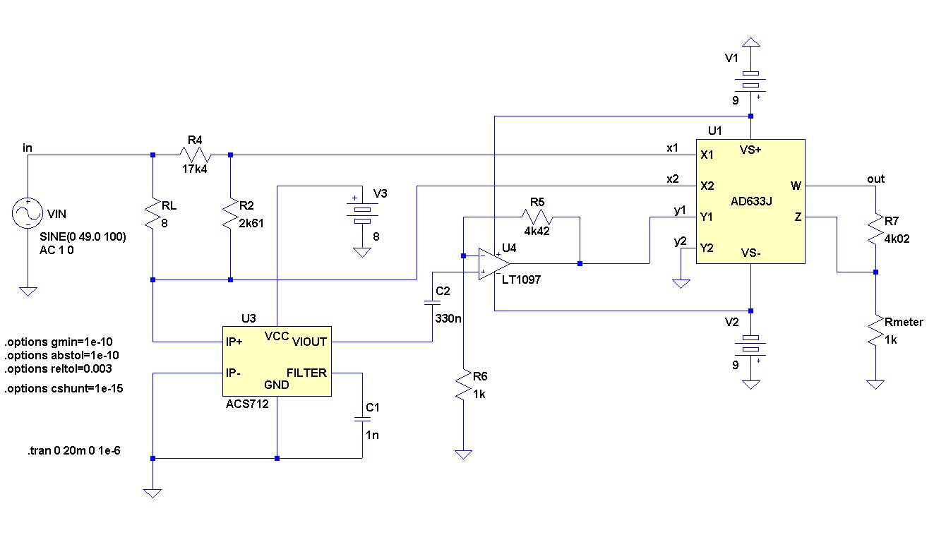

Here is an analog computer that calculates the output power of an amplifier in real time. Actually, just a new version of the circuit I posted earlier I posted earlier. ;)
This one uses an ACS712 Hall current sensor. The output is a DC current between 0 and 1mA, intended to drive an analog meter. Full scale deflection corresponds to 300W.
The power supply arrangement is still a bit theoretical. I have now realised that such a power meter would be quite useful as a portable instrument. The opamp and multiplier are therefore powered by 9V batteries, but the Hall sensor is powered by a mythical 8V battery - the maximum supply voltage in the datasheet. A proper supply still needs to be designed with a Zener or voltage regulator.
It would work even better if just one battery is needed. While it would be easy to power the opamp from a single supply, the multiplier would not work as well as before. The operating input and output range of the AD633 is within 3V to 4V of either supply voltage (from the datasheet). For operation on a single supply, the input and output voltages can go no lower than 3-4V above ground or no higher then 3-4V below the supply voltage.On a 9V batter this gives 1-3V of ouput, not ideal but doable.
