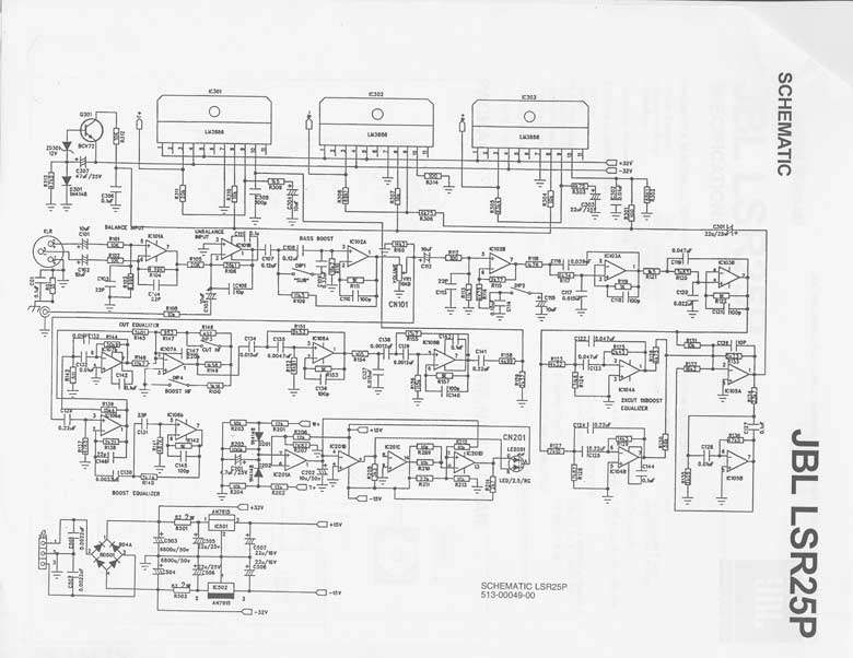

Re: Re: How to add a high / lowpass to an IGC / GC?
I don't know that it's "trivial" -- in the sense of using the LM3875 itself as the opamp for the filter -- this is because the reactive components of the feedline and terminating load have to be taken into account, and the Overture series of power op-amps are easy enough to get oscillating...
here's the JBL circuit I referenced before:

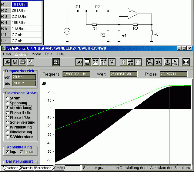

Hi again,
The implementation on the STonline shows that it can be made to work.
One thing is important with this topology: the feedback resistors shall be low ohmic in comparison to the filter resistors.
I have added two simulations in Winelektronik, one with a 2k2/100 Ohm feedback branch and the green line with 220k/10k resistors.
The highohmic version leads to only a 6 dB/octave slope for a 2nd order topology, while the low ohmic version remains 12 dB untill the response is about 70 dB down.
The topology I referred to in my first reply has R1 from the capacitor node to the output of the Amp. This topology does not suffer from the level off to 6 dB/octave but it is rather sensitive to component changes.
Rick
