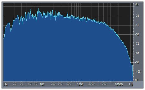

100 watts with high-pass filter at 3 kHz means:
80 watt are dissipated below 3 KHz and the tweeter actually handles only 20 watt rms.
If the signal was white noise, then maybe.
But music is not white noise (ok ok ... some music may sound that way...), the power spectrum of music is sloping down from low to high frequencies, so the power actually sent to the tweeter when playing music is very very low.
The voice coil of a typical 1" dome tweeter can not tolerate more than 5W continuous power. But you have to play very loud to reach that power level with music.
