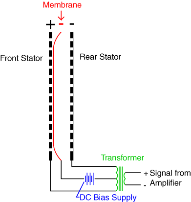

So how do the toroids get from 6 volts to kilovolts? Dont they go from 6 to 240 volts? And does the 6 volts come from the amp? Also what is the voltage on the diaphram? and is it possible to charge the diaphram from batteries? Is the part that plugs into the wall the part that charges the diaphram?

The important thing with a transformer is the turns ratio. 240 volts in and 6 volts out is 40 to 1. So in reverse 1 volt in and 40 volts out. Transformers work either way round, to step up or down. So 60 volts in and you get 2400 volts out. Feed the output of one transformer into the input of another and you can step up (or down) again. A major limiting factor is the insulation of the windings, each to the other and also to the core.
You can run a transformer from a battery by using an electronic circuit to deliver an AC waveform to the transformer.
Got this off the Jazzman site so you can....Seeeeee the esl setup..... Amp,s put out ACv...so the stepup tranfourmer...just make your amps output BIGer to drive the ESL...good luck

The mains is used to charge the stators and current draw is
tiny once they are charged, being simply the leakage current.
DC cannot be easily stepped up. A small transformer (plus
rectifiers) steps up the AC mains for the DC for the stators.
A much bigger one steps up the AC signal for the diaphragm.
rgds, sreten.

The mains are used to charge the diaphragm not the stators (in most set ups). Your amplifier drives the stators via the two step up transformers (in an Acoustat). There are some ESL speakers which are set up the way Sreten describes but not many. Hope this helps. voltages will vary with different designs. Best regards Moray James.
