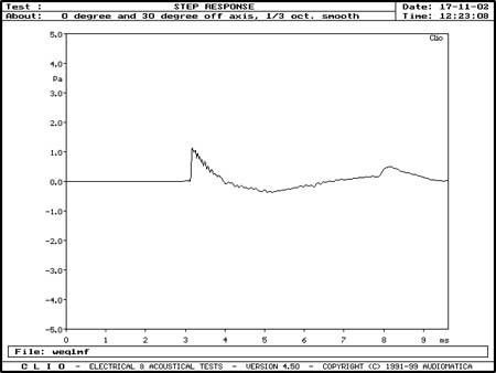

yes, there is such a risk but it would never be as bad as in case of multi-way loudspeaker
see image attached - also a real life example - straight non-tapered array of 32 drivers
the step is jagged but still it is SINGLE
nevertheless my personal choice is a single 8 inches driver
best compromise for my omni
unfortunately in practice one has to choose - an array or an omni

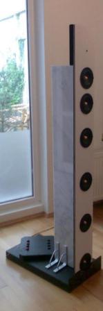

Time to post the result of a bad idea ... can't resist .
Since my "Dipol 08" design is not a prototype anymore we had
an extended listening. A neighbour of mine brought his
TANNOY System 800 for comparison, which is a coaxial
"Point Source" Design.

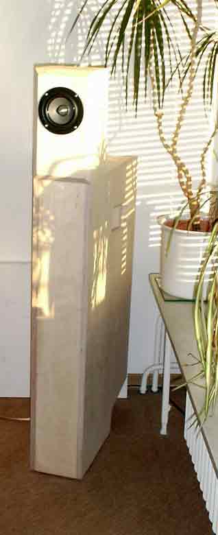

Dipole arrays I like.
An array with a tapered C-to-C spacing is an interesting notion. If it could even still be called an array in the usual sense. In a sense, I suspect that you'll be seeing some variance in the transition from near to farfield due to the varying distance between the drivers, although of course the fact that they're all producing the same signal, if I read what you're doing correctly, throws that logic out a bit. Whatever it is in practice, it's certainly a bit different, which is always interesting to see.
Not all 6 drivers are producing the same signal ...
The array is split in an uppper 3 and lower 3 group.
The lower group is rolled off
v e e r y s m m o o o o t h l y (<6db)
beginning around 2Khz.
Both groups are wired parallel internally, the 2 groups
are in series. Briefly, the rolloff in upper highs expected from
a usual line array is compensated in bypassing the lower
group by an RC network.
This approach keeps transition from nearfield to far field more
independent from frequency since tapering is combined
by power and by distribution of drivers on the baffle.
In the beginning i thought an active network would be good,
using separated amps for the groups at least. But the passive
network does the job flawlessly IMO.
The presence and brillance region is produced predominantly
from the upper 3 drivers. The interference patterns in FR
caused by the uneven distribution of drivers are very smooth.
Listeners say, there is no noticeable change when moving
your head vertically from sitting to standing position.
Of cause listening distance should be around 1,5 meters or more.
From there you can go 7 meters away in my room
(then the room ends), without the system changing its
character subjectively. It simply sounds nearly the same.
Everywhere. Room contribution increases smoothly with
distance, thats all. You can choose where to listen.
Of cause by measurement there is noticeable change. But
distribution and character of the humps and dips over differing
position varies so smoothly and random - no serious overall
tendency detectable - that it is not an issue.
I modelled this behaviour using software and several
prototypes before. Believe me - i cannot afford wasting
kilos of marble and a dozen of fairly expensive drivers. Not
to say the working hours.
I was going for a speaker to sound homogenous. I was
prepared to some compromise in the brillance region and
i was prepared to accept it. I was a "more datail please !"
listener when younger you know, since i shifted my priorities
towards coherence. It came as a gift to me that the current
design is brilliant and detailed whithout harshness.
You don't miss a tweeter at all. In fact it sounds as detailed
and without harshness in the highs, that i had only achieved
that using a ribbon tweeter before.
Maybe ageing of my 42 year old ears helps ...
But i do not think it is only due to that.
Cheers

Ah, that makes much more sense, with the lower units rolled off around that frequency, which will put the transition for the upper 3 units from near to farfield, if I remember my Jim Griffin & my SWAG at the length, at roughly 1.5 - 2m so I'd expect them to be pretty stable.
The drivers look like CSS FR125s, right? I can imagine that working far better than some other combinations, what with them being pretty smooth, & having decent detail (but not overly so). Love the marble too -nice touch.

yes they are FR 125 S.
I select the drivers which play in the
"upper group" for the best definition in the highs.
Like this:
Driver sounds dull -> lower group.
Driver has good high definition
but a bit nasty in presence/brillance -> upper group, lowest pos.
Driver has unobtrusive highs, bit dull -> upper group, top
Best driver out of 6 -> upper group mid.
Drivers are balanced same way for both speakers and
numbered before mounting, to get left and right system
similar. Two speakers are NEVER equal, are they ?
If there will be the opportunity to build a "MK II" version
someday, i'd rather experiment with driving them actively,
one amp for each of the upper drivers at least and reduce the
array to one single driver in the upper brillance region.
like
6->3->2->1
or
6->3->1
Like this:
like
6->3->2->1
or
6->3->1
With separated amps there are lots of options to tweak that
concept further. I hope there will be an opportunity to try that
as long as my ears work fairly well, since i cannot build such a
speaker every year due to time and effort spent ...
Using digital signal processing there will be lots of options
including delaying and focussing ...
But for now i am happy with the result.
Kind regards
