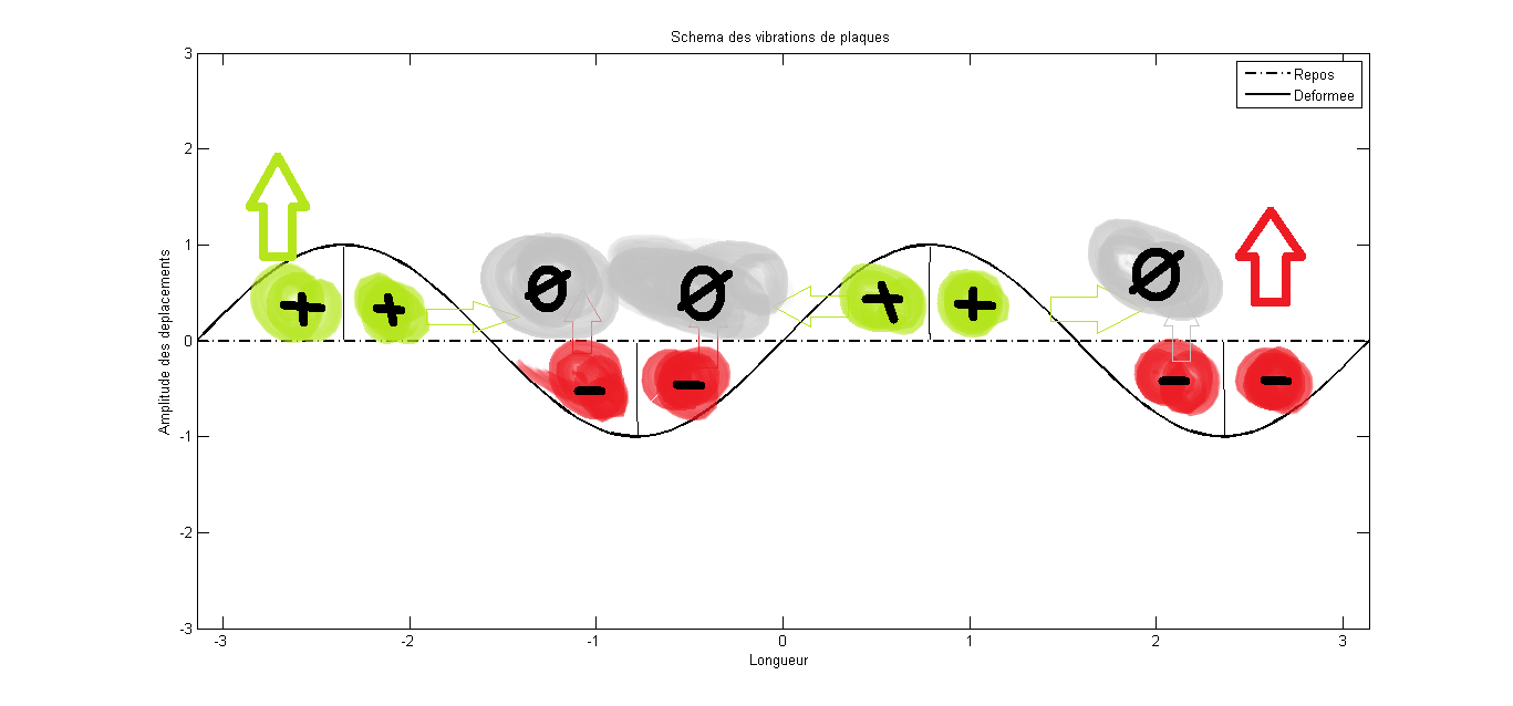

Saying something along the line of “the amplitude of the vibrations is high at this very spot (accelerometer location) therefore the pressure radiated by the whole cabinet MUST be high” is just wrong except for the very first modes or stupid design, look hereafter for an example of the latter ;-)
The results are far from being trivial. I give you two examples:
1. What happens if you put the accelerometer on the middle anti-node on the attached vibration pattern: big vibrations very small radiation.
2. When I did the first measurement with the cabinet back panel screwed and not glued, the amplitude of the vibration I measured was not large at all but the whole panel was uniformly moving.
However the panel surface area was several times that of the driver's: that made a very nice cardoid source!
