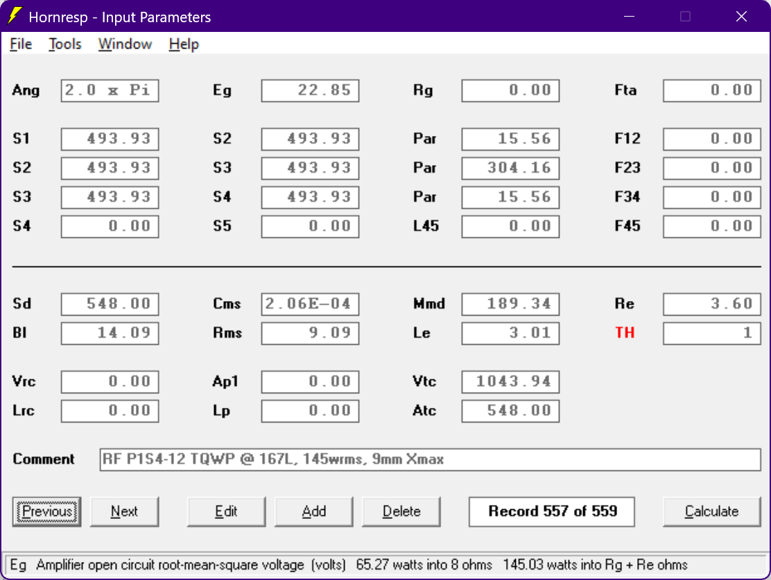

I've messed around with different sizes and I've settled on a 1.35ft^3 box tuned to 33hz. 103db @ 30hz and 110db @ 43+. Like @weltersys said, once I put it in a car I'll be around the 115db mark anyways.

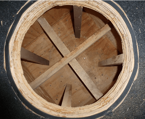

Would you consider bracing my box that much if I'm only pushing 250W? And what is the easiest way to brace it if I do need to? I'll be using 3/4" MDF all round but maybe 1.5" on the front face if I have enough left over.
@BP1Fanatic , ideally I'd like it to have decent above 30-35hz, over 100db, there's no need to go much lower really. It's gonna have to be quite small too, less than 1.5ft^3, so that I can fit it in a car. After messing around I've settled on 1.35ft^3, 33hz tune, 1 3.7" port. Built it up in subbox.pro and it looks like it'll be fine. Also don't want any angles just because it's easier
If there any ways to make it a bit louder without sacrificing the low tuning or making it significantly larger that'd be great. Port length is also a big issue because I'll be 3d printing it, anything above 17" will be a struggle.

A box that small made from plywood you could get by without bracing, with MDF something like this would do:I've messed around with different sizes and I've settled on a 1.35ft^3 box tuned to 33hz.
Would you consider bracing my box that much if I'm only pushing 250W? I'll be using 3/4" MDF all round but maybe 1.5" on the front face if I have enough left over.
Dowels could be used for the bracing if you don't want to rip lumber to size.

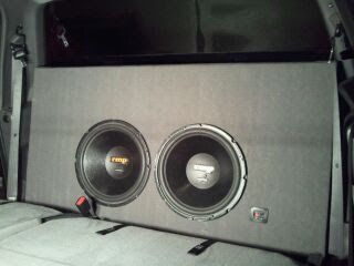

Don't know the cost difference between the Rockford P1S4-10 and P1S4-12, but a pair of the 10" in two smaller boxes would have a lot more output, be more efficient, and could be positioned to counteract room modes.
Agreed. A 10" in front of each tail light will still give you good trunk space.
I did a 12" on the passenger side tail light of my wife's 1995 Dodge Neon Sport 4dr years ago. She loved it. Of course, she blew a couple of driver's tho'. That's another reason why I hate sealed enclosures. The driver's vented pole piece does not get cool air in a sealed enclosure, with normal mounting.
