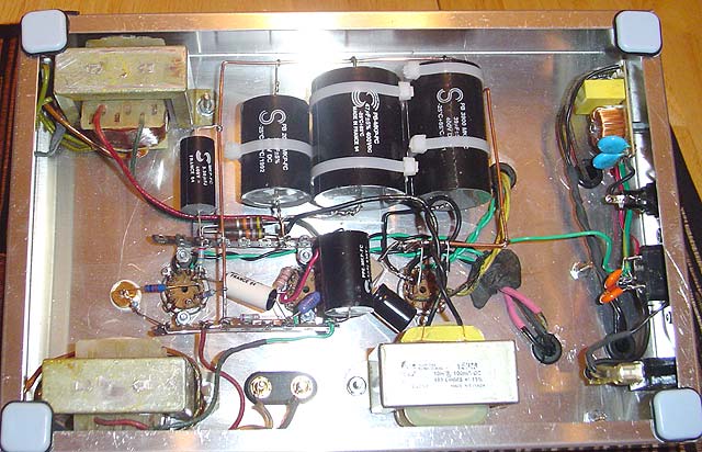

One place where you might not think of spending money on a cap -- especially if an SE -- is the last cap in the power supply. This is often ignored and an elco is used, but since it is in the current loop it is in the signal path.
I do recommend starting with an elso and then swapping in a Solen (or somesuch)... we did that a couple times, and don't bother with anything but poly there.

The "sound" of a cap has a lot to do with the circuit that it is in. If the cap is working into a high impedance load then the differences between caps is minimal. If the cap sees a low impedance, or time varying load (the usual case) then there could be an audible difference between the various capacitors.
As stated above, the output transformer will have the greatest effect of the sound quality by far. You are not likely to change it once the amplifier is built, so get a good one from the start. Caps can be changed easily, so you have two choices. Put a cheap cap in the amp to get everything working, and plan on changing it. Or (my preference) put in a good, but not outrageous cap (I use Auricaps) and change it later if you feel the need. Leave the leads long enough to use it over on the next amp.
As also stated above, in a SE amp the last power supply cap is very important. Leave room in your design for a upgrade later. Polypropelene motor RUN (not start) caps are relatively cheap possibilities. An electrolytic bypassed with a Solen also works.

Under small signal conditions the cap sees the 470K resistor in parallel with the input capacitance of the 45. Both of these are constant and predictable. The cap sees two unpredictable, time variant impedances. The first is the miller capacitance of the 45. In the ideal world the signal that the cap sees is a replica of the input signal that is 180 degrees out of phase with a high pass characteristic. In the real world the output transformer causes a phase shift at the frequency extremes especially with a speaker attached. The second effect comes in to play as the signal level is increased, especially with non-sinusoidal (real music) signals. As the instantaneous grid voltage approaches zero the grid impedance begins to drop. At a slightly negative voltage (-2or-3 volts) it drops rapidly, and is a few K ohms at zero volts. Under strong transient conditions this effect will upset the charge on the coupling cap causing blocking distortion. The recovery from this is determined by the size (value) of the cap, and its dissipation factor. This happens more often than you think on highly dynamic music.
There are probably more effects that I can't identify. The effects of these two can be seen by scoping the amp input with one trace, and the grid of the 45 with the other trace. Then drive the amp with a pulse wave of a small duty cycle. You can see the grid do funny things as the amplitude, frequency and pulse width are varied. The effects will be different between a cheap mylar cap and a good cap, although it is hard to see the difference between good caps.
How would you calculate these effects? I have no idea. Even if you could, how would you apply this information to the selection of a cap.
I have never used BG caps because of the cost, but there are probably many different opinions on caps. I use the Panasonic electrolytics paralleled by a PIO or a Solen.

Most electrolytics (and most other capacitors)are made by winding the aluminum/ electrolyte/spacer sandwich up into a roll and stuffing it into a can. This gives the capacitor some internal inductance. There is already some internal resistance, and a few other imperfections in all capacitors. In an electrolytic cap these imperfections tend to manifest themselves in the upper audio frequency ranges.
The first function of a power supply capacitor is to supply the peak current that the amplifier needs and to provide a low impedance path to ground for the line frequency ripple current. Electrolytics do this well, although some are better than others.
The second function of a power supply capacitor is to provide a low (and uniform) power supply output impedance for all audio frequencies. This is rarticularly important in a SE amp. Many electrolytic caps exhibit a relatively high internal impedance at high audio frequencies, so there has been a general practice of paralleling the electrolytic with a capacitor that has good characteristics in this range such as a 1uF PIO or polypropelyne.
More recent findings claim that this cap can resonate with the internal inductance of the electrolytic to cause problems elsewhere in the audio band. The proponents of this theory say that you should put a 10 ohm resistor in series with the 1uF cap. These are generalizations which probably have merit for some specific cases. I am sure that each particular combination of capacitors will have their own unique characteristics, and only careful testing can find a good combination that exhibits low impedance across the entire audio range.

I have tried several types of coupling caps in some of my amps. In an amp with a fixed (predominantly resistive) load like the TubelabSE, I can only notice the sound of really cheap caps (10 for a dollar kind of cheap). The rest all sound very similar. In an amp that has the cap connected directly to the grid of output tube, the differences are more noticable. I believe that I like the sound of the Auricaps better, but I am not totally convinced. I have not tried anything more expensive than those.
When both channels in a stereo SE amp are powered from the same power supply, there can be coupling between the channels through the power supply. Put a load resistor on one channel and a speaker on the other channel. Drive the channel with the load to full power with a real music signal. Short the input of the channel with a speaker. Ideally there should be no sound from the speaker. Sound from the output transformer is normal. If you hear anything from the speaker, there is some coupling from one channel to the other.
You can try that polyprop or oil cap in parallel with the last power supply cap. I find that it helps on most SE amps. One lead should be connected to the B+ ends of the output transformer wires. The other end should be connected to the point where the output tubes cathodes are returned to ground.
If your amp uses cathode bias, some will use two such caps connecting the negative ends directly to the output tubes cathodes. This is often called an "ultrapath" connection.
