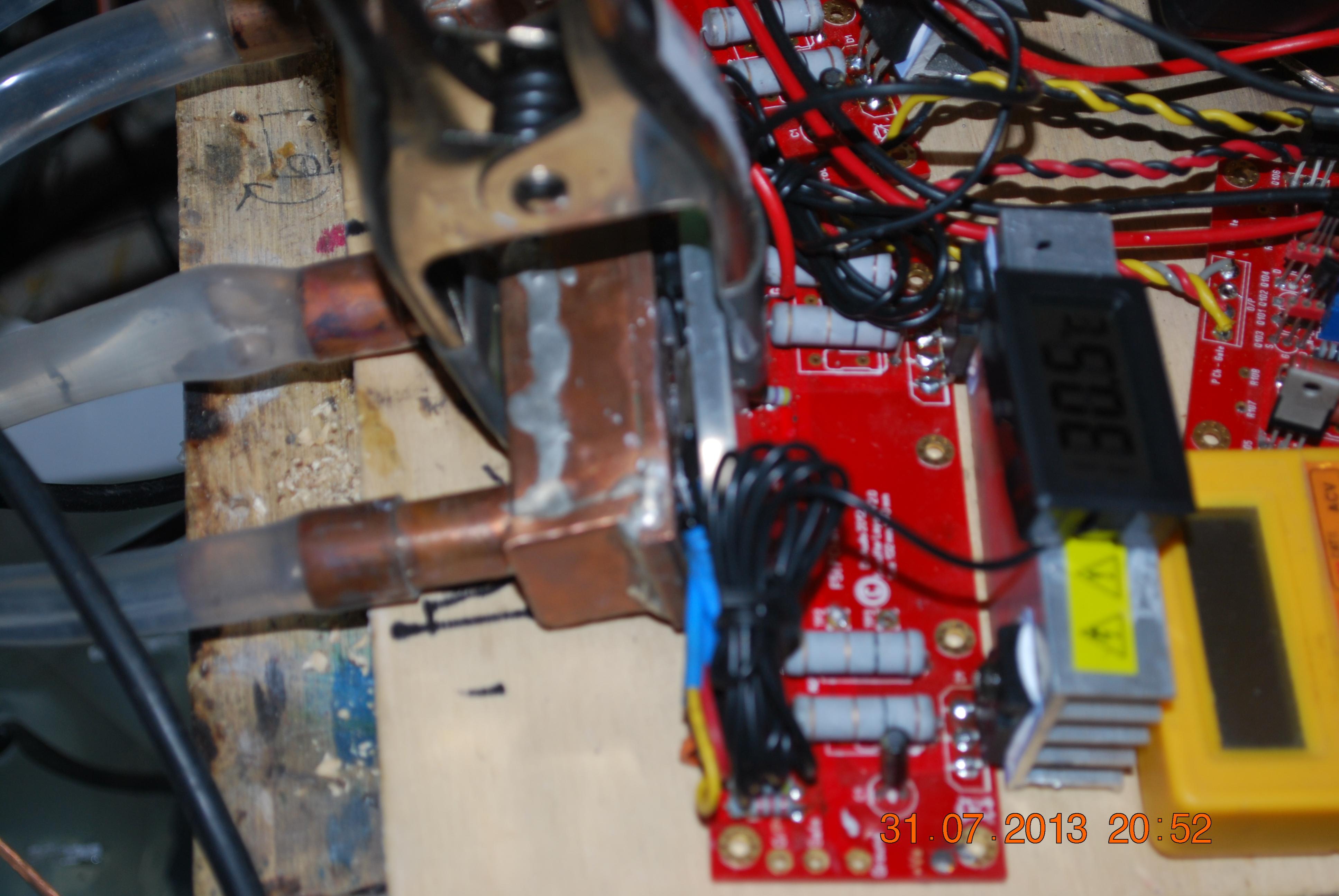

The Kapton tape and grease are currently what I like and you can bias it till it smokes,and the Kapton doesn't curl or distort or of course burn up!
I had mine up to 2.5 amps per mossfet,that's all my transformer could do,bridge is heatsinked too I stopped at 65 C,I am in process to add a radiator into my water cooled system and upgrade the transformer ,I am using a spring clamp to hold them down and also the pressure is the same on the fets all the time,but to be honest I am also concedering to keep it between 1.0 amd 1.5 I like the sound at that level,just my 2 cents

Check this guy out look for water cooled amps http://www.inlowsound.com/ ,IIRC he said he was putting 10 amps through his,LOL,Check ebay for kapton tape use the 1mill thick stuff.
You can run as much bias as your heatsinks can stand and your transformer can stand,heat wise,I got fans on the trans and bridge,and of course water cooled heatsinks,
I read earlier in this thread 85 C ,
As far as temps go one side runs hotter and will run close bias wise if you have matched components other wise it will be off a little ,I keep a eye on the dc output ,I set it close to 0 and let the amp run till it's as hot as it's going to get then tweak the bais some more for a good temp and set the DC and play music,I like papa nelson tool for that "if you can keep your hand on it for 5 secs that's a good temp to leave them at ,Experiment that's what we all do here,It's fun too you learn by doing,You won't put but one cap in backwards,lol.BANG,poof,lol

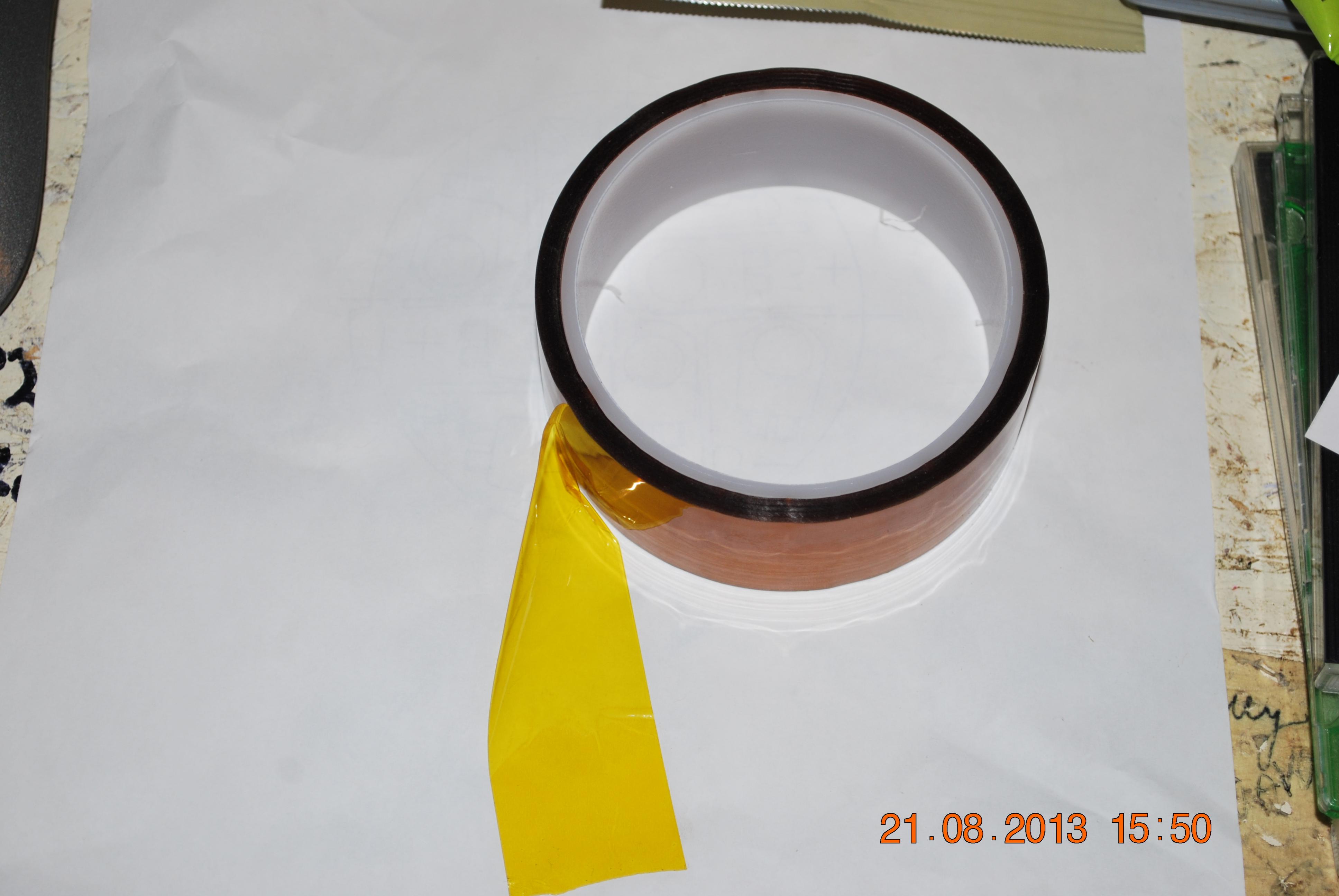

Hi,:D
I found this 1mil Kapton tape ,It's working out good so far,cost about $12.00 us,I Google it.
I used the regular white grease just because I have alot of it.I will make some before and after heatsink readings and see how well it does!
Happy listening!:)
