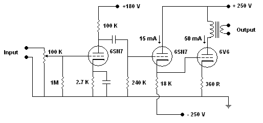

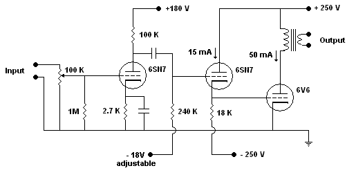

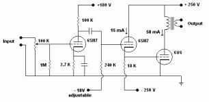

On second thoughts, if you want more than half a flea-power peak output from the 6V6, you'll have to drive it into grid-conduction.
Driving it with a DC-coupled cathode-follower could do the trick.
Something like shown below should be able to kick the **** out of the 6V6 quite comprehensively and give you an extra 5 or 6 dB headroom. :hot: :cheerful: (especially with fixed bias)
An input stage with more voltage gain might help too.
