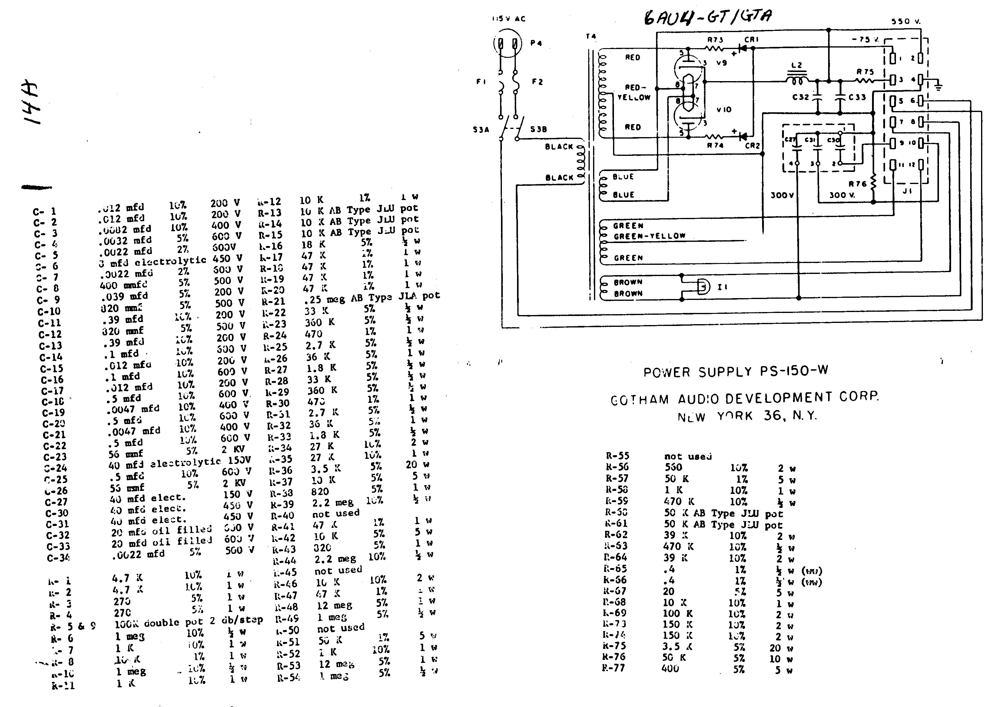

You could just use a real zero bias tube like the 811A/572B, 805.
Driving G2 using 807/Kt88/ PL509 and what ever; just makes a zero bias tube.
811a's are cheap any way. The Chinese 572b is an excellent tube 150watt plate dissipation so you can use lots of current.
Phil

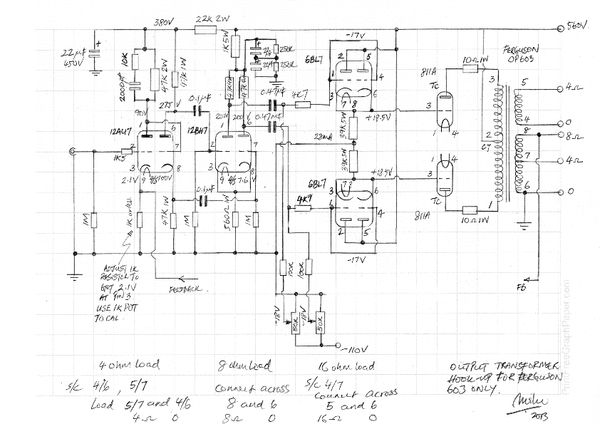

811a amp
Circuit for 100 watt 811a amp. The original was a record cutting amp.
600 volts is the maximum for the 811A with 70Ma current draw the 572-160 could handle a lot more but the driver circuit would need some changes. I found the Chinese 572b is very good, the Russian 572B's are less stable and cost $170 each. I made two mono-blocks for a Friend he has used the Russian 811A's for 17 years. The Russian 811A or the RCA 811A are the best tubes to use.
I have several more circuits will scan. The 12BH7/6GU7 is the best tube for the voltage amp, not the 12AU7.
The original used mercury vapor rectifiers with choke input; I have used solid state rectifiers with and without choke input.
The Mac used 8005's but can be changed to 811A's. very complicated circuit.

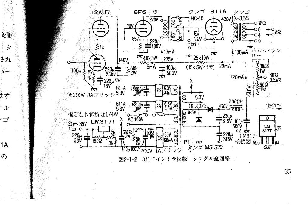

Se 811A.
Phil
