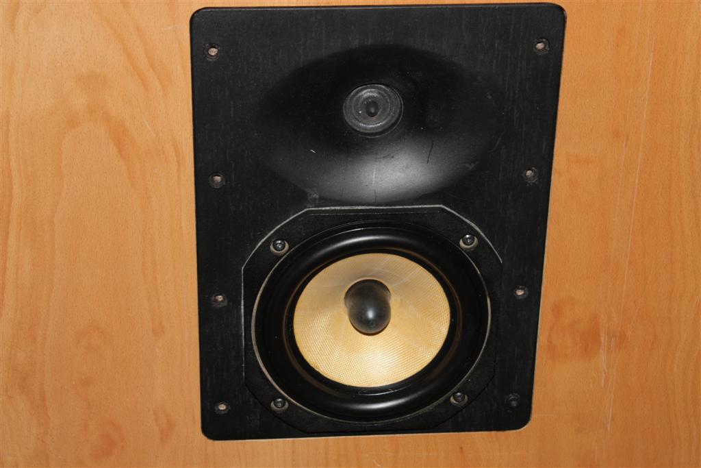

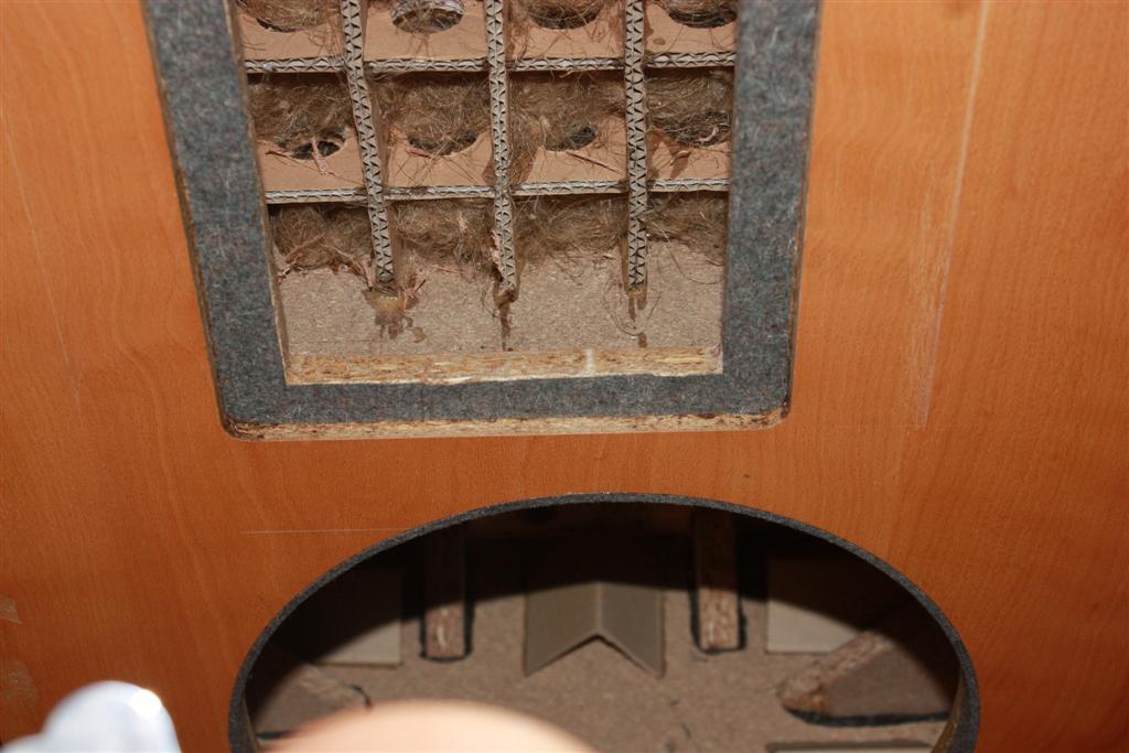

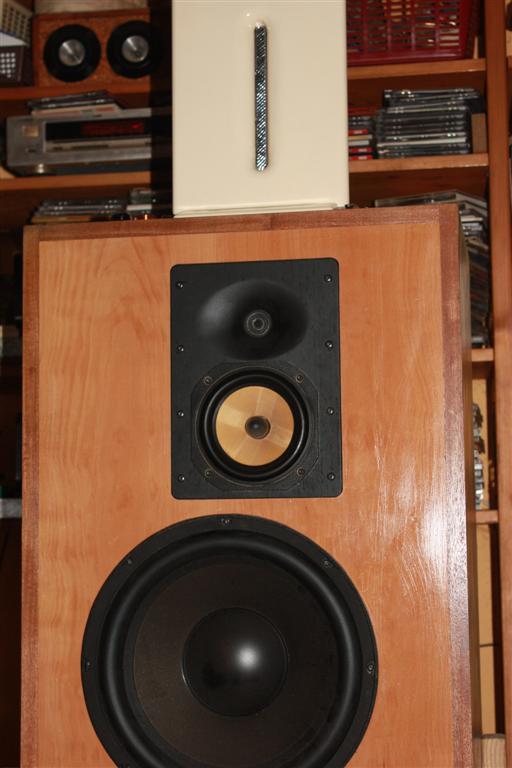

how do I cure treble harshness/hash
My original post I think sets it out. The problem with it is that the treble is harsh and messed up - so to speak.
I would rather have to re-do the crossover, than build a whole new cabinet, coz I spent a long time making the cabinet.
If it is a cabinet issue, I may go and put together the linkwitz orion speakers

I'm only thinking about the ways that a cabinet could cause such an issue. You may have a problem with diffraction, only guessing without a photo. You shouldn't need to actually rebuild it. Have you tried covering the front face with felt?
Ex-Moderator R.I.P.
Joined 2005
do not overrate diffractions
ofcourse it matters
but its really a minor detail
only makes a real good speaker slightly better
I put my head on the block and say that it has very little to do with your harsh sounding top
tweeter faceplate can cause harshness
especially the transition from diaphragm to faceplate is a major problem
hell, I haven't even countersunk my midrange, even knowing I should
but it still sounds good
on the other hand, I have done a lot to cure the tweeter transition 'problem'
the closer you get to the driver diaphragn, the worse diffraction issues are
but it is true that a bit of felt might cure some of your harshness, even if its caused by your XO
also notice that I have used felt behind mid and woofer, and also inside the baffle hole
small details, and probably only makes a small difference
well, I'm only trying to say that we often focus on the easily cured, and forgetting the more important
