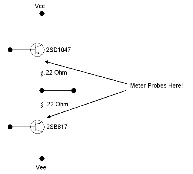

> Take your measurement from the emitters of the transistors! Find the 'D1047' device for one channel,
> and put your positive lead on its emitter. Find the 'B817' device for the same channel, and put the
> negative lead there. Now you cannot get it wrong!!!!!!
I wouldn't be so sure of that... What if the transistors were mounted the other way around, making the emitter leg on the outside left?! Well anway, I measured them according to your helpful diagram (thanks), assuming the emitter leg is outside right, I got about 7.7mV on one pair, 7.0mV on the other. So if I'm shooting for a "voltage drop" of 22mV, then a measurment of the emitter legs across two output transistors should read 22mV? Or is it the combined reading of two of the .22 ohm emitter resistors that should give this value? (I'm a little confused because it looks like you started suggesting I take a reading of the Sanyo output transistors, but that the reading should be 22mV across the .22 ohm emitter resistors, which are different parts).
As for not having a handle on the how to measure the emitter resistors, when I probed the left leg across two resistors, I got a reading of 7.0mV (probing the 2 legs of each resistor gives a reading of about 3.7mV). Probing the right and left leg across 2 resistors gives a reading not anywhere near the double of one resistor. Do I have a handle on measuring "across the resistors" now?

Measuring from emitter to emitter is the same as measuring across the two emitter resistors...(I'm a little confused because it looks like you started suggesting I take a reading of the Sanyo output transistors, but that the reading should be 22mV across the .22 ohm emitter resistors, which are different parts).
See drawing.

Any current flowing through a resistor causes a 'voltage drop' across that resistor, hence the phrase. So...when we say 'set the bias so you have a 22mV voltage drop across the resistors', we mean that you set the bias so that you will measure 22mV from the emitter of the 'D1047' to the emitter of the 'B817' device. Right now, you are measuring a 7mV 'voltage drop' across the resistors.Another good way to confuse a "newb" is to say that I should shoot for a "voltage drop" of 22mV; after its been established that my current voltage is about 7.7mV. That to me sounds like a voltage GAIN, unless you write -22mV. So I just logically assume from context and all, that it means I should PUMP UP the voltage to 22mV... and ignore the term "drop"!
RE: The transistors. I don't believe it is possible to mount them backwards...the collector is designed to be thermally coupled at the rear of the device, so reversing it would lead to quite poor thermal coupling to the heatsink, and the loss of a job for the moron who designed it that way. The emitter in on the right, just like the pic I posted.
I can't make it any clearer than I just have...if you are still confused, find a knowledgable friend to give you a hand.

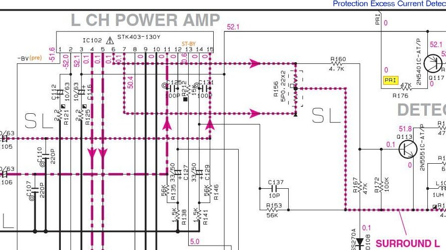

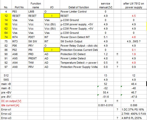

Helo,guys ! How can I control DC offset of STK 403 , I have an Yamaha-rx-v357 and all STK have 1 V DC offset on output, otherwise sound is clear if protection is deactivated...
I've found on Google : "I found that the +/- Pre voltages were very important in setting the DC offset on the output."

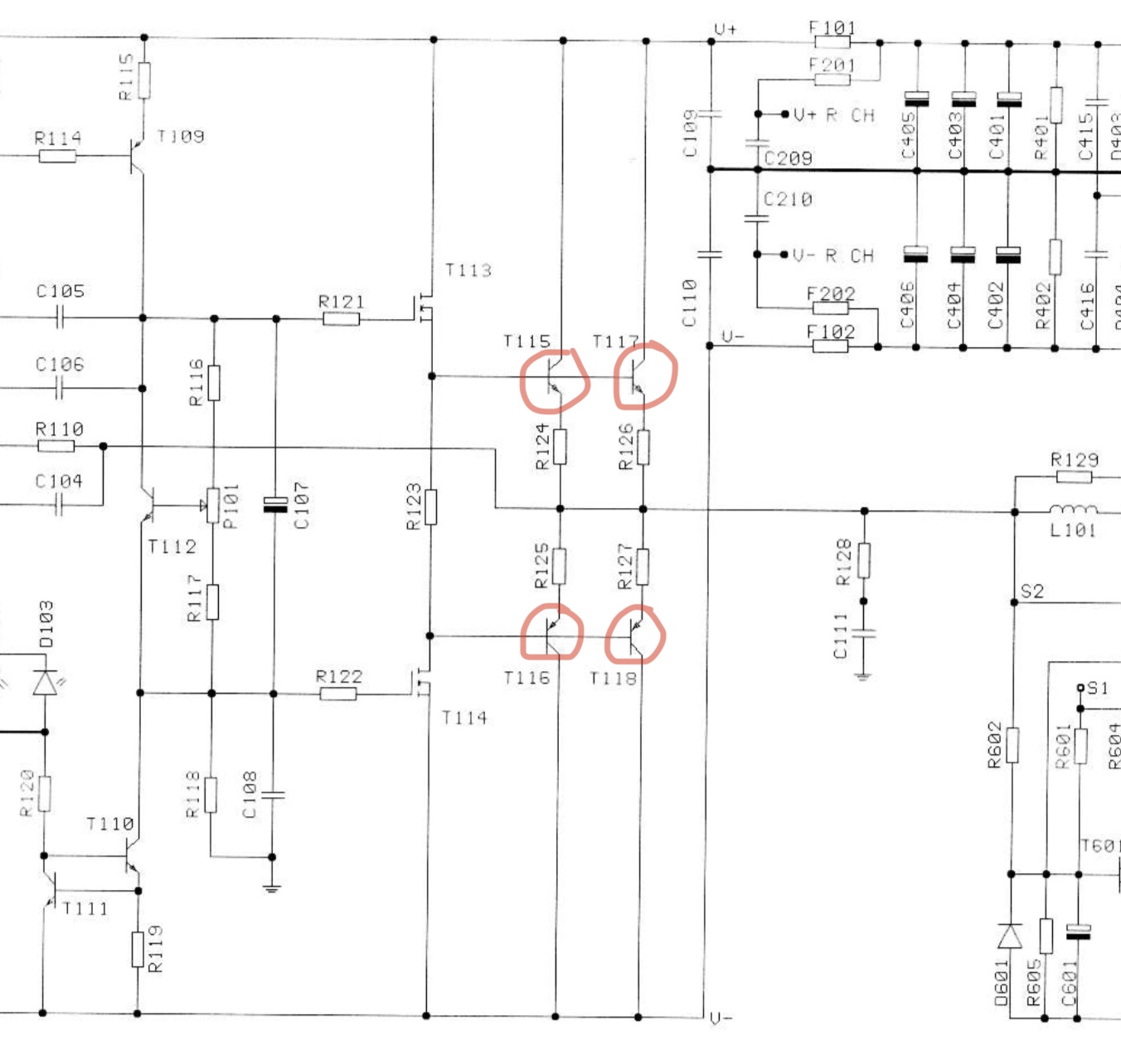

What about when you have 4 ouput transistors per channel and no bias points,
Manufacturer says bias it to 8.0mV over one of the 0.22R emitter resistors. But i get different value with each resistors.
I’m more used to a common biaspoint (like many commercial amps have)
For me very confusing this with mV and mA, often mix them up.
Anyway how can i bias so i get a common bias for all 4?
Transistors are a1943 and sc5200

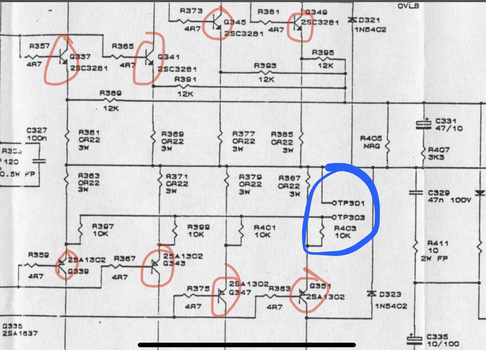

Example:
First is my amp (Copland CTA-420)
Second is a commercial normal amp with biaspoints (NAD218)
Both amps use same value on emitter resistors and same output trannies except twice as many in NAD.
Both manufacture recommend 8mV bias. But totally different measurements. Nad have tied 4x 10k resistors to the biaspoint?
Question is how are they thinking and how can i bias all trannies simultaneously?
