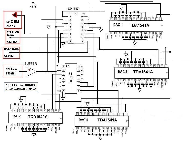

As the output of the SAA7030 is only 14 bits and, as far as I can surmise from the datasheet (best check with a 'scope), the sign bit/MSB is not extended, you will need 16 clock cycles to correctly align the 14bit SAA7030 data with the TDA1541A's 16bit input latch.Again more glue logic.

Hello
Yes, true, it take 16 bit input and give out 14 bit with noise shaping to imitate 16 bit.
Humm... 14 bit and more glue logic.
Maby I should go to the analog shift registered dac schematic (an analog 4x OS) that I have received from a friend by email.
But an analog shift registered dac like this one may have more jitter ?
Included the analog shift registered dac schematic.
