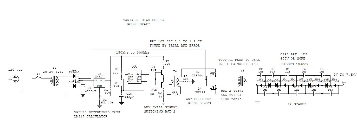

Here is the basic schematic of my bias supply.
Most values where found thru trial and error.
But most of them are as it sits now.
And this is for any one who wishes to use it. jer

Ups, lets do it hard way when the easy one is on avail?!
I would not recommend using such design.
To be totally honest with you it's an example how not to do it.
Implementation kills the idea
Why don't you use two 230/12 trafos back to back? Medical grade.
Guaranteed isolation!
If one needs regulation, just put wirewound trimpot of 5-15 W as voltage divider in between(@12V). There is no power cosumption anyway...
If you insist upon superior qualities, then I would replace 555 and accociated "driver" of yours with IR2153, half bridge power topology would be reasonable as well.

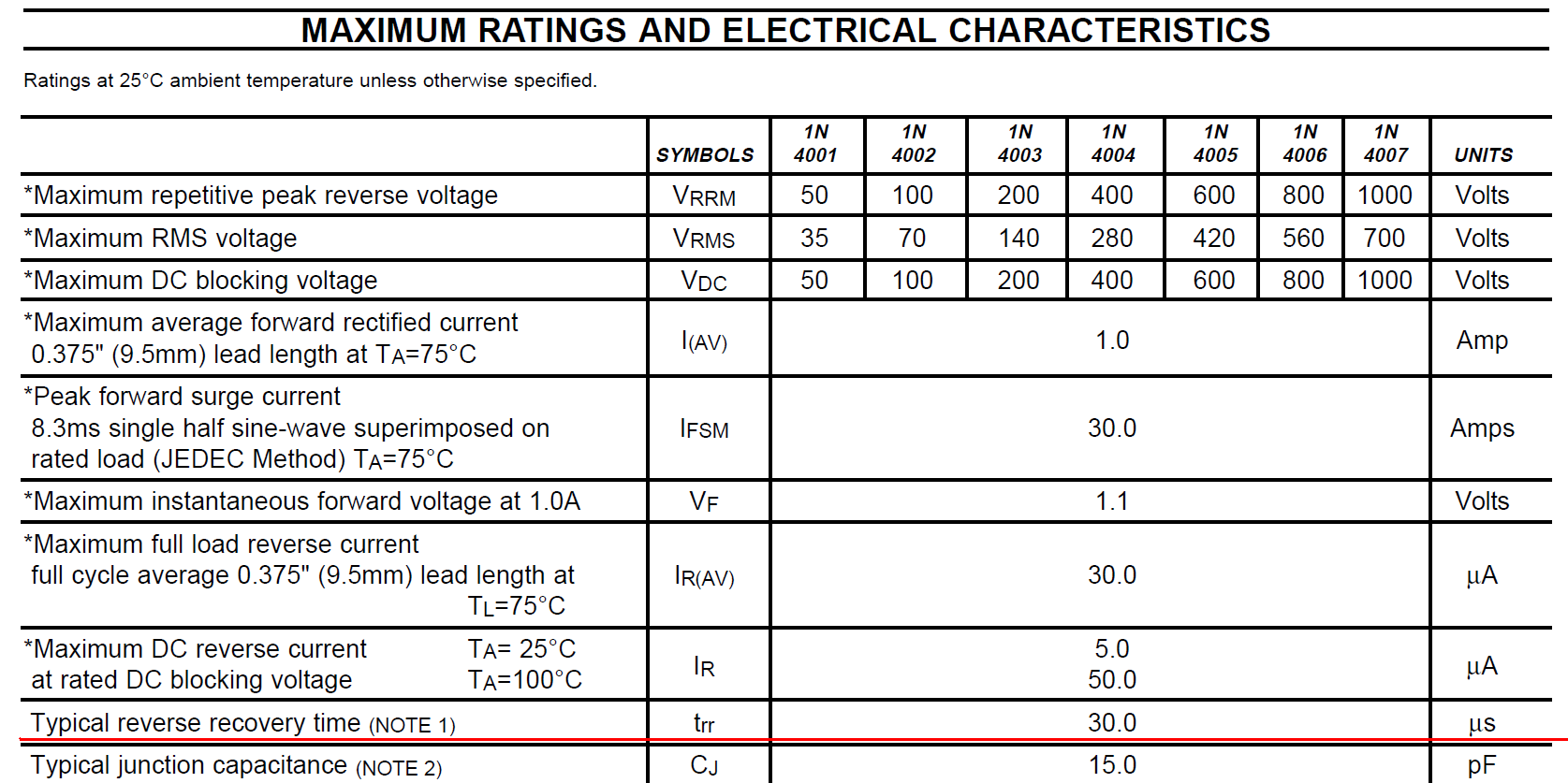

What is the recovery time of the 1N4007? Go check for your own amusement.
Changing gate voltage for regulation is plain wrong, unless it's HF amplifier stage. May that's what you've discovered.
Alex,the circuit works fine as is.
I will be changing the 555 to some other type of variable oscillator that has a wider and higher range for versatility.
I would have loved to use an IR2XXX mosfet driver but that would cost money and I don't have any.
But it sure would have made the design a whole lot easier as my intention was to use PWM for regulation.
A 15 watt wire wound pot would cost more than the all of the solid state devices in the circuit.
I do have a 50 watt 100 ohm wire wound pot that I was going to use but the element is open so I couldn't use it.
The typical recovery time of a 1N4007 is 2us and my very worst case (although marginal) requirement it is 5us.
I had questioned this myself but when I tested the output with a single diode I found that it was switched just fine so then I tested them with a full wave bridge and got I perfectly uniform fullwave rectified waveform across a resistance load.
My intent was not to have such a high switching frequency but thats the way it turned out because the cores I used were pulled and used as is and unmodified from dead computer switching supply's.
This version is a far cry from my original single mosfet design which grossely over heated and was extremely inefficient.
It took every bit of the 50 watts that supply transformer could muster up and ran quite hot because of it.
This version runs relieabily and the mofets are cool to the touch, Including the power transformer.
It is made of junk box parts and cost me next to nothing to build and I have enough parts to build six more but I only need two.
Yes there are alot of improvements that can be done and what is exactly wrong with the variable gate drive class b stage anyhow it works, it serves its purpose and serves it well.
Originaly I was going to vary the voltage supplying the mosfets but when I stumbled upon the output voltage of the 555 varying with the supply feeding it while maintianing its frequency, it just made things a whole lot easier.
It runs with about 300v of ripple at 7.5kv with a load thats 4% ripple.
That can be improved with a simple filter stage.
Much simpler than if it were running at 60hz and at >100khz you can't hear it anyway.

Is it a way to go?... For for other inexperienced guys to replicate?...
For instance 150kHz period is 6.7uS, half of that is 3.3 uS.
Use of diodes with 30uS recovery time which is 10 times longer than conduction time is plain wrong.
