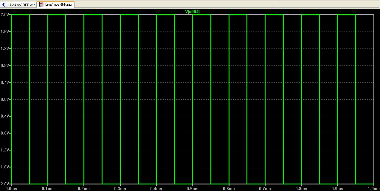

This is how I do it
A bit late, but this is how I do it:
Add a voltage source to your window, set parameters:
PULSE(-2 2 0 0.1p 0.1p 0.05m 0.1m)
.tran 1ms
This gives you a square pulse source, with an p-p amplitude of 4 volts (+2, -2)
The attached pdf explains how to do it in detail. (I've made it for myself to remember)
Typical output is shown in the picture.
