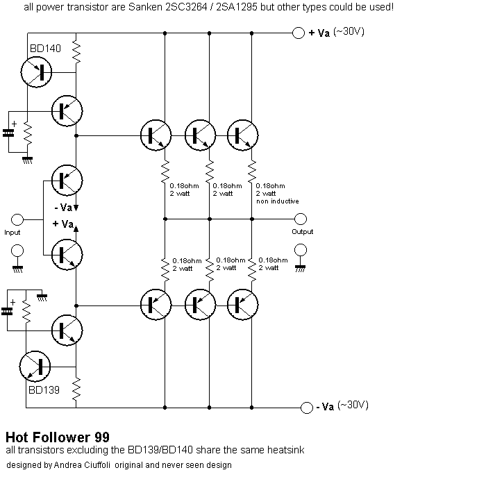

I stumbled across this design by Andrea Ciuffoli . Does this type of design require a good voltage source (BOZ or something else?) like the Power Follower 99c. It looks like a fairly straight forward design, just couldnt find too much info about it. The 2SC3264/2SA1295 seem a little harder to procure.

Hi MEGA-amp,
No, it's not a good thing. IT doesn't sound good. At low volumes, that circuit sounds good, when you start getting peaks or a bass line in the music, the sound deteriorates.
As I said, I am still trying to make this sound good.
Bias, at low volumes the heatsink temperature is much higher than at higher volumes. The bias current has remained constant on my experimental units.
-Chris

Well that may explain what he says at the end of the amp description: "WARNING: designing phase so some parts could be change in the next days!" Dont know how long its been posted. What do you have driving it? I'd like to try it with just a bridge/cap supply to see how it sounds, but those Sankens are pretty darn expensive. Some details about the schematic are missing too. This is new territory for me.

Hi John,
One never knows. It's only a diamond buffer using power transistors. Nothing really special. Mine has more parts but suffers the same short comings. It has been a learning experience for me.
A commercial design that is related would be a Marantz 300DC. I own one and it sounds good. But only due to a high amount of feedback.
It's an easy circuit, why no build it and experiment?
-Chris

Hi lumanauw,
The 300DC is a modified diamond buffer with more components added for current protection and better bias behaviour, since the drivers and pre's are not mounted on the heatsink.
The drivers and outputs are supplied via a resistor to the supply rail. The predriver shunts some of this current away, just as in a diamond buffer stage. This design is very sensitive to the vbe drops in the outputs and drivers. Also in the emitter resistors. The only way to make it sound good when delivering large amounts of current is with high feedback factors.
For low current applications, this circuit is great!
-Chris

Well I'll give it a hack, its diy, why not.:smash: I mostly listen nearfield with the music rather low, dont need gobs of current or wattage.
What could I use in place of the recommended 2SC3264/2SA1295 devices? Some missing resistor values may help too.

Just to explain some points:
- The Power Follower is a complete project tested by many people in the world and it gives an incredible sonic performances if driven with a correct voltage amplifier stage.
Someone prefer it to a SE 300B amp and to the ZEN amp.
- The Hot Follower is only an idea and I don't' have tested it.
This will give a good sound but cannot be compared to the Power Follower because this is a normal Push-Pull design.

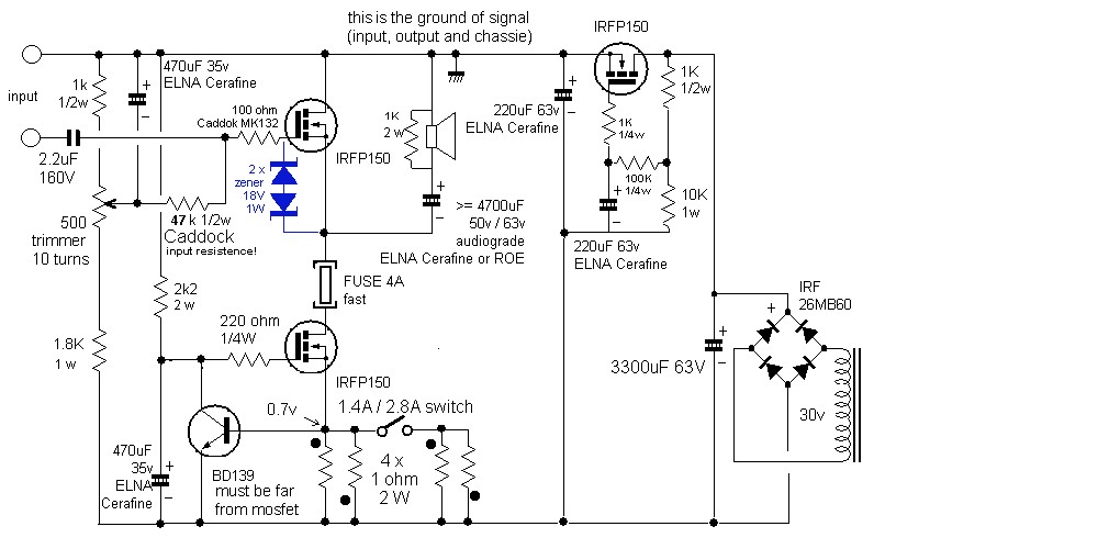

Tube_Dude said:
The current feeding the output transistors came only from the CCS, as the input transistors can't source any current into the outputs..
Exactly, so the CCS current should be quite high (which gives a whole new meaning to 'hot' follower).
Unfortunately, the only new and never seen thing in that design are the capacitors from the CCS sensing transistor collectors to ground, which, at power on, give a nice current spike through the whole thing. Increase the capacitance sufficiently and various pieces of the follwer will go up in smoke. Also, they completely ruin any semblance of PSRR for the follwer - more than 0.7V ripple on the power rails shuts down the corrsponding CCS completely. Unfortunately, such features are not rare in Andrea's designs :(
Yes...and in this last schematic (post # 18 ) , I also don't like to see the input ground connected to the positive rail , because the source of the Mosfet is referenced to the minus rail..
