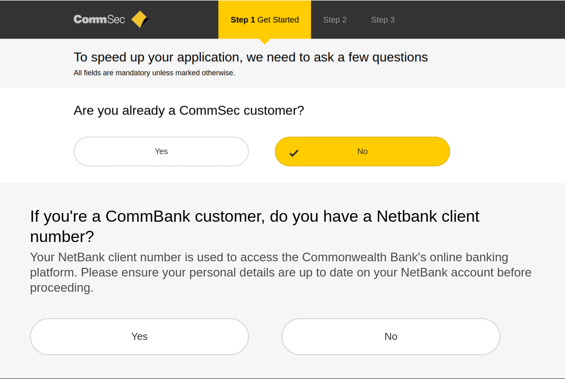

This is what poorly written confusing code looks like. First question is a no brainer, could not be any simpler. Then we get to question two. With a yes and no response there are only two possible answers yes or no.
If you are a CommBank customer do you have option Yes or option No? This creates an impossible to answer paradox. I am not a CommBank customer so if I answer Yes or No both answers are wrong.
Instead of asking one additional question, Are you a CommBank customer? and if you answer Yes then ask this question then is super easy to answer. You will either have a Netbank client number or you wont.
The way my brain is wired I can't answer Yes or No, so I am stuck being unable to apply. Anything I answer is a lie.
The question is not hard to comprehend, so the problem is not a lack of understanding, the problem is in the way the GUI has been laid out and the omission of a very simple question. This is how I view Hornresp.

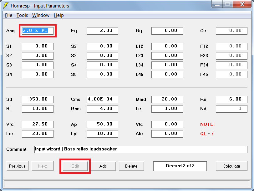

When you first install Hornresp and come up to the main screen you can't edit the default driver because it is disabled / greyed out. So like any new user might you use the wizard to create a new speaker (since there is a note on load up now), then once you have done that and come back to the main screen, the edit button is still disabled / greyed out. It is only after you click Previous to go back to the first record, then click Next to go to your current record that the Edit button becomes enabled / usable.
The Edit button is disabled / greyed out because the template record that is created using the Input Wizard is already in Edit mode, enabling the user to immediately modify the parameter values to suit their specific design. There is no need to go back to the default first record.
I would have thought that it should be reasonably obvious to most users that the record is in Edit mode, given that all the input boxes apart from Cir, F12, F23, F34, F45 and Nd are enabled, with one of the enabled input boxes (Ang) also being highlighted, as shown in the attached screenprint.
(The Cir, F12, F23, F34, F45 and Nd boxes are not enabled because the values shown in them are determined by Hornresp rather than being entered by the user).

Except for the little problem that you can't...The Edit button is disabled / greyed out because the template record that is created using the Input Wizard is already in Edit mode, enabling the user to immediately modify the parameter values to suit their specific design. There is no need to go back to the default first record.
When you fire up the program for the first time (i.e. no other drivers created), the Edit button is grey out, and the text boxes are greyed out / disabled. Even after you run Calculate and go to Window and click Input Parameters to get back to the main screen everything is still disabled.
The only way to get access to the parameters on the screen is to click Help >> Input Wizard and run through the multiple steps of the wizard to create a second entry. It is only then that the text boxes become enabled allowing you to start doing what you want to do.
If you close the program at that point and reopen it you are faced with the exact same scenario of disabled text boxes, except this time you have a second record, so now you can press Next button to get to the second record and the Edit button becomes enabled for you to press and start doing what you want to do in the first place.
Now some might consider that easier than clicking on File >>> Edit but I don't think I am one of them. Hence why after 12 years of periodically trying to get it to work I am giving it away as a bad joke. As the developer you have the right to do whatever illogical things you want, but please don't try and justify it as being easy to use as it has never been that.
I don't know your reasoning for wanting it to be harder than it needs to be, but as a fellow programmer I respect your right to do so. I wish you ll the luck in the world in your future development, it is just a pity that I couldn't get it to work as it looks like it has real potential, and why I have tried so long to get it to work, and even sadder to have to walk away, but I have invested enough time for no return.
Edit: Just noticed in your picture you have clicked on the box not the driver. The box isn't the first thing you need to change the default driver is.
Additional Edit: By having to run through the wizard using the default driver you have to create a box you don't need to put in the parameters of the driver you do want to model in, which means you then have to modify the box to suit your desired driver negating the point of the wizard. All which could have been avoided by allowing the user to pick the right driver after load up.
That's because the first record is the default master, and cannot be modified by the user.
Just click the Add button to create a copy of the master record. The new record will be in Edit mode.
If by box you mean the highlighted Ang input box, then I haven't clicked on it. It is automatically highlighted as the first box on the Input Parameters window. You may wish to change the driver parameters first, but I prefer to initially set the desired loudspeaker position by specifying the solid radiation angle.
If you copy drivers to the driver database you can then very quickly paste any of those saved database drivers into the current record (when in Edit mode).
