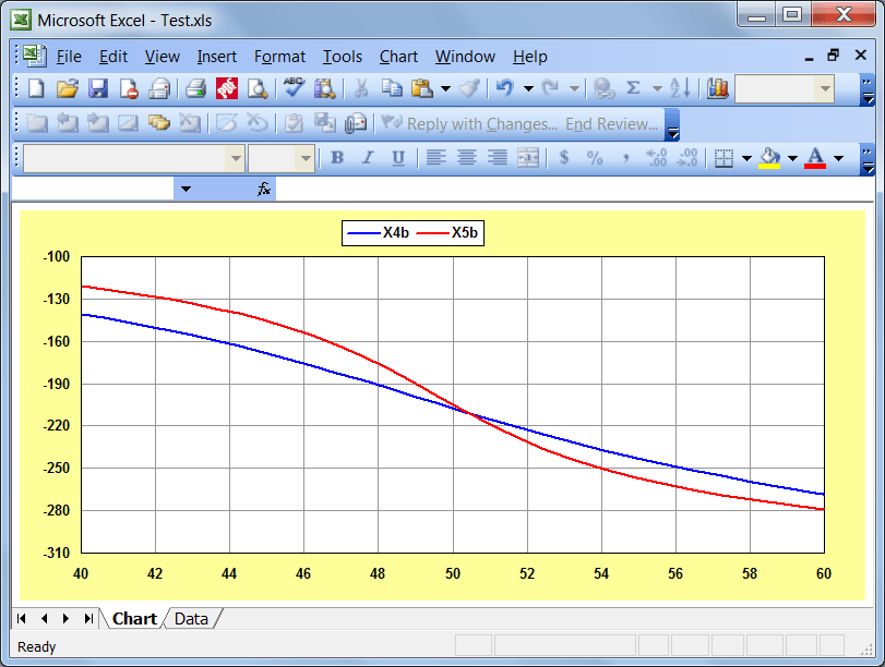

Take a look and the Phase comparison between the models X4b and X5b, they ate basically the same in the 40hz~60Hz range but the group delay is much higher for X5b.
The attached chart compares the unwrapped phase of models X4b and X5b between 40 Hz and 60 Hz, plotted on a linear scale.
The inflection points of both traces are at 50 Hz (a different frequency to where the two traces cross). The peaks in the group delay response comparison shown in Post #13,834 are at the inflection point frequency, as expected. The X5b group delay peak is higher because the phase is changing at a greater rate than for X4b, as shown in the attachment.

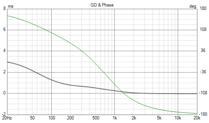

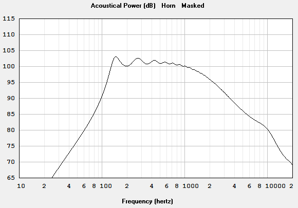

Just out of interest, what then would be the group delay for the attached response?
If you can remove the lowpass filter, because that would change things so drastically.
There is no point of reference atm.
This looks like an open baffle?
With first a 6dB/oct slope followed by 12dB/oct.
In that case that really complicates things, since the Fs of both filter curves are at a different frequencies.
I was talking about just a single 2nd/3rd order system.
(would also work with higher order systems)
Although I guess you can work with curve fitting algorithms (gradient descent method or so) here to determine both slopes, Fs of all filters as well as the Q-factor eventually. From there you can calculate the GD no problem.
You can also do this manually, a result is shown here.
But because of the lowpass filter, it's kinda hard to determine and curve fit, because you don't have a reference point anymore.
In a case of just a 2nd/3rd order system (like a closed box or so), you can first determine the slope, than the Fs point, followed by determining the Q-factor. Group-delay can be calculated from there.
Thanks a lot David, That make things clear to me.
have a good day.

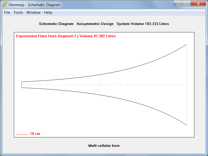

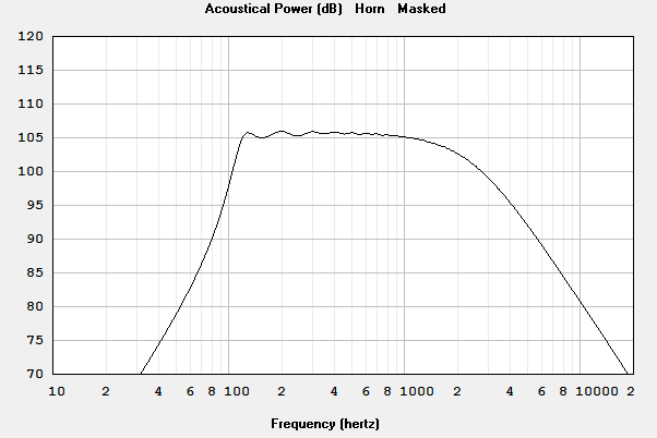

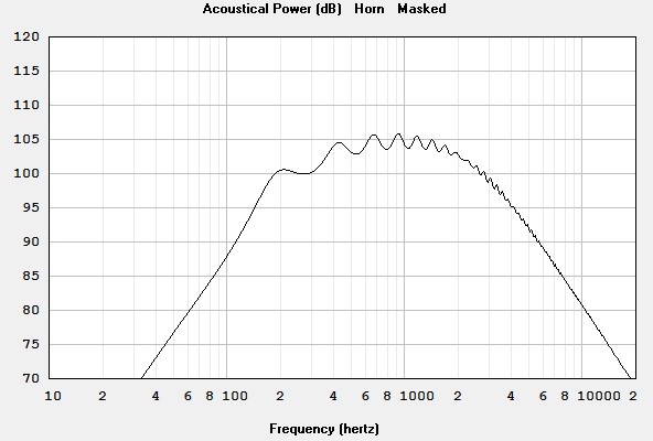

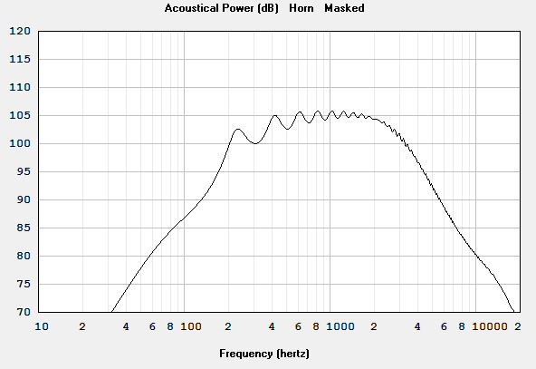

I am finally designing the multicell horn we discussed some weeks ago.
Objective: 15 cell exponential multicell horn, with good linear power response from 200 to 1k, cut off at about 100Hz, about 140cm long, based on previously designed exponential horn with similar figures.
So I approached this variation by designing three elements which I have been evalutating in horn resp, before being joined into a single horn.
The first part of the horn has an exponential flare since it is derived from the previously designed exponential horn which had an F12 of 93 Hz and a total lenght of 140cm.
This horn was "cut" at 62 cm where it will be joined with the multicell horn. The reason why it was cut exactly at 62cm is because the surface at that lenght is perfect (dimensional) match to the throat surface of the multicell (15 cells). Think of this part of the horn like a 62 cm long adapter so let's call this "adapter".
Based on Bjorn and David suggestions of some weeks ago, I modeled the single cells so they have an exponential flare and a cut off (F12) low enough for the purpose, I came up with F12 115 Hz, a lenght of 75cm, S1=16 (4x4cm), F2=256 (16x16). Let's call this "single cell".
When I multiply the throat and mouth dimensions of the single cell X 15 i get a total throat surface of 16x15=240cm and a mouth surface of 256x15=3840.
So I have designed an exponential horn with those data S1 240, S2 3840, 75cm long which represents the multicell array to be joined to the first part of the horn (the adapter). As expected the F12 value is the same as the single cells (115 Hz) but the power response is of course different, Lets call this "array"
I have then joined the "adapter" and the "array" into a two segment horn where both segments are exponential but different shape.
The first segment (adapter) has an F12 of 85Hz, the second part (array) has an F23 of 115Hz.
The power response of the "assembled" horn is good for the intended purpose (a multicell horn with a cut off of about 100 Hz which is usable from about to 200 to 1k).
However I am not sure if this procedure is correct, also because the actual shape of the array appears to be different when I draw it in CAD vs the Hornresp data preview, if such preview is dimensionally reliable (which I have some doubts since the 10cm scale, in the preview picture is not proportioned to the size of the previewed horn.

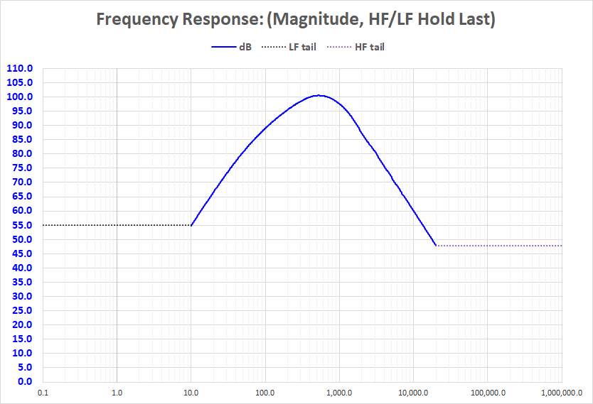

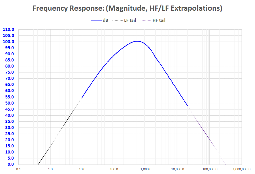

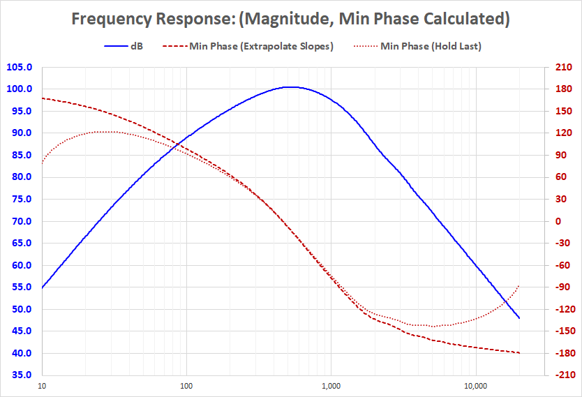

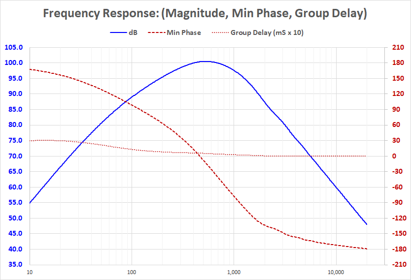

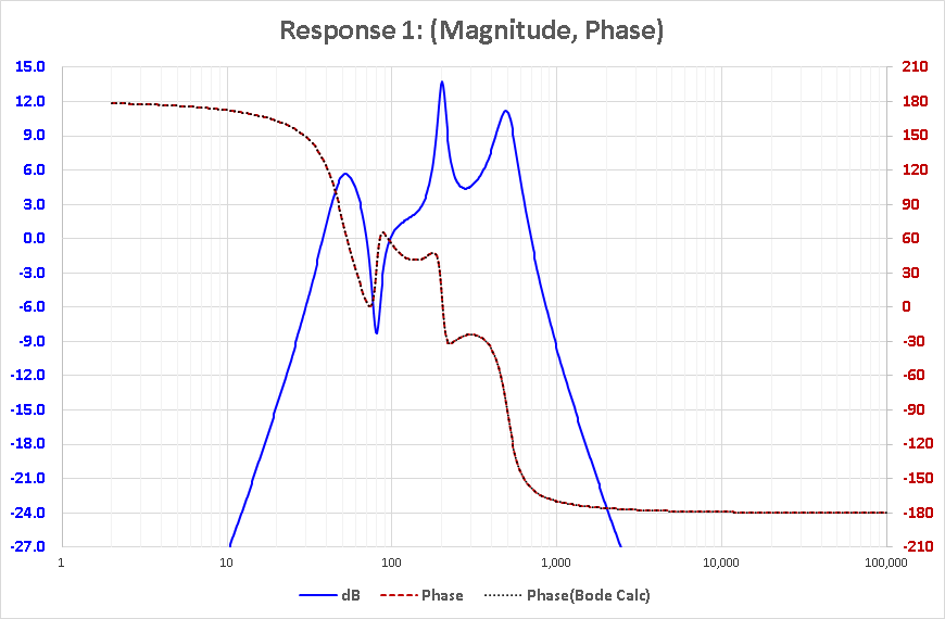

Not sure the extent of your interest, but as you know group delay is calculated from phase, and for a minimum phase system there is one and only one phase response that is associated with(and can be calculated from) any given amplitude response. The caveat is that for perfect calculation of phase from amplitude you need to know the amplitude response for at least 8-10 octaves above and below the frequency you are calculating the phase at. Fortunately most electronics and loudspeakers have relatively well defined HF and LF roll-off slopes. The method of calculation was first described by Bode back in the 40s:
For the example you posted, both the HF and LF tails slope off at +/-12dB/oct so the derivatives of the response are constant below 10Hz and above 20kHz. This allows performing the calculation with a fair degree of accuracy Here is what I get with the tails defined as shown:
For comparison, suppose instead of sloping tails, we held last value above and below your defined response. You can see the calculated phase starts to diverge as you move away from the center toward the bad extrapolations.

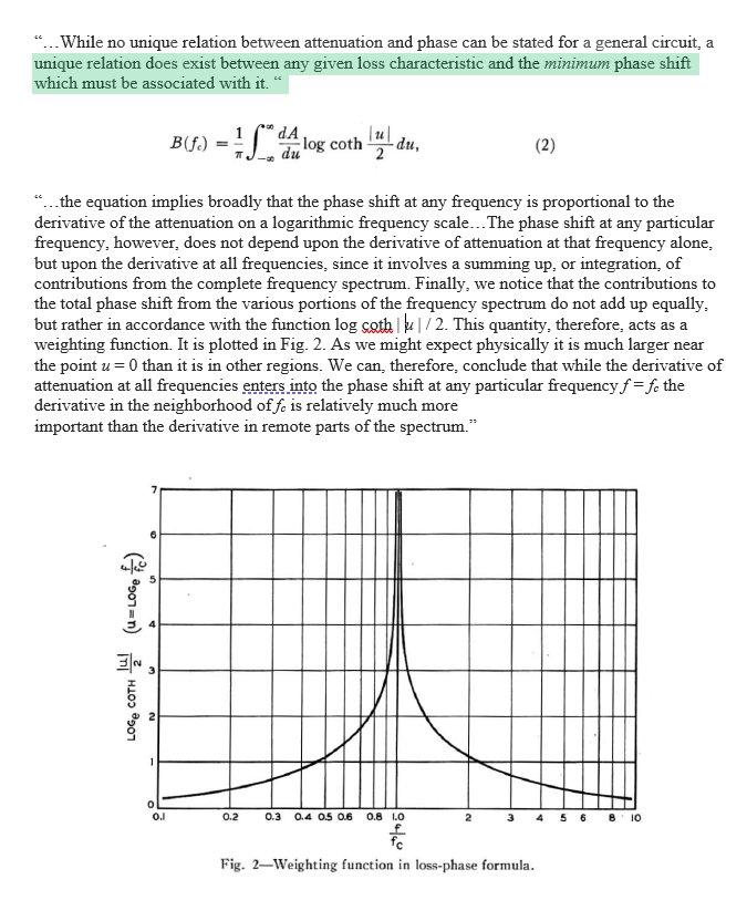

It may also be of interest that VituixCAD includes this method of minimum phase "extraction" as a calculation tool
diyAudio member CharlieLaub also developed a spreadsheet that included this method of minimum phase calculation.
https://www.diyaudio.com/community/...d-minphase-extractor-tool.214713/post-3064074
http://audio.claub.net/software/FRD_Blender/Blender.html
https://techtalk.parts-express.com/...he-hilbert-transform-or-the-dft-fft#post51349
https://techtalk.parts-express.com/...one-explain-the-hilbert-transform#post1380982
  • Bode 1940.pdf

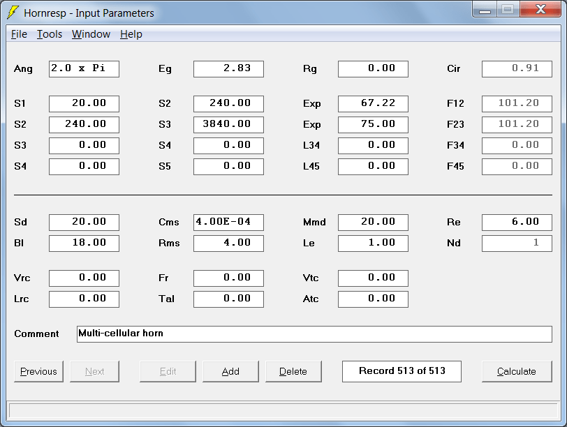

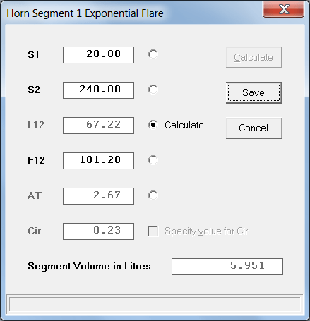

Why not match the two cutoff frequencies exactly?
Using the multi-cellular horn design as the reference starting point:
S2 = 4 * 4 * 15 = 240 cm^2
S3 = 16 * 16 * 15 = 3840 cm^2
L23 = 75 cm
Gives F23 = 101.20 Hz
To design the adaptor, use the Horn Segment Wizard to calculate L12:
For the purposes of the exercise assume S1 = 20 cm^2
(Use the actual required throat area in your calculations)
S2 = 240 cm ^2
F12 = 101.20 Hz
Gives L12 = 67.22 cm
(For this exercise only, assuming S1 = 20 cm^2)
I think you will find that the Hornresp scaling is exactly correct :).
The axial length of the horn is 75 + 67.22 = 142.22 cm or 14.222 times the length of the red 10 cm line shown on the schematic diagram. You can manually check this for yourself.

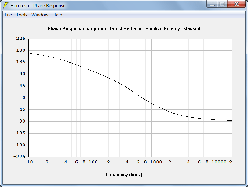

Hi bolserst,
Many thanks for your post - I learn something new every day!
Just for the record, the phase and group delay results calculated by Hornresp for the posted example, are attached.
View attachment 1205499 View attachment 1205500
View attachment 1205501 View attachment 1205502
That was basically what I meant :)
Totally forgot about the name Hilbert transform. It's been ages that I actively worked with those. (back at the control theory courses)
If I remember well, these still don't work super well with very erratic frequency responses?
The data posted was for a driver having a constant input voltage and radiating into half space, mounted in a closed-box enclosure. No filtering was applied.
I guess that's the Le we're looking at.
I personally always design without Le first. Reason being that it sometimes can give a bit of a skewed impression about what's possible from a system design perspective.
It also makes it sometimes very difficult to compare different speakers.
In this case it gave a bit of a false impression of what was really going on because of that 6dB/oct (kinda) initial slope.
After I am satisfied with a certain design, I will add the Le to see if it messes anything up.
As long as it is a minimum phase process, and has well defined HF and LF slopes it will work well.
Do you have an example you think might be troublesome?
Here is sample with several closely spaced peaks and nulls, and you can see the phase calculated from the amplitude response matches well.
