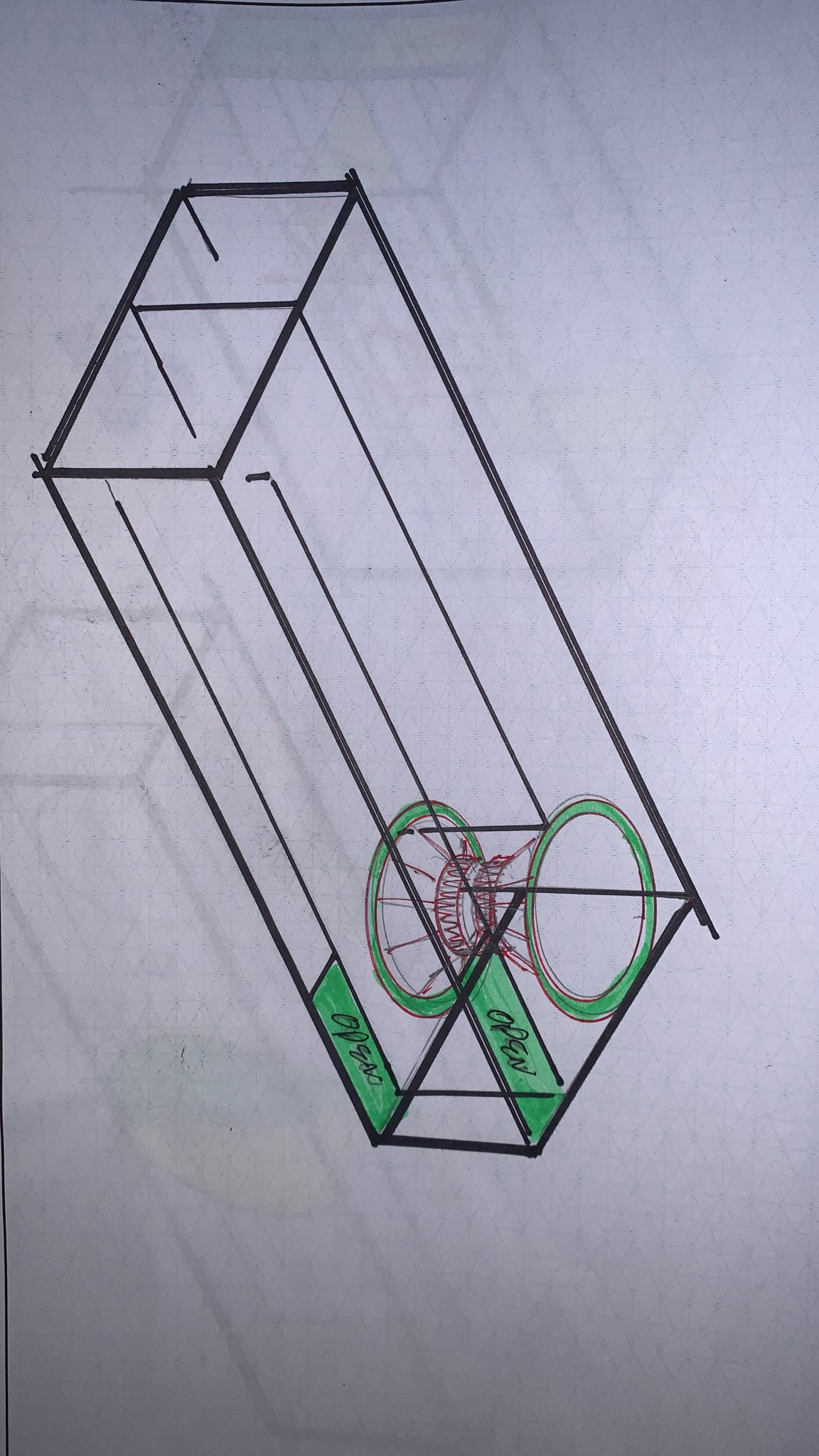

veloplex, I think if you attempt to get both drivers on the ‘3/4’ resonance it works best?

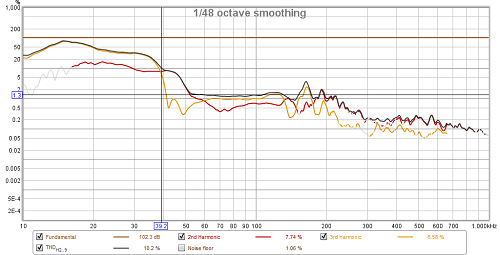

The 4th order BP limits excursion in-band. Also, the vent acts as a distortion filter (and from one of my measurements, it's pretty good at that - I've attached the distortion curves for one of my builds - not that this was taken at 70W input - the rated RMS of the driver used in this build. Note that the peak in the THD between 100 Hz to 200 Hz was caused by a loose x-over board in the enclosure, which I subsequently fixed.

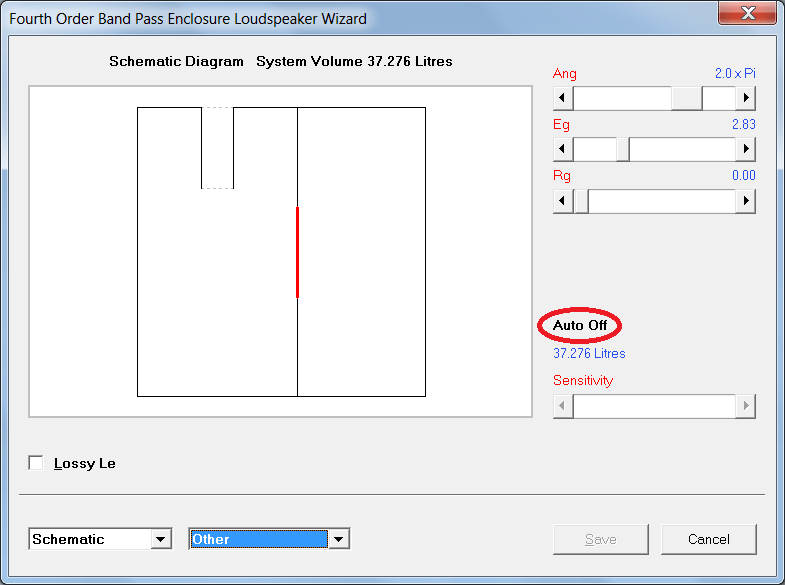

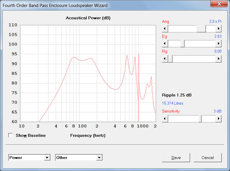

Hornresp Update 5470-230805
Hi Everyone,
CHANGE
BP4 band pass loudspeaker dimensions can now be automatically calculated for a given passband ripple and sensitivity by selecting the Other input option in the Loudspeaker Wizard, double-clicking the Auto Off label and specifying the desired ripple magnitude and sensitivity. The method used is documented in the Vance Dickason Loudspeaker Design Cookbook.
Kind regards,
David
