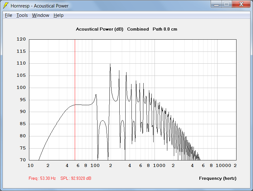

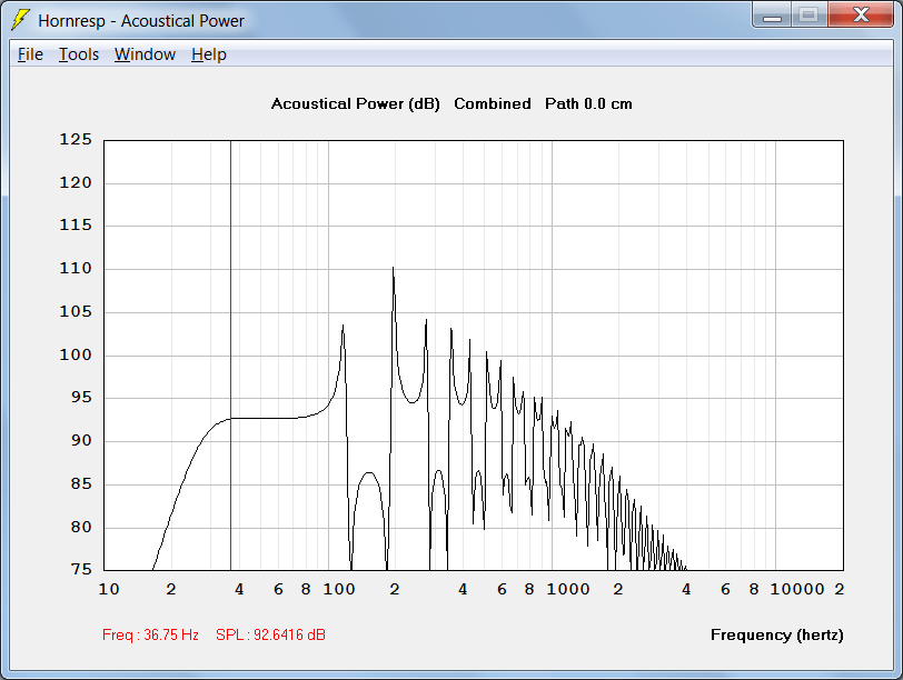

Hi Giri, GM and Brian,
Thanks for all the information. It seems that we can get different answers depending on which set of rules we choose to adopt .
I have compared Martin's 2006 and 2021 methods and it seems that the 2006 method produces the better results. With the same driver, taper rate of 0.2 and no driver offset, Attachment 1 shows the result obtained using the 2006 method and Attachment 2 shows the result obtained using the 2021 method.
Interestingly, in working through the 2021 paper I think that I may have found an error. Martin calculates the taper volume using the formula:
Vb = 0.5 * (S0 + SL) * L
This assumes that the cross-sectional area tapers linearly, but it is the radius, not the area, that actually tapers linearly. The correct formula to use for an axisymmetric conical segment is:
Vb = Pi * L * (R0 ^ 2 + R0 * RL + RL ^ 2) / 3

Thinking about it some more I suspect that Martin is probably assuming a parabolic rather than a conical profile for the transmission line, which makes good sense. In that case the cross-sectional area changes linearly with length, and his volume formula will be correct .Interestingly, in working through the 2021 paper I think that I may have found an error.
Switching from Con to Par makes very little difference to the results shown above, though.
Thinks, while academically useful, I don't think anyone should really aim to build and end-loaded TL, due to the impact of the the 3*Fb harmonic on the passband of the TL. That's why I suggested an approach that produces an offset TL with a wider passband instead. Interestingly, you can change the exponent part of the equation for Vb a bit and still end up with an offset TL with a flat passband. For example, if you use Vb=20*Qts^3*Vas instead of Vb=20*Qts^3.3*Vas, you end up with a larger offset TL with a lower Fb.
If you can work out how to include taper then your model will most likely become the best that there is. Considering its relative simplicity compared to Martin's two models, it already produces very impressive results.It should be possible to develop this even further (translate to a tapered TL) by taking the harmonic resonance as an input value and using that to determine the required taper to achieve Fb and that harmonic resonance.
