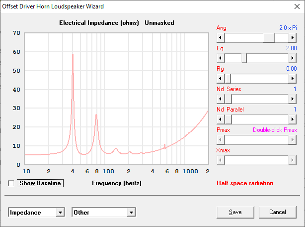

See attached - is that the impedance curve of a bandpass subwoofer or a front-loaded horn? Looks like two big humps to me
And the interior of the humps is filled in mostly by harmonics generated in the system.
That makes no sense to me. With my bandpass builds, I put 50 Hz in, I get 50 Hz out. Very little harmonics, and what there is in harmonics is distortion, not something generated by the design itself. Actually good bandpass systems are characterized by having LESS HD than equivalent direct systems like sealed and vented using the same driver - a positive feature of the acoustic filter.
I understand your two bumps. That's impedance. Not the same thing as I am talking about.
I'm referring to the frequency response.

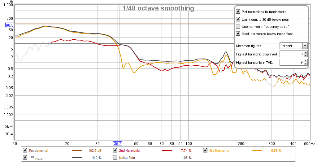

I've actually built and measured some bandpass systems as well.
They feature LESS distortion than direct systems like sealed or vented. Because of the acoustic bandpass. Here's one example, driven at its PEAK design voltage. Notice the THD throughout its passband and down to the end of its design passband (40 Hz). Notice that it only starts rising below 50 Hz? That's a direct result of the system's upper passband limit of just over 100 Hz. Any signal above 50 Hz is going to have harmonics above 100 Hz, and they will all be reduced by the acoustic filter's effective LP at just above 100 Hz.
The "gap being filled in by harmonics" simply makes no sense at all.
I don't know what you were hearing, but if it was a well-designed bandpass system, I'm pretty sure that it was not distortion. At least not harmonic distortion. Again, more likely it was the out of band resonances. If you were doing this 30 years ago, the tools available at the time would likely have been lumped-mass modeling tools that could not model those resonances, and therefore there was no easy way for adjusting the design to minimize them.
