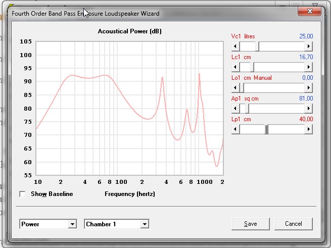

Hi David
I did try and have the bandpass, however in past I did see the picture change with sliders, like the box volume, that way I did see where that slider was for.
Now it just go yellow but do not change when slider is adjusted.
Is this just oke, or did I find a bug.
Also I get error when saving record and program did exit.
When go to Lo1 slider the bos disappear to a small line, not shure it is a fault..

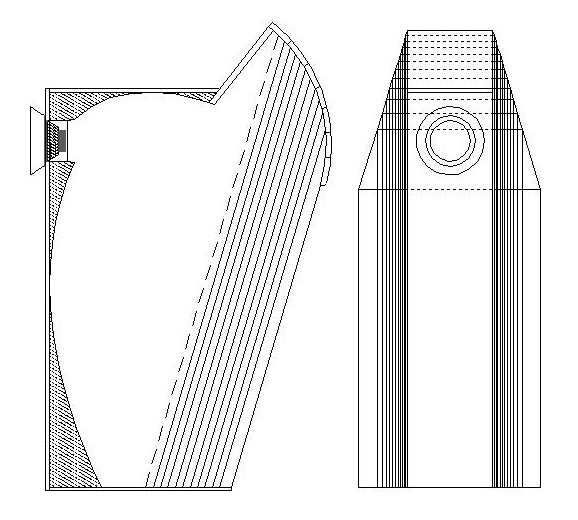

Hi Newracer! Do you have an idea what type of cabinet design you would like ... ?
Hi Sharky! I do have a general idea. I'm trying to squeeze as much of the linearly-expanding BLH into a cabinet similar in dimension/aspect ratios to a Klipsch tower, and then remainder of the horn fires out the back toward a boundary wall by way of a bell that flares horizontally, reducing the aspect ratio toward a shorter, wider rectangle.
The crux of what I'd like to know first is, apart from the horn length question, whether folding to preserve volume is the first priority.
Attached is a previous attempt, with a side and front elevation, if it helps. This design increased the horn length from the Hornresp inputs by about 20%.

Hi Kees,
You are imagining things, that was never the case for band pass type systems .
That's how you know what the slider is for.
It appears that the record has been corrupted. I have no idea how people are managing to do this. I have never corrupted a record, no matter how hard I try.
It's not a fault, its because some of the values you have specified are unrealistically small (ie. 0,10 and 0,01).
The first priority should be to preserve the rate of cross-sectional area expansion along the axial length of the folded horn wherever possible.

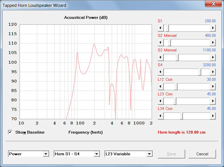

On the wish list, two cells with the f3 and f6 numbers presented on the Power and Schematic menus in the Loudspeaker wizard.
It's not going to happen .
Determining the fundamental resonance frequency from the electrical impedance or diaphragm displacement is as far as I am prepared to go.
The f3 and f6 numbers sometimes have to be judgement calls - for example, where would you place the -3dB and -6dB frequency points in the attached response?
Ah, that is different from what I've been doing, but easier for me, actually. Thanks for that nugget, David!

I get rather frustrated to trying to se the smaller changes in the spl curve while doing minor adjustment
There are limits on the accuracy of the Hornresp predictions. If the changes in the power response are becoming so small that they are difficult to see, then any further "fine tuning" is unlikely to have a material effect on the measured results of the final constructed system anyway. Monitoring the fundamental resonance frequency value should in most cases be sufficient.

Hi Kees,
Kind regards,
David
Oke David thanks.
I have never did a bandpass, but did the other systems where I did see the change of the box with the sliders, that is reason why I thought that this was a error. But oke now I now and problem solved, sorry that I did doubt your beautifull program.
The corruption of the file, as you say your run never into it I presume it is just a pc writing error on disk as windows is a terrible multitasking options, when double writes occur, most because of a interacting with some other software.
I had this just once by the way.
