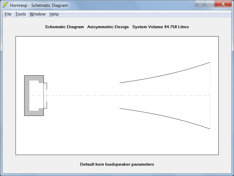

Hi Everyone,
This update has required extensive modifications to the program, and it is possible that something has been missed / overlooked during testing. Could you please report any bugs.
CHANGE 1

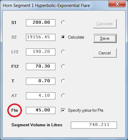

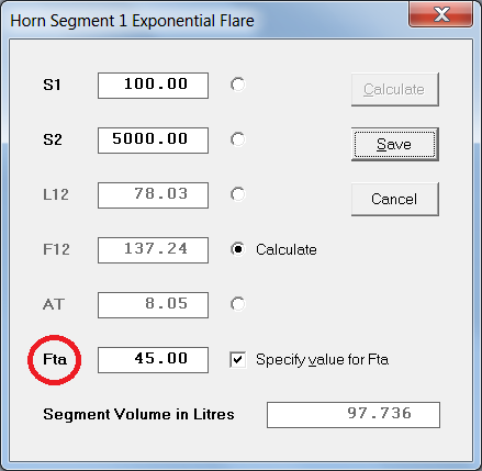

When the Horn Segment Wizard is used with an exponential or hyperbolic-exponential segment, double-clicking on the Cir label now changes the parameter from Cir to Fta, which means that the Horn Segment Wizard can now calculate both the throat entry half-angle AT and the mouth flare tangent angle Fta for all horn segment flare types. Post #10419 and Attachments 1 and 2 refer.
CHANGE 2

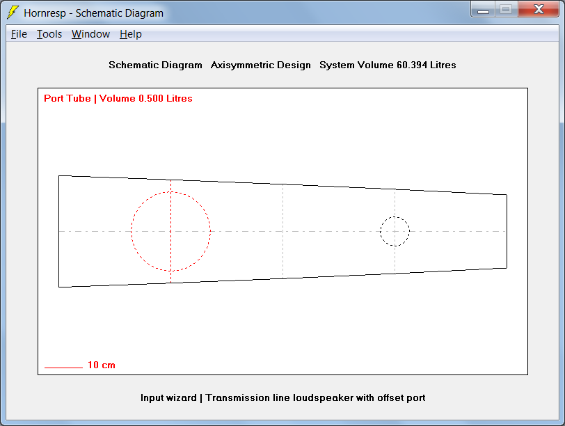

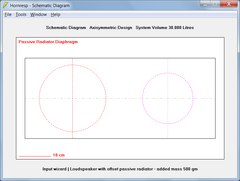

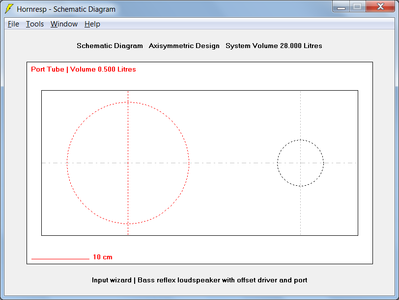

A loudspeaker with an offset driver can now also have an offset port, an offset passive radiator or an offset stub.
Method:
1. Specify at least three segments, select the OD offset driver option and double-click the Cir or Fta label in edit mode to select the Clo closed horn mouth option. Set Vrc, Lrc, Vtc and Atc = 0.
2. Specify an offset port using Ap and Lpt, a passive radiator using Sp, Cmp, Mmp and Rmp, or an offset stub using Ap1 and Lp.
For further information see the following entries in the Loudspeaker Models section of the Help file:
Direct Radiator in a Closed-Box Enclosure With Offset Driver and Stub
Direct Radiator in a Closed-Box Enclosure With Offset Passive Radiator
Direct Radiator in a Vented-Box Enclosure With Offset Port
Damped Transmission Line Enclosure with Offset Port
Representative examples of the above four systems can be generated using the Input Wizard. Attachments 3, 4, 5 and 6 refer.
CHANGE 3

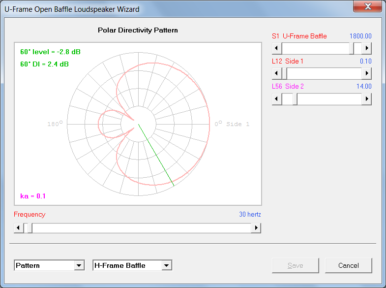

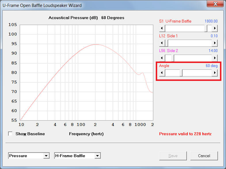

The H-Frame Loudspeaker Wizard pressure response chart can now be calculated at any specified angle between 0 and 180 degrees, not just at the 0 and 180 degree limits. Attachment 7 refers.
CHANGE 4
The H-Frame Loudspeaker Wizard now includes a directivity pattern. Attachment 8 refers.
BUG FIX 1
The overflow error problem detailed in Post #10425 has now been fixed. My thanks to Jack (nc535) for reporting the bug.
BUG FIX 2
The H-Frame Loudspeaker Wizard allowed the S1 slider control to have a baffle area value less than the driver diaphragm area, which was causing the wizard to operate incorrectly. This has now been fixed - it is no longer possible for S1 to be less than the diaphragm area.
BUG FIX 3
If a U-Frame loudspeaker record was selected, and the schematic diagram of another record then displayed, if the "U" baffles were on the left-hand side, segment 1 was not being shown in the second record. Attachment 9 refers. This bug has now been fixed.
Kind regards,
David

CHANGE 1
Method:

CHANGE 4
