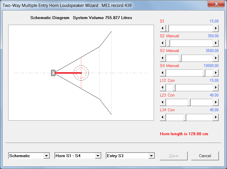

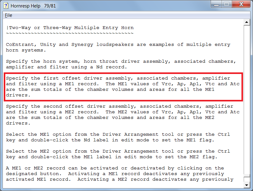

I am trying to model a two-way MEH using HornResp. I intend to use a large format compression driver and two 15” woofers wired in parallel and mounted on each side of a large horn (Klipsch K-402). I will use two entry ports per woofer (i.e., 4 in total on each horn).
In the MEH input file, I shall specify Ap1 = the 'throat port cross-sectional area' [for the off-set woofers].
Q1: Is the Ap1 value to be inserted, the TOTAL throat port cross-sectional area for all 4 entry ports (or just for the two ports per driver)?
Q2: I have to specify the number of drivers for the MEH1. In my case, would that then be ‘2P’? [since I use two woofers wired in parallel per horn]
Thanks!

Hi Peter,
The Ap1 value should be the total throat port cross-sectional area for all 4 entry ports.
Yes, the ME1 record should specify 2P.

Modeling MEHs using HornResp
Hi David,
1. How (and where) in HornResp do I specify the distance between the entry ports for the mids and the compression driver throat?
2. And is this distance, the distance to the center of the mid entry, or to the first edge?
Thanks!

Hi Peter,
If the mid frequency drivers are located in the S2 plane, then the distance is given by L12 in the Nd record. If the drivers are located in the S3 plane, then the distance is given by L12 + L23, as shown by the red line in the attachment.
It is the distance to the centre of the entry port.
(If a driver has 2 ports each of area A, then Hornresp assumes a single composite port of area 2 x A, centred on the driver axis).
