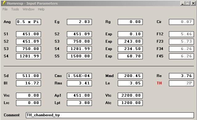

Hi David,
I noticed today, that when changing the port area for a throat chamber in a tapped horn from its original value (Ap1~S2) to zero the SPL response does not change.
Could there be another "bug"? :)
V.: 2500-100108
Hi Oliver,
Using your example, if you look carefully as you compare SPL Response chart results, you will see a very slight difference between Ap1 = 451 and Ap1 = 0. The two curves are not exactly superimposed.
Better still, use the Tapped Horn Wizard to view the response and then the schematic, as the Ap1 slider is moved. This will better illustrate how altering Ap1 affects the results. Note in particular that Ap1 = 0.1 is something completely different to Ap1 = 0 (in both the schematic and the response).
Hope this helps to clarify things.
Kind regards,
David

Post #954/#955 Ap1_Throat Chamber Exit Area
Hi David,
I noticed the very slight difference between blocked and normal throat chamber; but, as Ap1 is the "Tapped horn throat chamber port cross-sectional area [sq cm], this would mean that the difference between a tapped horn with normal functionality (i.e.: both front and back of the driver energizing the horn) has an almost identical output to a non-tapped horn where the back (throat) side of the driver is blocked off from the horn, and additionally enclosed in a closed small back chamber. A small sealed back-chamber should definitely impact the response, e.g.: the diaphragm displacement, etc..
This just does not sound correct to me, I guess I'm just missing something.
