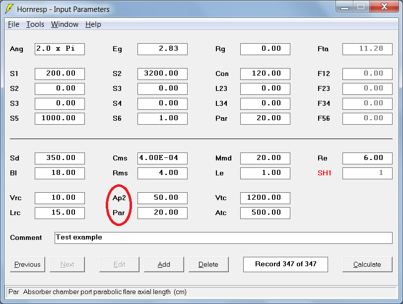

CHANGE 1
The flare of a throat adaptor in a stubbed horn design can now be changed in the Loudspeaker Wizard. My thanks to Damien for his Post #9508 identifying this oversight.

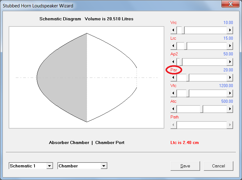

CHANGE 2
The flare of an absorber chamber port can now be changed on the Input Parameters window and in the Loudspeaker Wizard (specify Lp or Cyl if a standard cylindrical port is required). The two attachments refer.

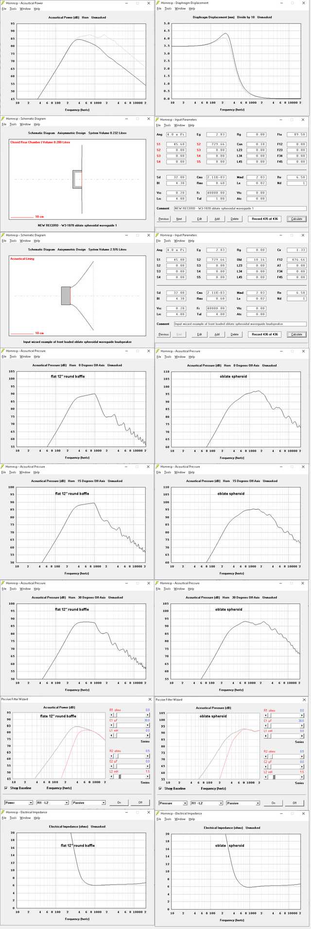

hi David - in the sim of a 12" diameter flat baffle (maybe that's not correct ?) vs 12" diameter oblate spheroid, spl is always lile 12dB greater for the waveguide up to 20KHz and 30 off axis. Am I missing something in thinking they should be more alike up high in frequency and off axis ? (sorry for the stupid question)
https://i.imgur.com/evKnih9.png
in the sim of a 12" diameter flat baffle vs 12" diameter oblate spheroid
Hi Fred,
As far as Hornresp is concerned, you are comparing a conical horn of axial length 0.1 cm to an oblate spheroidal waveguide of axial length 10.16 cm. The theoretical power and pressure responses of the two systems will be quite different.
Using a very short horn to approximate a direct radiator in an open baffle will not give particularly satisfactory results. There are limits on how far you can "push the envelope" with the Hornresp models .

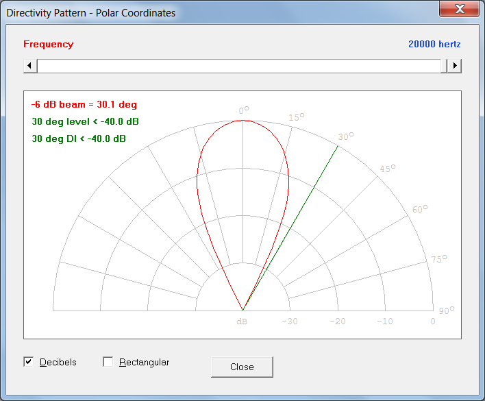

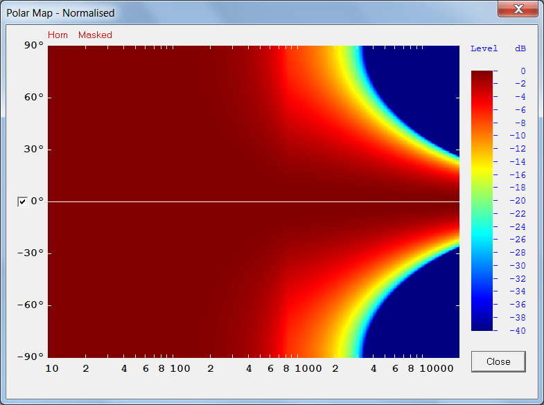

David - when comparing a 3 inch fullrange on two "similar size" horns, the oblate-spheroid horn shows similar power to the equivalent size exponential horn yet the oblate spheroid is showing 100 degrees beamwidth all the way to 20KHz while the exponential horn has narrowed to `42 degrees by 10KHz and 30 degrees beamwidth by 20KHZ. Why would they be so different? When examining such a horn/driver case with hornresp, should one perhaps limit how high to examine for realistic result?
the 100 degrees indicates constant directivity characteristics (?) while the exponential is progressively beaming.
I'm apparently misunderstanding a fair amount ;^(
Hi Fred,
As advised on previous occasions, the Hornresp directivity models are relatively simple, and the results should be considered as indicative only. An exponential horn will "beam" at higher frequencies whereas an OSW acts more like a conical horn in that it will exhibit constant directivity characteristics. This is what Hornresp attempts to show - see the attached comparison using your two test example horns.
In reality the 3" driver diaphragm will not act as rigid piston up to 20KHz anyway, so the actual pressure response will be somewhat different, regardless of what any predictions may suggest.
You would really need to use full-blown finite element analysis techniques to accurately predict the pressure response. Calculations would take several hours to complete if you wanted to fully analyse up to 20Khz. I don't have the patience for that - I have the attention span of a mosquito .

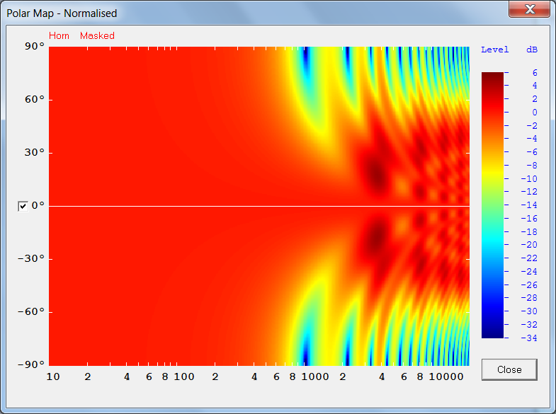

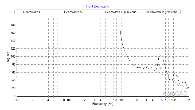

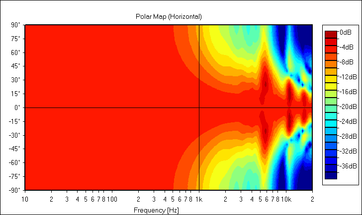

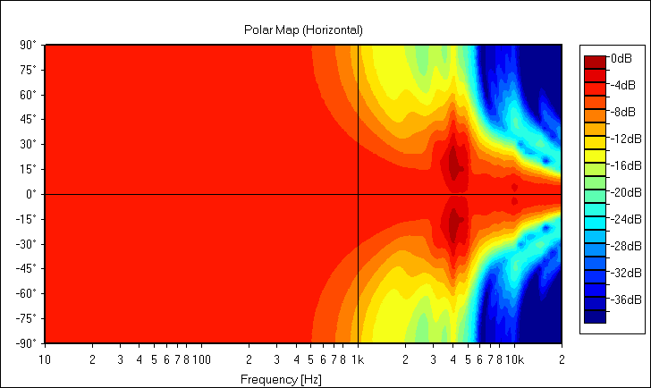

As David explained, the Hornresp directivity models are quite simple. To properly calculate the directivity of a horn, you need to know the distribution of particle velocity at the mouth (iow, the shape of the wave front), and for that you also need a more complex model of the horn itself. So Hornresp isn't really suited to tweaking the horn shape for high frequency directivity optimisation.
I simulated the directivity of your two horns using the Mode Matching Method, assuming the horn is mounted in an infinite baffle (no, or finite, baffle would require diffraction modelling, which I haven't fully implemented yet). They are not very different. Which isn't that surprising when you compare the profiles.
Below about 1.5kHz, neither horn can control directivity, and they behave the same. Above 5kHz, the large throat takes over control, and they behave the same. You have a small range where they are different. See Attachment 1.
The normalized polar maps also show that the OS has more of an on-axis dip. See Attachments 2 and 3 (Exp and OS)

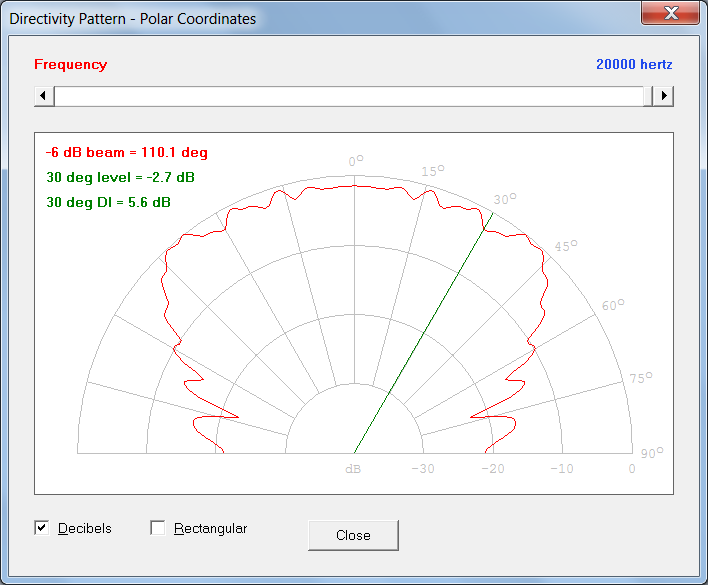

Since the driver is smaller than the horn throat, it will excite modes here, which will mess up directivity some more. See Attachments 4 and 5, these are for the exponential horn with a 32cm2 piston source driving the 45cm2 throat.
Also you have the complication of the shape of the cone and the breakup modes of the diaphragm. Now we are getting into the domain of fully coupled FEA...

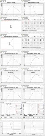

Just to compare, the Hornresp-generated equivalents are attached - clearly quite different .
Hi Fred,
It's no secret that Hornresp is definitely more comfortable when calculating the power responses of bass horn systems, rather than attempting to predict high-frequency off-axis pressure responses of mid-range and high-frequency horns .
You are not going to see it analysed in Hornresp, that's for sure... .
