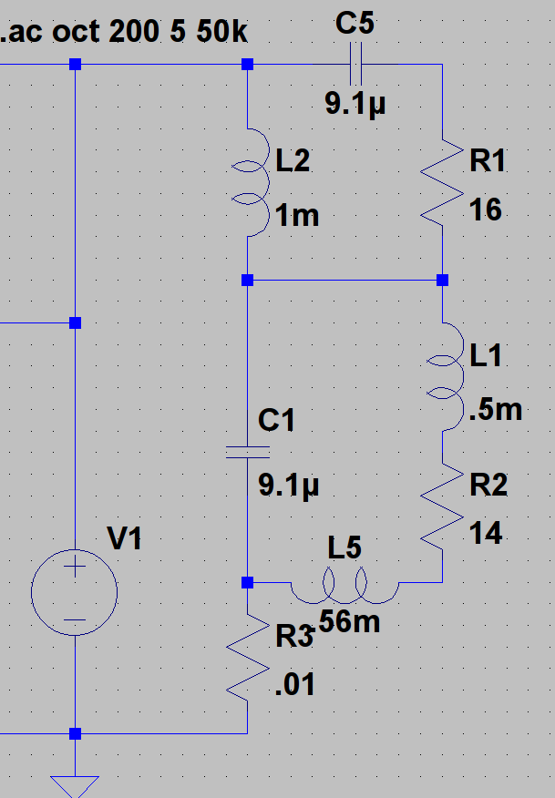

I am looking at series crossovers as discussed in another post in the multiway forum. As I look at the HR filter wizard I don't see any way to simulate the effects of a series crossover. Is this possible as the program now stands? If not how painful would it be to add that capability?
What I have in view...
attachment.php
Note R3 is not a real element but just added for spice to calculate the impedance seen by the amplifier.
The Hornresp filter wizard tool can be used to simulate either the LPF or HPF section shown in the attachment, but not both together in a full series crossover network. That's why the tool name is 'filter wizard' and not 'crossover network wizard' :).
Too painful. It's not going to happen.

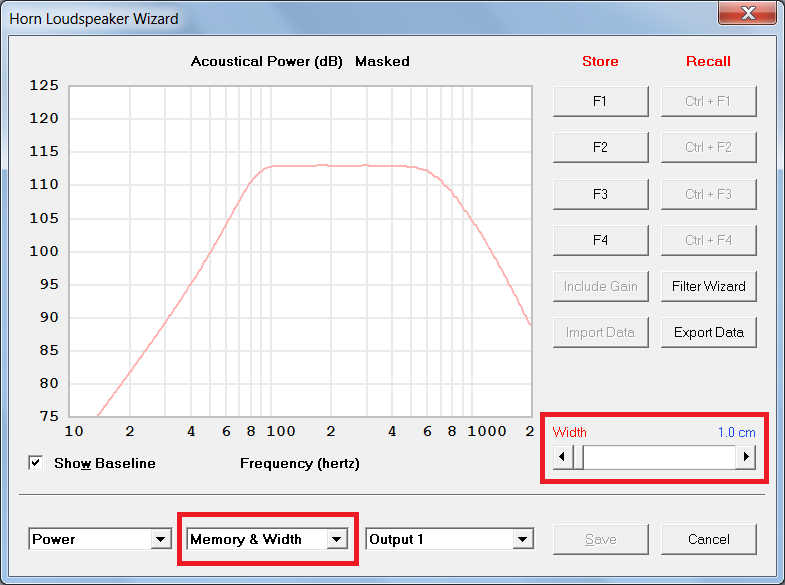

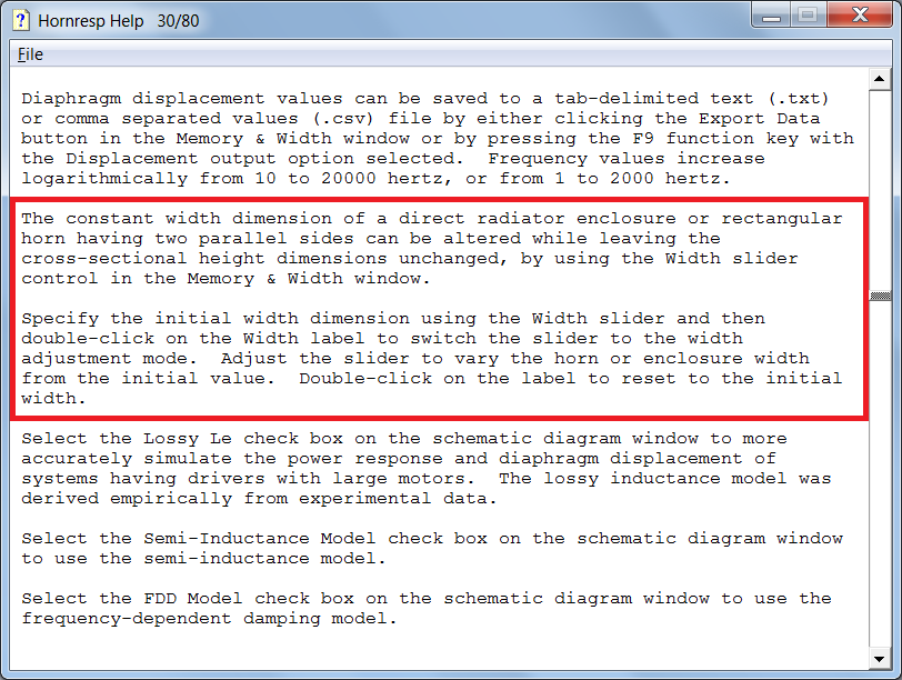

David, I was likely born with a Darwin Award touch and ability to screw up most anything. A question: Is there a procedure to simulate a damped vent box having a series capacitor?
In the upper sim below, the filter wizard didn't seem accessible. A regular 3rd order sealed box is easy and wanted to compare the two cases to see if an aperiodic box has any use with a series cap.
2xpBuX5.png9
Hi Fred,
Sorry, no.
The Filter Wizard can be accessed from the Loudspeaker Wizard "Memory & Width" window, but only the active and parametric equaliser filter options are available.
By accessing the Filter Wizard from the main input screen rather than from the Loudspeaker Wizard it is possible to simulate the box with a capacitor in series, but with the vent undamped.
