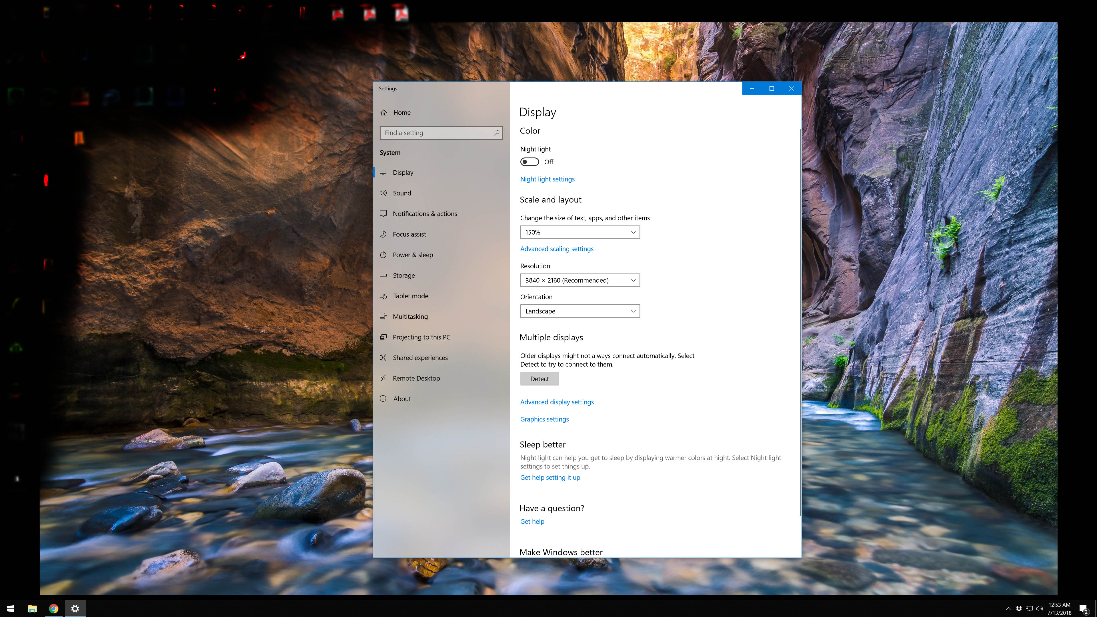

NeoDan, I'm testing your theory. I rotated the pic to landscape on my phone and this is what happens.

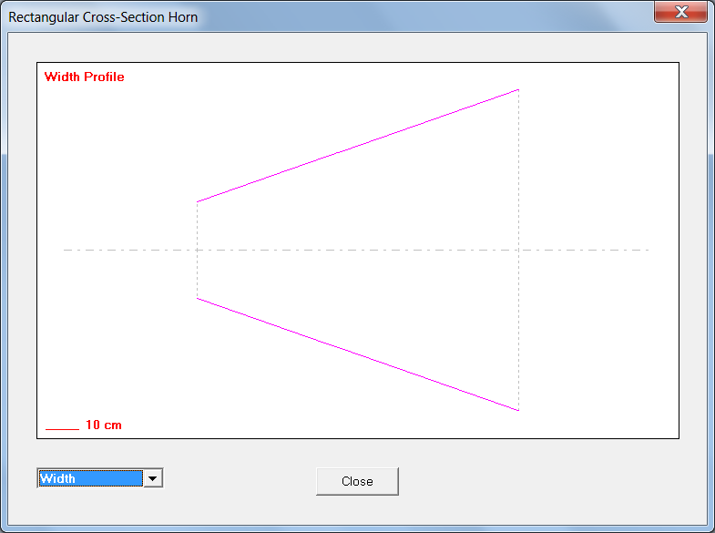

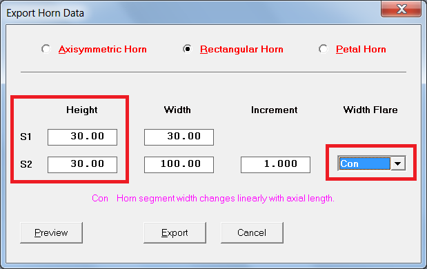

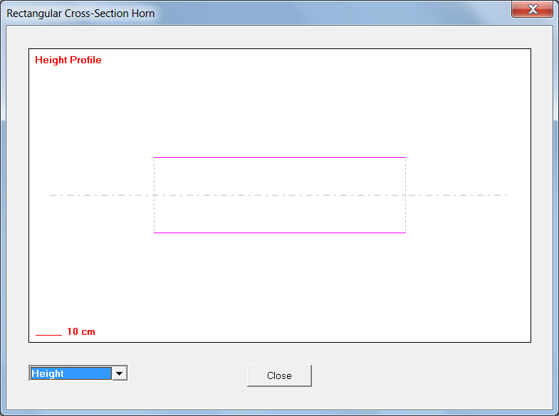

Hi StainlessSteve,
A Par option hasn't been requested before, and for good reason - it would have no application in a practical build.
A rectangular cross-section parabolic horn is normally constructed with two tapered sides and two parallel sides. The Con option should be used in this case. A Par option would not make it easier to convert to a cutsheet, it would in fact make it a lot more difficult.
Select the Con option and set the S1 height equal to the S2 height as shown in attachment 1. The resulting side panel profiles are shown in attachments 2 and 3. The exported data will match these profiles.
Kind regards,
David

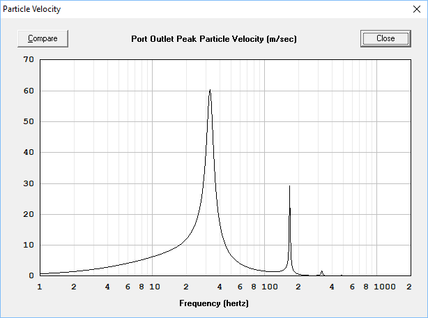

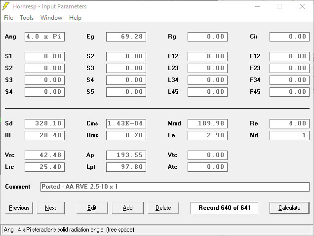

I have an issue I've ran into. When modeling a ML-TL it seemed my vent velocity was much higher than I expected. To sanity check I compared the results from a ported enclosure in WinISD to the same driver/enclosure in HornResp and I'm getting very different vent velocity results. The SPL output and cone excursion is nearly identical between the two, but vent velocity is not. I don't know if I'm doing something wrong somewhere or if its an error/bug in one of the two applications. Based on my past experience I think the numbers WinISD is giving me is fairly accurate. Here are some pics showing my inputs and the difference.

In hornresp change Ang to "2.0 x Pi" and Eg to "34.64" and simulate
Changing the "Ang" doesn't seem to make a difference. If I change the Eg to 34.64 then the port velocity in HornResp is very close to WinISD, however I'm trying to simulate 1200 watts of input power at 4 ohms, not 300 watts. I have 69.3 volts entered into WinISD to get 1200 watts. Why is there a 4x difference in HornResp?

Hi thejessman,
I suspect that WinISD is showing the rms value rather than the peak value, which would explain part of the difference. The other part is likely to be due a problem identified with the WinISD model some time ago - see post linked below.
http://www.diyaudio.com/forums/subwoofers/311268-discrepancy-winisd-hornresponse-2.html#post5169553
I am pretty confident that the Hornresp peak particle velocity calculations are correct :).
:wave: I have no idea what your phone will allow after the photo is taken, I was referring to when you are taking photos. The key is to pay attention and learn to control the camera orientation, you should have a little orientation indicator as pictured below.

From what you said I checked and it looks like WinISD was set to show the peak port velocity.
That's not part of the reason for the discrepancy then, it seems :).
I've already ordered a hot-wire anemometer, I guess I'll see what results I get when it gets here.
Please let us know what you find.
The reason I am pretty confident that the Hornresp peak particle velocity calculations are correct is because the results are the same as those produced by AkAbak :).
