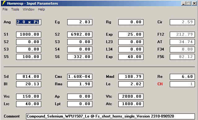

Compound Horn?
Hi David,
The other night I was playing around with the compound horn arrangement, trying to use it for something (think Altec 816) with: 1. short exponential front horn, 2. large vented rear chamber, 3. short exponential rear horn (used as reflex port). This seemed to model just fine (well, the response may well be too fine ). Looking a little closer I found the following:
- there is a point where reducing Area S2 (front horn mouth) by as little as 1cm^2 markedly affects the low end, and
- the same thing happens when reducing Area S6 (rear horn mouth) from the input screen value shown.
I'll attach the input screen for your information. It would be great if the compound horn arrangement could be used reliably for cases like this one.

Hi Oliver,
Many thanks - I certainly do find it interesting!
When I first calculate the combined response for your example, I get a particular result. If I then calculate the combined response again (without changing anything) I get a different result - see attached comparison. There is definitely a bug somewhere .
I will investigate over the next few days, and let you know what I find.
Kind regards,
David
Hi Oliver,
Just letting you know that the bug you reported has been fixed - it only took one keystroke to rectify . I had been using a variable named S2 in a formula when I should have in fact been using S22 (a typographical error on my part). Unfortunately the combined response for your example is now not as impressive as it once was .
Thanks again for bring this bug to my attention - it was causing quite a serious error in the results!
The corrected Hornresp release is Product Number 2310-090924.
Kind regards,
David

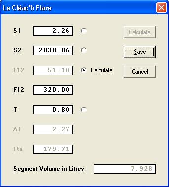

Hi David,
Is it possible that, after you've typed the length in L12 (etc.) the horn flare automatically adjusts to, say conical, instead of requiring the push of that extra button, (like C, H or E) that I regulairy forget?
I know, I know but it just keeps on happening (and resetting)
Best regards Johan
Best regards Johan

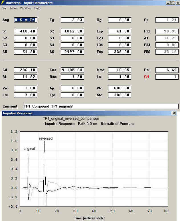

Compound Horn_Post #729
Hi David,
As I said in Post #729 I also had a bit of a problem with a simulation of the Lowther TP1 London. When swapping the horns there was a large difference in the SPL response curves. Your fix - Post #728 - rectified that. There still is a difference, and I would expect some difference. But my guess is that the impulse responses should resemble each other more closely. Also, to compare the impulse responses from different simulations more easily it would help to have control over the Y-axis settings. As you can see, the large negative peak of the original impulse response is way of the page.
Looks like there may be something else here that needs your attention.

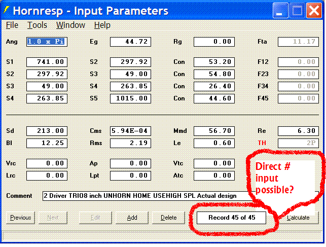

Hello David
Is there any way it would be possible to make it a little easier to go to a saved design by typing the design number in. I'm working on more and more designs and clicking through them all is getting a bit tough. I know that other gentlemen have a great many more designs saved than I do.
Mark
Mark
Is it possible that, after you've typed the length in L12 (etc.) the horn flare automatically adjusts to, say conical, instead of requiring the push of that extra button, (like C, H or E) that I regularly forget?
Hi Johan,
While it is certainly possible, all things considered I would prefer to leave things as they are, with the selection of the initial flare being the responsibility of the user. Sorry, but you are just going to have to learn not to forget .
Kind regards,
David
Hi Oliver,
When you say "swapping the horns", I assume you mean interchanging the front chamber and front horn with the rear chamber and rear horn. The combined response results for these two "mirror image" configurations should be identical. It took me a while to find the problem, but it turned out to be just another case of S2 being used instead of S22. The bug was not there originally, but was inadvertently introduced when I made a refinement to the compound horn model .
I think everything is working correctly now.
The combined response impulse response results for the two configurations should be mirror images of each other, as shown in the attachment below. Gray is original, black is reversed. Viewing the two impulse response charts separately will show this a bit more clearly.
Note that to make the two test configurations exactly the same, I used Lrc = 8 rather than Lrc = 7 in the original configuration so that Vtc = 2000 and Atc = 250 in the reversed configuration. Using Lrc = 7 would have meant that Atc would need to have been rounded to two decimal places (285.71) in the reversed configuration.
As indicated on page 12 of the Hornresp Help file, the peak pressure amplitude of the impulse response is normalised to 1. Because of this there is probably not much to be gained by having an adjustable range on the Y-axis. Actual peak amplitudes are not available for comparison in any event. As mentioned above, the two impulse response charts can always be viewed individually. I often take multiple screenprints and paste them into a temporary Word document for easy comparison.
Many thanks for unearthing this second bug. Hopefully there are not too many more left to be discovered .
The latest Hornresp release is Product Number 2310-090925.
Kind regards,
David
Also, to compare the impulse responses from different simulations more easily it would help to have control over the Y-axis settings. As you can see, the large negative peak of the original impulse response is way off the page.
Kind regards,
David
Hi Mark,
In case you are not aware of it, holding down the Page Up, Page Down or Enter key on the keyboard allows you to navigate more quickly through the records. Note that it is not necessary to keep clicking on the Hornresp Next or Previous button. Also, the Home key can be used to move directly to the first record, and the End key can be used to move directly to the last record.
Alternatively you can select File > Find from the Input Parameters window. Enter either the record number if you know it, for example 0077, or some part of the comment field you are looking for. You can also use the filter provided, to further narrow the search parameters. Then simply double-click on the record you want, to display it.
Hope this helps.
Kind regards,
David

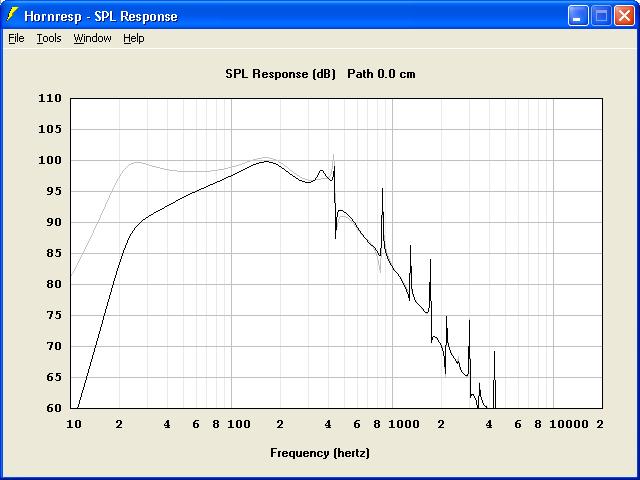

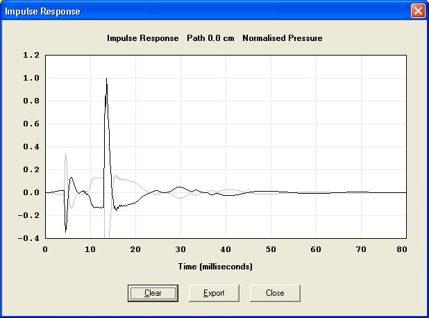

I have a little problem.
Generated impulse disagrees with hornresps SPL.
This happens for most reverse tapered TH (T-TQWT or what it's called) But to lesser degree for other as well.
Here is a picture of what I mean. The scale should be close enough.
I used HOLMImpulse to load the IR.
There are other differences as well when using normal TH.
More output below tuning, different behavior above passband.
The added bass below tuning does add up to observations that TH gives more output than predicted. But which is really accurate?
Difference is there regardless of pi. Although they seem to change a little differently.
Thanks again for adding the IR export. It has really helped to develop and analyze better and better designs.
I just tried this with a TH I'm fiddling with and got a similar result. Using Holmimpulse v. 1.2.1.2 (the latest crashes on me) and the latest Hornresp.
