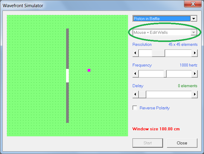

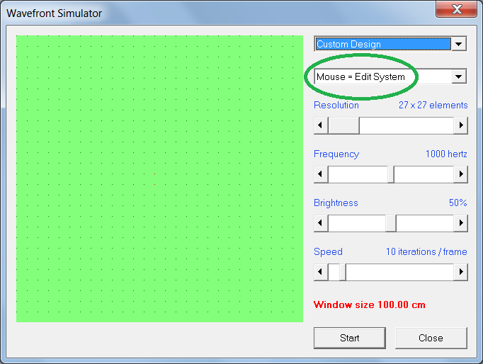

Hornresp Update 3970-160621
Hi Everyone,
The Wavefront Simulator tool has been further refined.

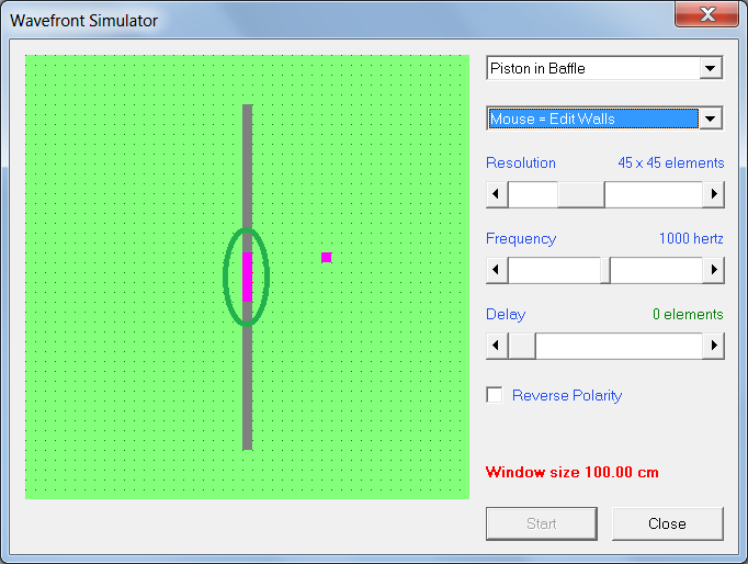

1. When the 'Piston in Baffle' option was selected and the mouse then Alt + clicked once to add a new (pink) source point, if the 'Clear Waves' option was then selected the original baffle piston source would turn pink - see Attachment 1.
This has now been fixed. When a source is only partly-specified the drop-down list containing the 'Clear Waves' option is now disabled, preventing the offending option from being selected - see Attachment 2.
2. The 'Mouse = Edit Wave' option has been removed because it served no real practical purpose, and the 'Mouse = Edit Walls' option has been changed to read 'Mouse = Edit System' - see Attachment 3.

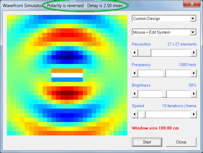

3. Moving the mouse pointer over a source now displays the selected polarity and/or delay settings in the caption bar at the top of the tool - see Attachment 4.

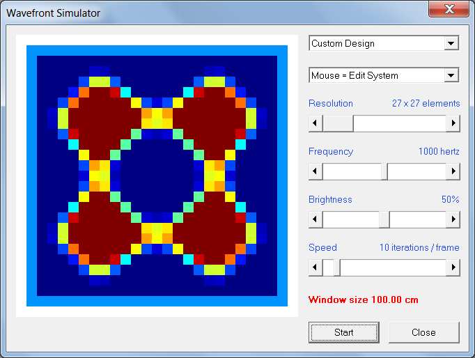

As an added bonus, the Wavefront Simulator tool can generate nice patchwork patterns :). See examples Attachments 5 and 6.

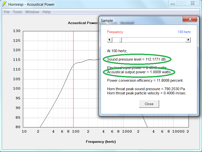

Hello,
Hornresp means to show acoustical power, while it does not. It shows SPL neither. It provides true absolute numbers only for direct radiators, while for horns it is off.
Let me first state important facts. Sound intensity is the power measure W/m^2 which translates into the amplitude measure SPL. An intensity of one Watt of sound going thru one square meter equals a sound pressure level of 12 Bel at any point of that area. For a driver in an infinite baffle, say half-sphere radiation, this 1 Watt of sound results in 112 Decibels at a distance of 1 Meter, because a half-sphere of 1 Meter radius has a surface area of 2Pi square meter. Our ears and most microphones detect not power but pressure, so we rather use SPL than sound intensity. If sound intensity say power is risen four-fold, "+6dB", then pressure say amplitude is doubled.
Now if in Hornresp i type in the Thiele-Small Parameters of a certain small driver (small enuf, that the microphone at a distance of 1 Meter is not in the DriverSize/Pi nearfield, where pressure and velocity are out of phase, and small enuf, that the driver does not beam) and use it in a sealed baffle (a horn as short as possible) in half-space radiation, then "acoustical power" prints SPL value at a distance of 1 Meter.
When i change radiation to quarter-sphere, then Hornresp tells me, that acoustical power would rise by 6 dB. This is wrong, because acoustic impedance and so efficiency have only doubled, say risen by 3 dB. SPL does rises by 6 dB, because +3 dB power go into a space, which has been halved, what accounts for another gain of 3 dB, and 3 dB + 3 dB = 6 dB.
But Hornresp does not just call SPL acoustical power, it does worse.
If i type in a big and strong exponential horn, which has a beamwidth of 50 degrees at 1 KHz, and also type in half-space radiation, then Hornresp plots me certain values of acoustical power. If i now change radiation to full space, then Hornresp does two things: At low frequencies, it reduces "acoustical power" output by 6dB. This is the behaviour discussed above.
But at 1 KHz, it reduces "acoustical power" output by 3dB. This is not like reality, where acoustical power is not reduced at all: At this frequency, the horn beams that much that does not "see" the halving of space, hence no change in acoustical impedance, no change in sound intensity, no change in SPL.
It would be fine, if this were fixed, because else Hornresp is a useful tool.

Hi Uli,
The Hornresp "Acoustical Power" response chart shows the constant directivity sound pressure produced at a point source normalised distance of one metre when the driver is supplied with a signal of a given voltage, versus frequency in hertz. The level is expressed in decibels relative to the standard reference sound pressure of 20 micropascals. The acoustical power output producing the constant directivity sound pressure is assumed to radiate uniformly into the solid angle specified by the Ang input parameter.
The Directivity Response tool can be used to take into account the frequency dependent directional characteristics of direct radiating single drivers and finite single-segment horns.
The above information is included in the Hornresp Help file under the "Acoustical Power" heading in the "Default Result Windows" section.
Hornresp assumes that the velocity of sound in air is 344 metres per second, and that the density of air is 1.205 kilograms per cubic metre, which means that 1 watt of acoustical power radiating into half-space produces a sound pressure level of 112.17 dB at a distance of 1 metre.
The relevant equations (for half-space radiation) are:
I = W / (2 * Pi * r ^ 2)
p = Sqrt(I * rho * c)
SPL = 20 Log10(p / pref)
Where:
I = sound intensity in watts / m^2
W = sound power = 1 watt
r = radius of hemisphere into which the sound power radiates = 1 metre
p = sound pressure in newtons / m^2 or pascals
rho = air density = 1.205 kilograms per cubic metre
c = sound velocity = 344 metres per second
pref = reference sound pressure = 2 * 10 ^ -5 pascals
If a copy of the Hornresp default record is taken and Ang changed to 2 x Pi and Eg changed to 7.69 volts, making the "resonances masked" acoustical power output at 100 hertz near enough to one watt, then the SPL is 112.17 dB, as expected - see attachment.
See the Hornresp Acoustical Power response chart explanation above.
See the reference to the Directivity Response tool in the Hornresp Acoustical Power response chart explanation above.
Sorry, it is not going to happen :).
The chart was originally titled "Constant Directivity", but the name was changed to "Acoustical Power" some time ago because that is the generally-accepted term used to describe such charts (Hornresp "Acoustical Power" and AkAbak "Acoustic Power" chart results are identical, for instance).

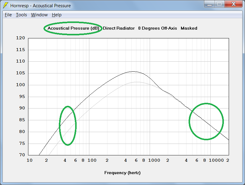

The attached screenprint compares the on-axis pressure response of a simple direct radiator loudspeaker radiating into 2 x Pi half-space (grey trace) to the on-axis pressure response of the same loudspeaker radiating into 1 x Pi quarter-space (black trace). At low frequencies the difference is 6 dB as expected, while at high frequencies there is no difference because of "beaming", also as expected.
