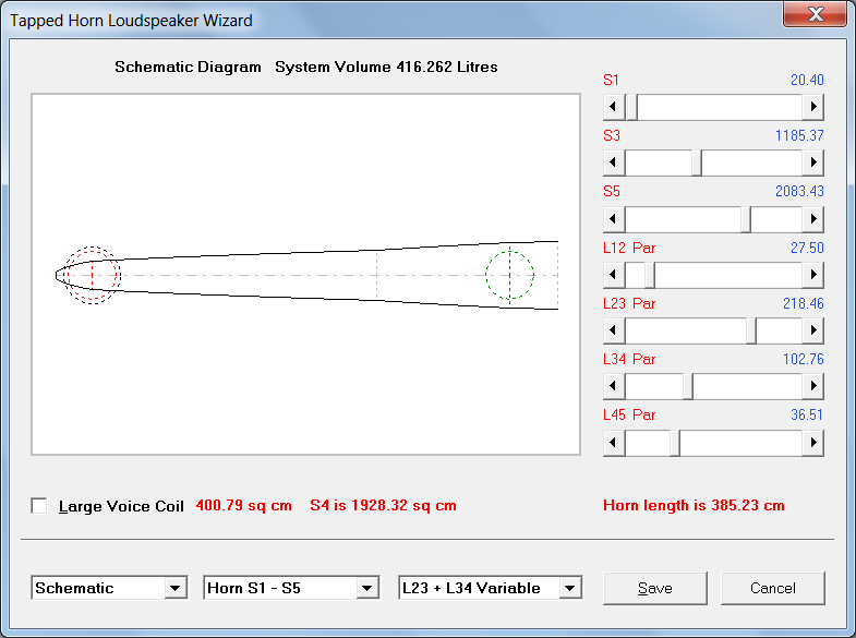

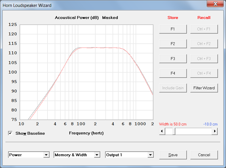

CHANGE 2
In the Loudspeaker Wizard, the constant width dimension of a direct radiator enclosure or rectangular horn having two parallel sides can now be altered while leaving the cross-sectional height dimensions unchanged, by using the Width slider control in the Memory & Width window.
Specify the initial width dimension using the Width slider and then double-click on the Width label to switch the slider to the width adjustment mode. Adjust the slider to vary the horn or enclosure width from the initial value. Double-click on the label to reset to the initial width.
Attachments 1 and 2 refer.
My thanks to 'zettairyouiki' for suggesting this feature.

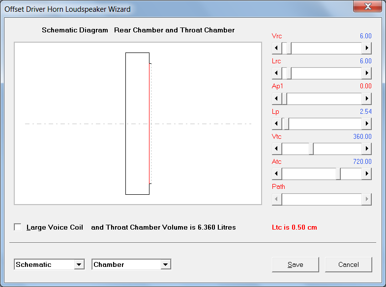

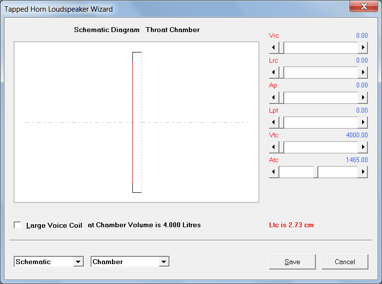

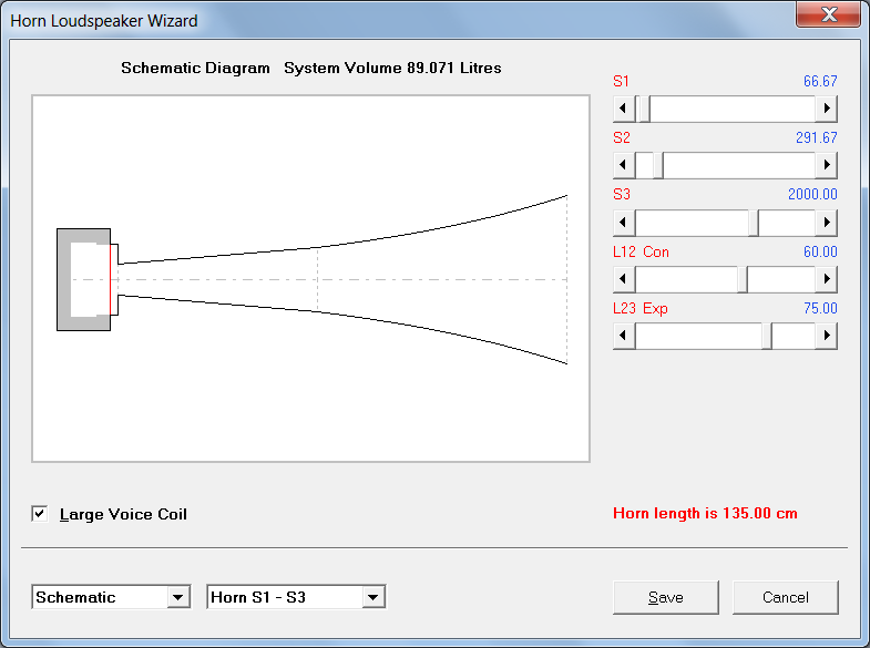

CHANGE 3
The empirical model developed by 'just a guy' to more accurately simulate the power response and diaphragm displacement of systems having drivers with large voice coils, has now been included as an option in the Loudspeaker Wizard. Click the Large Voice Coil check box on the schematic diagram window to select the option.
Attachment 3 refers.
My thanks to 'just a guy' for allowing the model to be included in Hornresp. A document produced by him describing the development and testing of the model, can be downloaded from the website below.

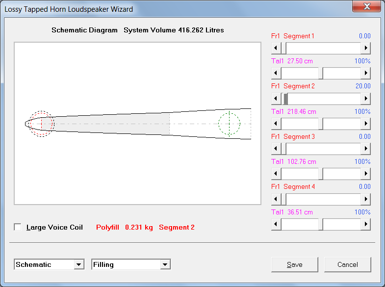

Hi Everyone,
I have already found a problem with the latest release :).
The location of the new Large Voice Coil check box means that it partially hides messages displayed beneath the schematic diagram. (I completely forgot that the messages were provided).
Not sure what to do about it yet.

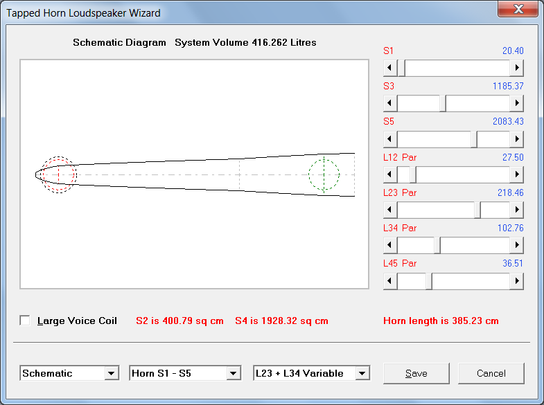

Hornresp Update 3940-150826
Hi Everyone,
The problem has now been fixed.
Kind regards,
David
