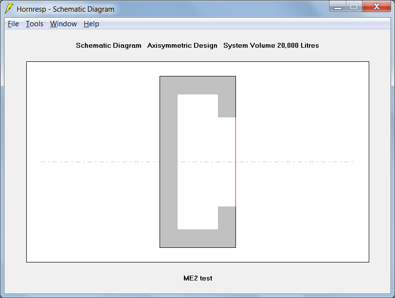

is that last pic showing 20litres, or 20000litres?
Hi Andrew,
The standard English (Australia) regional number setting has a period as the decimal separator, so that the value of 20.000 shown is 20 litres (specified to 3 decimal places to allow volumes to be indicated down to the nearest cubic centimetre).
If however the standard French (France) regional number setting (for example) was being used instead, the decimal separator would be a comma and 20 litres to three decimal places would be shown as 20,000 (as in the attached screenprint).
Kind regards,
David

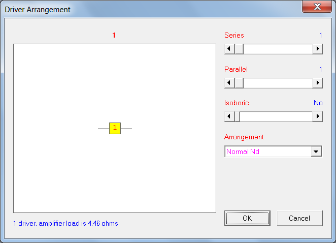

I noticed a similar bug to the one reported by just a guy in Post #5501, in the attached record:
Hi Oliver,
Thanks for this feedback. I can't be certain, but I suspect that the problem reported by just a guy is due to something a bit different.
For your example record, when the Driver Arrangement tool is selected and the OK button is then pressed without specifically selecting an option, you are specifying that the record be set to Nd (because in this case the record already happens to be at Nd). When a record is set to Nd using the Driver Arrangement tool the Fr and Tal settings are applied by default. This is intentional, not a bug. I can now see why this could perhaps be confusing though, and will change it in the next release :).
Thanks again for the feedback!
Kind regards,
David

Hi Oliver,
Kind regards,
David

It may very well be related to the Driver Arrangement tool, I've been in and out of that thing as I do the sims. I didn't correlate it though on my own, so this may or may not be the (only) cause.
All I know is that I set it to Apt/Lpt and at some point I open the wizard and that's when I notice it's not Apt/Lpt anymore. I have no idea when the actual change is made. I don't even notice it's changed until I open the wizard and see the schematic of a closed box. It's happened more than a few times, but definitely not EVERY time I open the wizard. So it may very well be the Driver Arrangement tool doing it. I haven't had time to play since I mentioned this, but I will try to keep all this in mind when I get back to simulating.

Hi David,
Thanks for looking into it. I was trying to duplicate just a guy's bug when I ran into this. Cannot remember seeing this before. I was starting w/ a vented box in Nd, so I didn't see much use in the program resetting to something else than Apt/Lpt (but, obviously when starting w/ a close box I would be looking for Fr/Tal). Basically, I would prefer the program leaving these entry designators alone. :)

As a first step, I will make the change I mentioned earlier to fix the Driver Arrangement tool issue identified by Oliver.
If you come across the Fr/Tal problem again following the change, could you please let me know. Thanks.

Hi Oliver,
Thanks for doing so - it has helped me greatly!
I agree that it is less confusing that way - see Mark, I really do learn from my mistakes :).
Note that in some cases the labels will still change automatically, where the existing settings are not applicable to the newly-selected arrangement. For example, if an Nd record has Ap and Lpt shown and the arrangement is changed to CH, the Ap and Lpt labels will switch to Ap1 and Lp because the compound horn system cannot have a vented rear chamber, but it can have a throat adaptor on horn 1.
