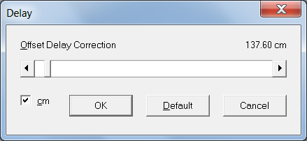

I'm not sure how Jeff's Excel-based software works, but I suspect that if nothing else, it assumes a direct radiator type loudspeaker. If so, then for a horn loudspeaker the Excel software phase response will never look like the 'SPL + Phase' phase response. (Rest assured, the Hornresp results are correct - they have been independently validated against two other programs).
You could try the following two tests if you wish, to see if the Excel and Hornresp results become any closer (after allowing for a possible arbitrary 90 degree or 180 degree starting-point offset difference between the two sets of results).
TEST 1. Rather than use the default delay correction specified by Hornresp, set the slider value to the actual time delay due to the horn length. For example, if the horn axial length is 137.60 cm, set the delay slider to 137.6 / 34400 * 1000 = 4.0 msec.
TEST 2. Simulate a direct radiator system rather than a horn system, in Hornresp.
Kind regards,
David
I forgot to add that you don't actually have to do the calculation - simply tick the 'cm' check box and set the slider to the required axial length (see attachment).

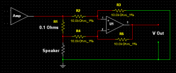

I know how to design and sim a circuit to do that, in several ways.
Hi Zero D,
I'm not sure that I understand - are you saying that you have a method for predicting the resistance of a voice coil Re at a given input voltage Eg?
If Re = 6 ohms when Eg = 0 volts, how would you go about calculating the value of Re when Eg = 100 volts, for example? As far as I can see, you would need to know the temperature of the voice coil when Eg = 100 volts, to be able to do that.
Kind regards,
David

@ David McBean
Here's my sim of an I = V converter. R1 samples a portion of the current through the speaker. The U1 output voltage is a scaled representation of the current through the speaker. For eg,
With R1 = 0.1 Ohms & Speaker = 10 Ohms, then 100 Volts RMS in = 1.982 Volts RMS Out. This is double what some might expect via the 0.1/10 ratio, but it's due to the circuit having a gain of two. If required the output could be halved to match the "expected" result.
Scaling R1 and/or Speaker Re up/down will give appropriate results.
If Re was a simulation of a Real speaker, then as I varies so will Re. Therefore the relationship between I/R could be derived by an ohms law calculation.
There is another way to sample I if you're interested.
All the above is just an idea for inclusion, which might not able to be transferable into HR ?
I welcome input from others who wish to help :)

That sim calculation doesn't take into account thermal cooling provided by the real action of a real driver, which will vary depending on the design. The only accurate means I know of without adding additional issues is via non contact. An optical thermopile can achieve this, but then it's an issue of actually seeing the VC in action. This is impossible in most cases without driver modification.
@ David McBeanIf Re was a simulation of a Real speaker, then as I varies so will Re. Therefore the relationship between I/R could be derived by an ohms law calculation.
The problem is that the I/R relationship will be different for every single driver. Sometimes dramatically different. This is what David and Mark have been saying here and it's what several people said the last time this was brought up.
Consider a cheap driver with small gauge voice coil wire and no cooling anywhere in the motor compared to a state of the art pro driver where cooling is a top design goal. How are you going to account for that? A formula can never do that without a bunch of input about the actual driver.
As I mentioned months ago you have options to do this manually. Most people just raise Re (or add Rg) to simulate heat, or you can measure the t/s parameters of your drivers when hot and use those t/s for the sim.
