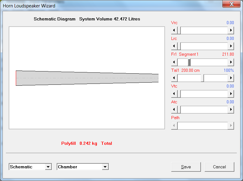

There seems to be a serious bug in Product Number 3420-140312. I lost FR in the TH mode, also there is no FR under Chamber. I immediately tried to go back to 3420-140310, but it still does not work (I guess once you update it changes the .dat file?). FR is there in Nd and OD, but in the Wizard/Chamber only if first set up in the Input screen.
Hi Oliver,
You might like to re-read the second paragraph under the "CHANGE 2" heading in my Post #4227, on how to invoke the absorbent material option :).
You will see that selecting Fr on the main input parameters screen is no longer a prerequisite for having absorbent material, which is why Fr and Tal have been automatically removed from any tapped horn records where they were previously specified. A tapped horn can only have Ap1 and Lpt because there is no rear chamber. Originally Fr could not be specified in a tapped horn, and I wanted to return to that arrangement because it is less confusing in my view.
I think you will find that the latest release works just fine :).

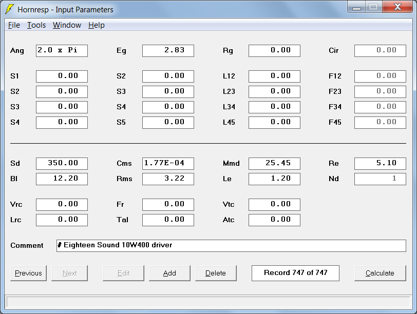

Another way is to retain the driver reference records in the main data file, but to have the comment fields start with # and include make, model, etc. If the records are sorted, all the drivers will end up at the beginning of the file. Even if not sorted, the driver reference records can be easily found by searching on # using the File > Find tool.
File > Copy Driver (Ctrl+C) can be used to copy the driver parameters from a reference record, and File > Paste Driver (Ctrl+V) can be used to insert the copied parameters into a different record (in Edit mode).
An example of a driver reference record is attached.

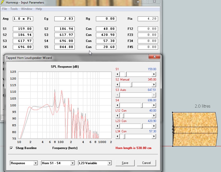

You do still know that I did a tapped horn with the infinity, advise was to use cone correction because the woofer give more cm2 at the cone area.
Some say it is not needed and so i did try it today, I did make S2 bigger put 158.74 cm2 from speaker into S2, and yes it give a different response.
So I conclude that when magnet is faced to mouth we need cone correction.
Gray line is with correction, red without.
Regards
kees

Hi David
Regards
kees
Hi Kees,
Thanks for the feedback.
Kind regards,
David

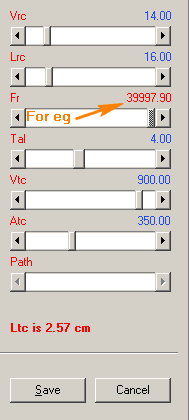

Hi, in the Hlp file under LOUDSPEAKER MODELS i don't see any mention of a Transmission Line or how to create them ?
Also whilst attemtping to decrease/increase items with Large numbers associated with them, it takes an age to do this. I tried right/left clicking on various things to try and enter the amounts manually, to no avail ! Maybe i've overlooked something/s ? Please see my screenie.

I expected that just by clicking in the white space would allow me to instantly input & alter the numbers, as in other soft, but Enter as well is required. Duh, shoulda tried that ! OK, Thanx :)
