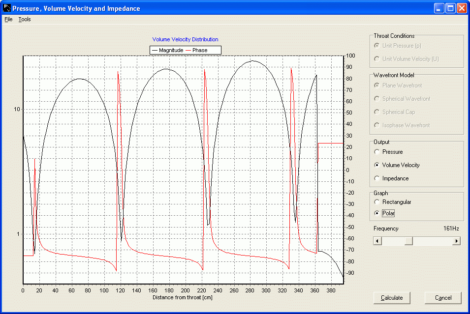

iand said:
This isn't so easy since Hornresp can't plot the pressure and velocity profiles along the horn at a given frequency, though the program must know this -
Hornresp knows the pressure and velocity values at S1, S2, S3, S4 and S5 (if in use). Plotting the distribution along the horn is something different...
I can't resist attaching a screenshot of how such a plot would look like in polar coordinates :) The discontinueties at 15 and 365 cm are the points where the driver enters the horn.
Bjørn
